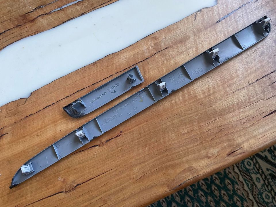

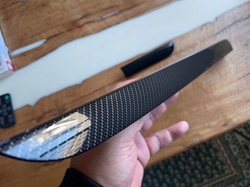

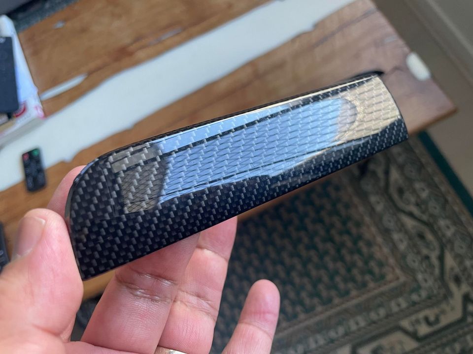

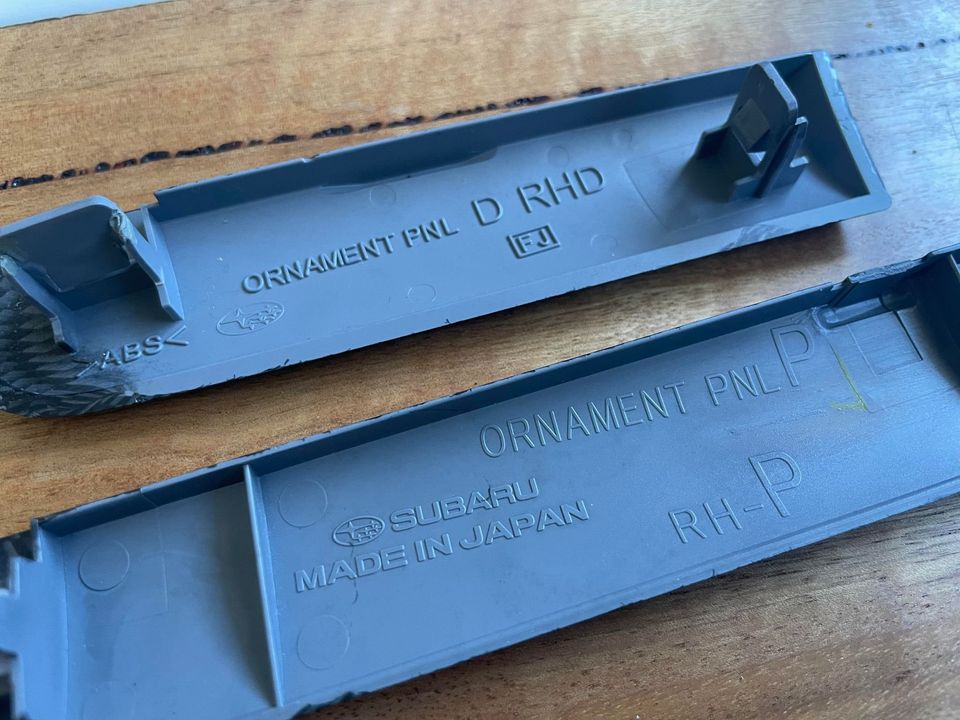

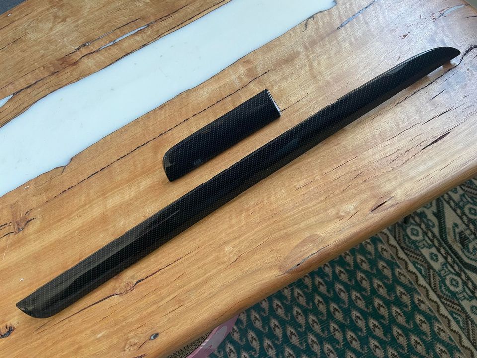

hey mate these are the dash trim pieces i was talking about in the levorg thread. these are genuine subaru pieces from a 2018 STI. Mint condition. I bought them assuming they would be the same as the levorg but unlike almost everything else that fits betweent the two models, the levorg has a different shaped dash trim than the VA WRX & STI.
Not sure if you'd be interested but they're avaialble and for sale of you are..
The rest of the carbon trims i have are Axis-Parts which i bought from Japanparts. Check out the range here: https://www.japanpar...&ma_kwd=&manu=1
Thanks for first dibs bro but I have those ones. Cheers for the link, I'll check out the Axis range.

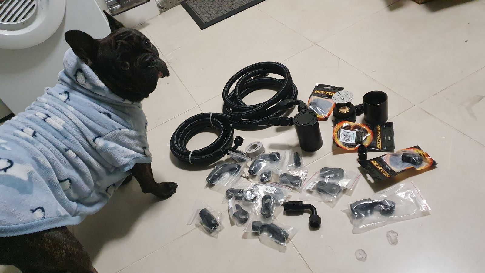

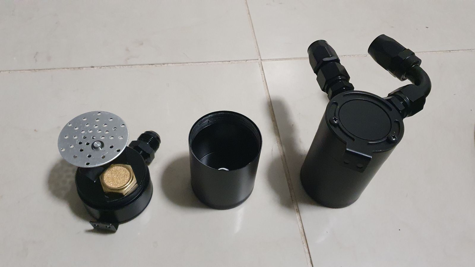

For a while I've been tossing up between the options of an Air oil separator and dual catch cans. It’s a result of being on the American FA20 forums and groups. I’ve become a little paranoid thanks to our American friends and their issues, there's constant chit chat about having to walnut blast the intakes & valves because of carbon build up on these DIT engines. That sounds like a massive pain in the arse to me and not something I’d want to attempt at home. It’s funny because every time someone posts an issue with the way their car is running on the American forums, heaps of people jump on saying “Have you walnut blasted your intake”, acting like it’s the miracle cure to all problems. I really haven't heard much in Australian circles though and I’m thinking it possibly has something to do with the Yanks using E fuel more and it’s not such a big issue here because the majority uses 98 ron.
Nevertheless, when I changed my turbo inlet over to the Aluminium COBB inlet there was a little bit of blow-by. Not heaps by any means, but I've opted to do something about it and go the catch can route for a couple of reasons. The decision to go with a twin catch can set up over the AOS (besides the ridiculous price tag of the AOS units) was made easy by a video comparison I watched between the two set ups. What I saw being collected by the AOS was a contaminated brown milky liquid comprised of fuel, oil and water… and that gets fed right back in to mix with the sump oil. No thanks, it makes no sense to me.
Catch cans obviously need to be monitored on an ongoing basis and emptied when required, but that’s no biggie in my opinion and not much of a Con.
As much as I like the look of the Radium Dual catch can set up for the VA WRX, I just can't bring myself to pay the ridiculous price they go for. I'm sure they are a good bit of kit and the installation process is quite simple, but for about a ¼ of the price I picked up similar sized ebay spec catch cans, braided hose and all the AN fittings I needed to put together my own custom version of the Radium can set up. The only thing I’ll need to do is fabricate a bracket to hold the cans in place and to mount them in the same position as radium do. (on the LH side of the engine bay near the air box). I was pleasantly surprised with the quality of the Ebay cans, I’m confident they’ll do the job once I source a larger O ring. The ones provided are a bit small and I’d rather go larger for a better seal. Chances are, these generic cans are probably made in the same Chinese factory as the expensive ones anyway. I guess I’ll find out soon enough if they’re up to the task.
All the parts I need, hopefully.
