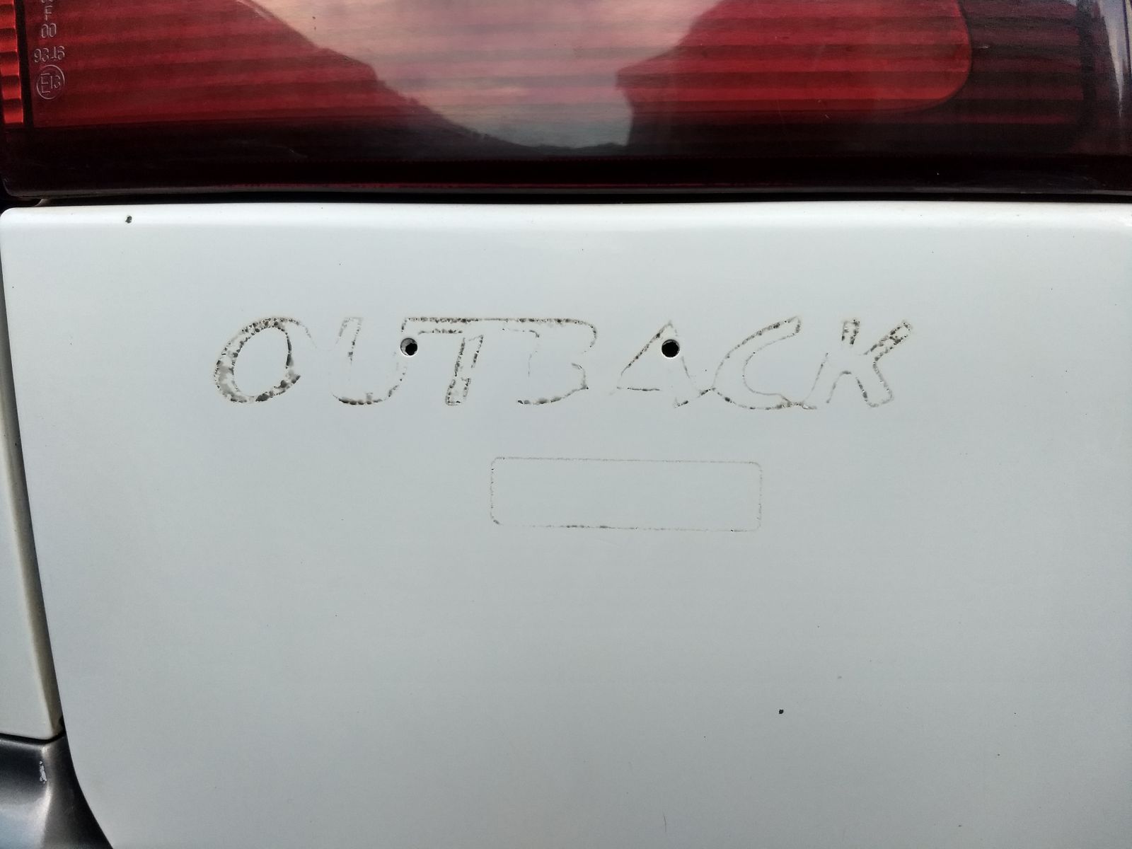

Thought I;d re-use an old thread here.. Has anyone ever had issues with the paint chipping off around the outline of a badge? Took mine off this arvo, braided fishing line and metho on a rag. Didn't rub too hard with the rag but the old tape and adhesive just picked bits of paint off too.
I tried some Autoglym super resin polish stuff I had lying around, anyone have any better ideas or experience with fixing these tiny chips? (that doesn't require a whole paint match spray pack and full sanding smooth..). I can't really see a way to get rid of these marks without some fine wet and dry sanding and lots of polishing.
There is still a fair bit of super hard adhesive on there, but a fair few chips too.
I doubt the new gen4 badges will cover this up.. Cheers

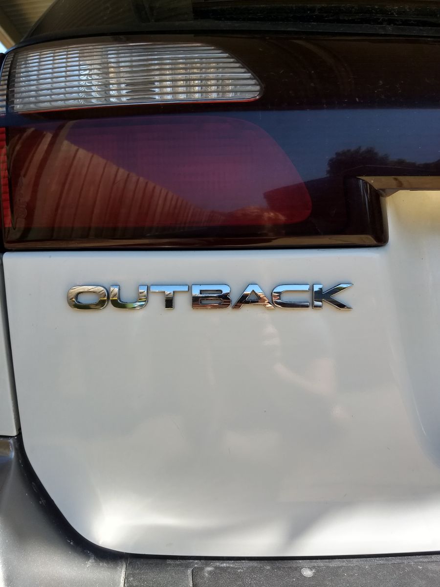

well for anyone with an outback with the colour code 1N1, Duplicolour DSSB05 is a perfect match for colour. I gave it all a sand with some 800 wet and dry, not through too much so i didnt have to use primer. Came up pretty good, except that cutting the double sided tape to stick the letters on is a pita.. Next time I'll just buy a genuine replacement93073AG020 )
