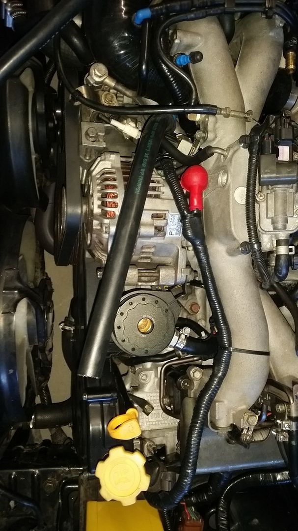

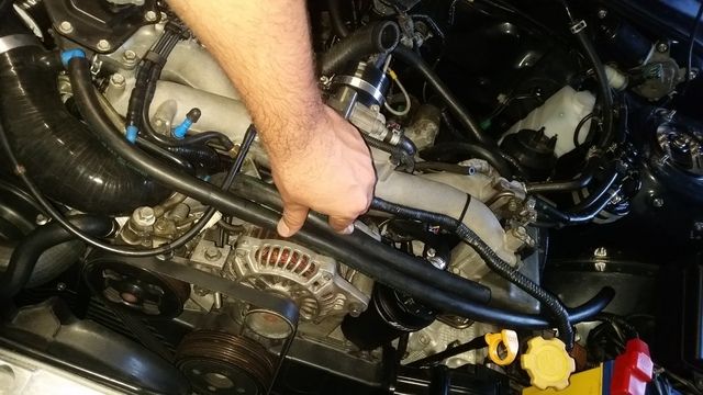

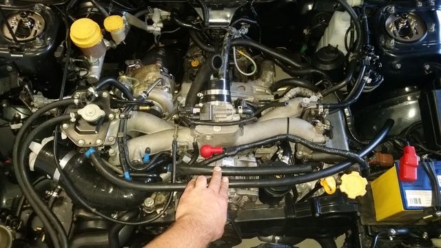

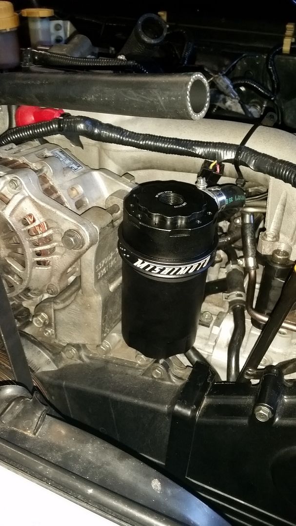

While i was out dropping all the bits off for powder coating i took a drive to pro speed to have a talk to Troy and grab another set of camber bolts for the rear end, as ive found that doing all the adjustment on the control arms can end up with differing track on each side..like 10mm in some cases :/..i checked and nothings bent....just slightly out? The hubs might not be in the exact same position as theres a bit of slop in the bolt holes
But the bolts should fix it ;)
And whilst i was there i spotted a perfect little catch can (yes another catch can change lol) to do something I've wanted to do for a while....ie run 2 cans...one for the crankcase and one for the heads
So in enters the mishimoto baffled air/oil separator...very tidy, very black and looks like it will catch and seperate plenty of oil
I'm going to run it where the air con was and only filtering the crank....and the heads will go to the newly powdercoated hyperflow 4 port...which ill turn into a 3 port with 2 in, one out.
So each head will go separately to the can and with longer hoses it'll help losing oil straight into the can on high g corners as happens a lot with our cars unfortunately.
I think it'll look fairly neat with all the other hoses now hidden behind or under the manifold...and only the two return hoses going over the alternator etc
And more importantly it will split the heads away from the crank which is as Subaru intended it
Just got to redo a bracket for the pcv can and make make up one for the hyperflow once i get it back

Posted 27 April 2015 - 03:33 PM
This is the new can...just waiting on a banjo fitting for the top hole as the original points straight up

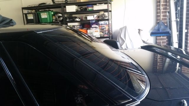

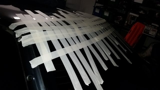

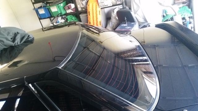

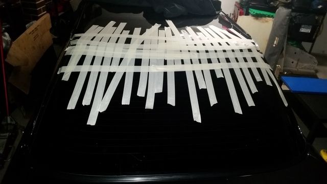

Got tape?
In pulling the trims off for the vinyl wrap and later paint...i disturbed some of the rear window seal and it dripped a few drops off water into the car
So off it came again and cleaned it up and resealed with some windscreen sealant and put the trim back on
Trim clips are all screwed and never wanted to reset into the holes...so i trimmed them and they are held on via the sealant surroundng the molested clips ;)
Tape is to keep it all flush till it sets and stop it bowing or something stoopid

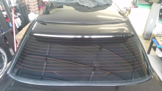

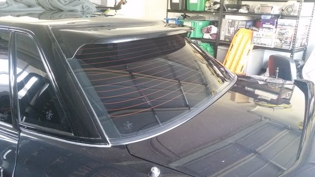

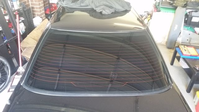

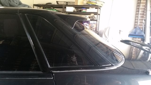

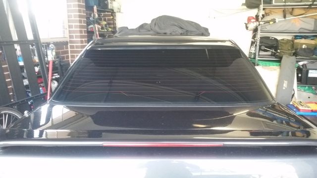

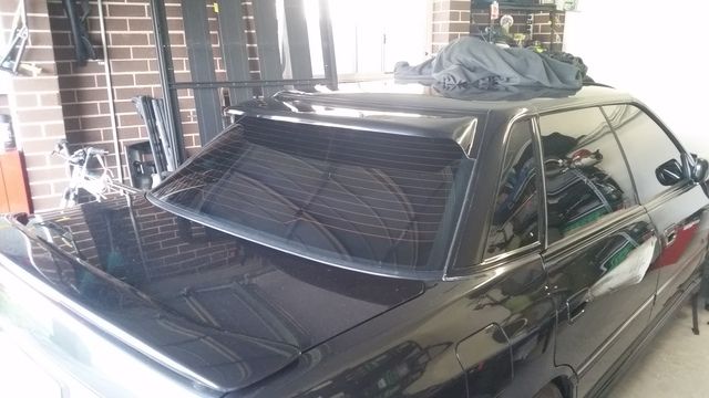

Posted 28 April 2015 - 03:21 PM
Whos ready for more babble?
Another day off work today...love my 7 day fortnight!
So a few more bits removed from the list
Figured out how to adjust the rear windows as they were leaking a touch as they were way out of alignment....bit of sideways...but of heights..little bit of tilt and they are perfect! Will test with a hose later on. ..no pics because boring...but i may diy that shizz later as its handy to know ;)

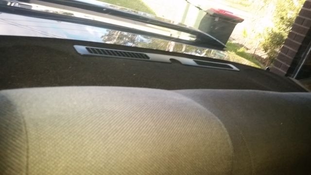

Also got the rear parcel shelf fitted now the tints complete...tidy fit and looks much better than the metal lol..bit of a divet where the speaker holes are...but im not fussed...if it bothers me later ill just get some basic no name speaker covers and put them over the holes

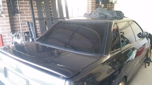

Annndd dug in and got the rear window spoiler i got off Mark (scubaroo) ftted
Required lots of cleaning as it was layered with lots of horrible adhesive, silastic and god knows what...and had a heap of overspray on it from a previous owner
So cleaned, scraped and polished it....wiped it and the window down with wax and grease remover...fitted some body moulding 3M tape and on she went
LOOKS AWESOME!
Before
After
Sitting here looking at the rear end of the car....and it now looks perfect...minus the plastidip im yet to peel of the rear garnish and the lack of blacked out muffler
thanks for coming :)

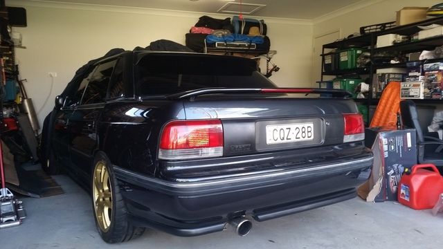

#599 Matt
Matt
  • 4380 posts
  • Location:Lake Maquarie NSW
Posted 28 April 2015 - 05:18 PM
Yeah now its on i cant believe how incomplete and naked the rear window to roof line looked lol
and black rims will be much much later when i could be bothered to peel the tread off and be without the car for a week or two...so definitely not before HVC
Will be powdercoated..maybe a satin?
But they look good with the gold brembos behind them i reckon
