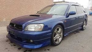

I've been lurking forums for ages trying to find an answer to this problem, but I have finally decided to try and get to the bottom of it myself. I bought my '00 JDM Legacy GT-B (BH5 with the EJ206) about a month ago, and I've been chasing this issue ever since.
Basically, the car keeps throwing Code 24 (IACV malfunction) along with a check engine light. When it does this, revs sit at around 1400 and the ECU cuts fuel to cyl#1 causing the car to run on 3 cylinders. If I shut off the car, it usually "clears" the CEL and it will no longer be running in limp mode. Although the condition will return, uusually when the car is in park and the revs return to idle. However, I noticed the condition also goes away when the A/C compressor kicks in. Basically I can clear limp mode and the CEL just by cycling my A/C on and off.
