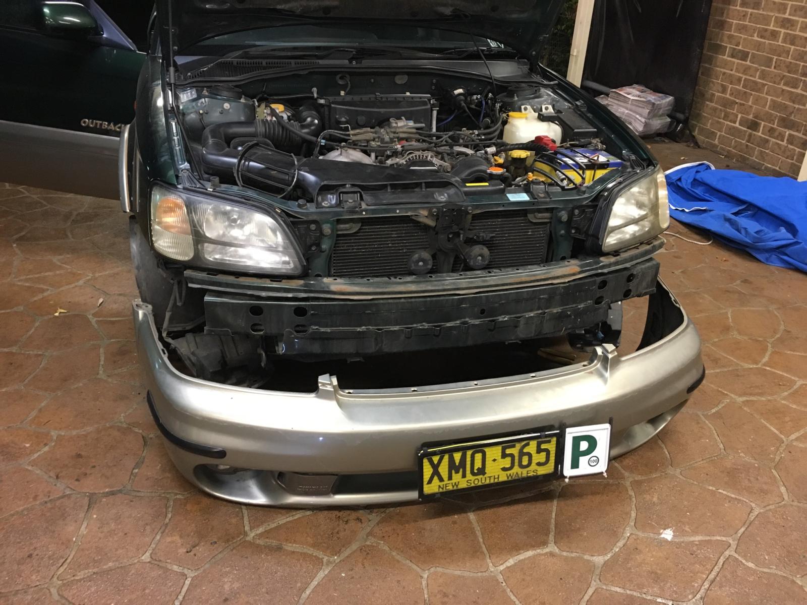

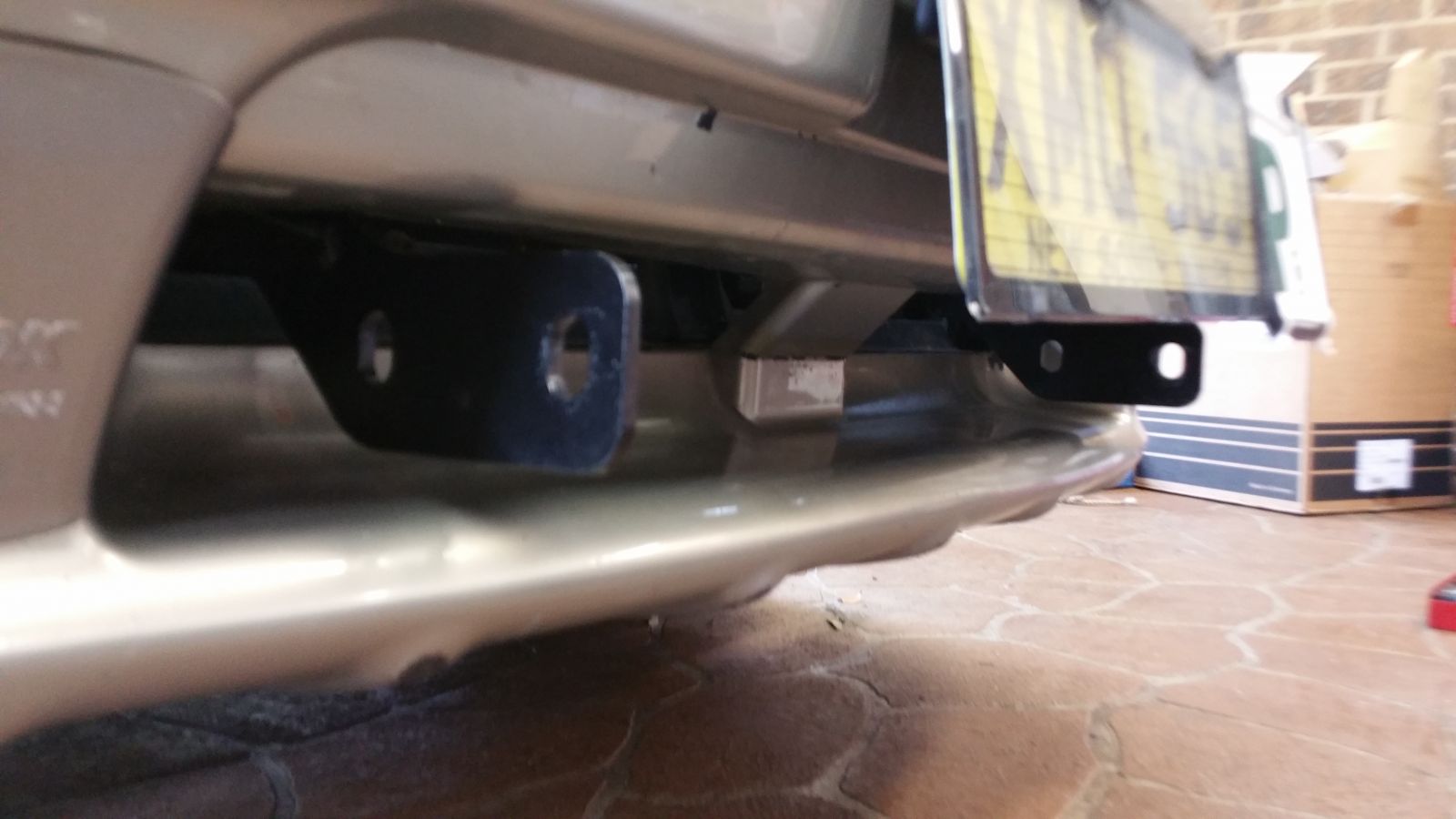

First i took the plastic bumper off
20

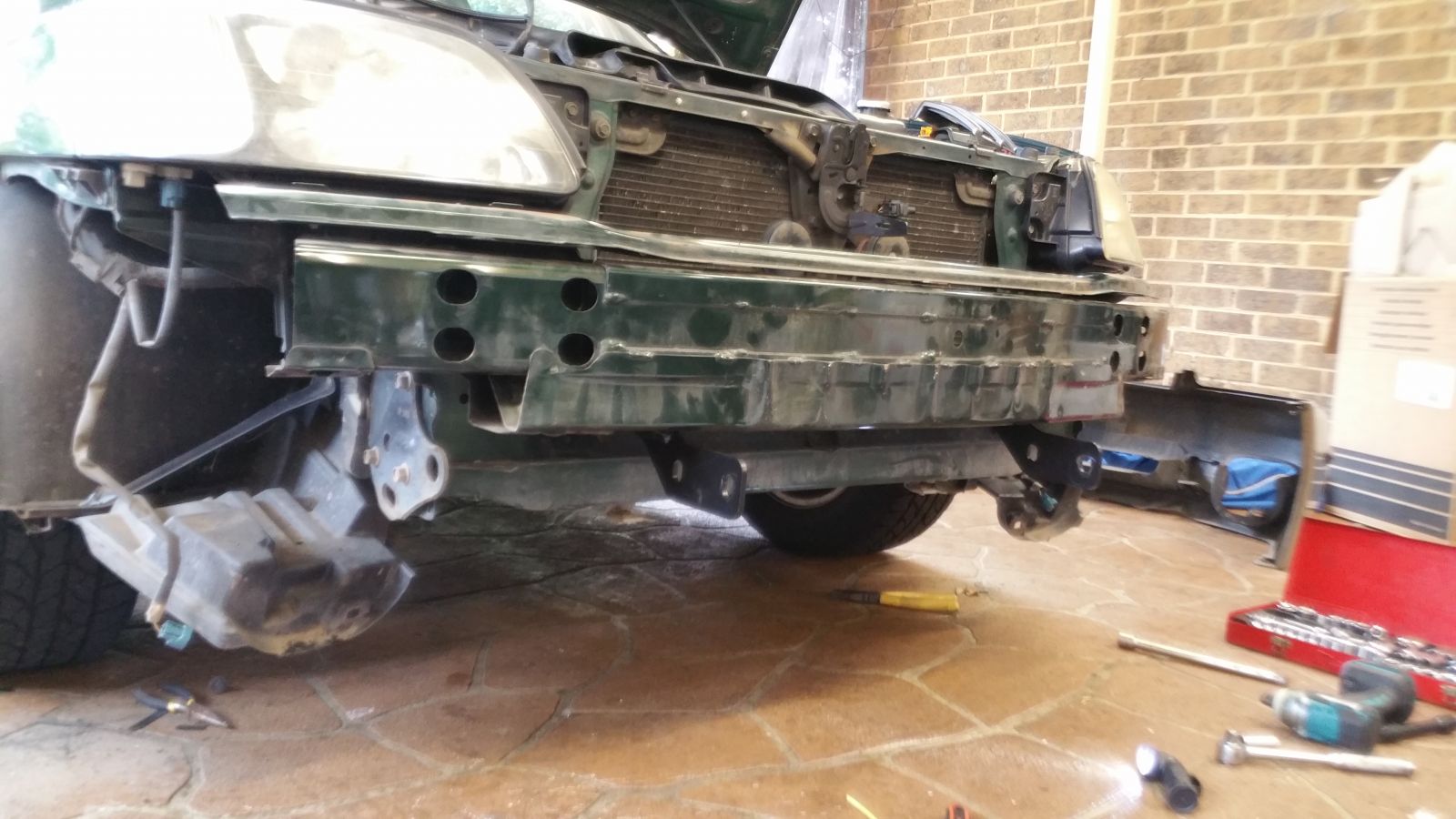

Then i had to remove the bumper support bar because the brackets go behind that
18
I forgot to take photos of how they attach but once i got that off i put the brackets on and then put the bumper bar back on over the top of it.
Then i put the plastic bumper back on and then hoped i remembered where all the plastic clips went haha.

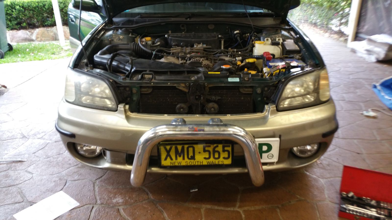

This is what it looked like after the brackets were installed
22

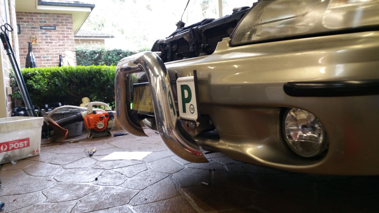

Once that was all done i attempted to put the nudge bar onto the brackets.
aaand success!
25
23
28

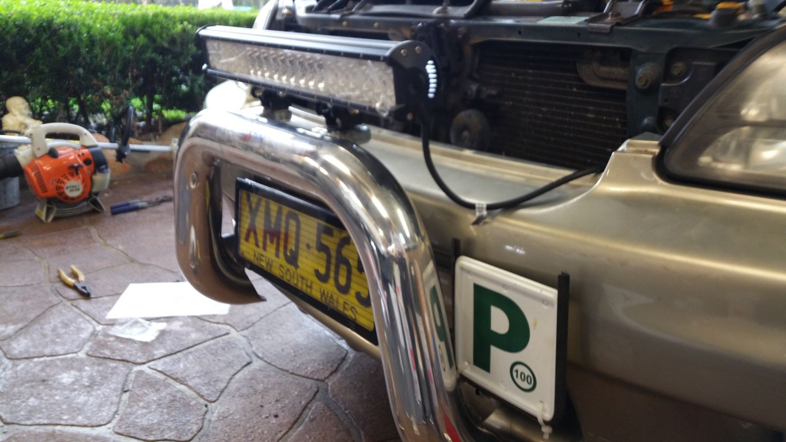

I also test fitted the led light bar too and figured out i may need to make my own bracket so it sits closer to the nudgebar.
27
26
I also found out when i went out later that night that my dad was bored and ran the wires through the firewall for the light bar. So that's one less thing i have to do now
I got an oem fog light switch that i'm going to use for the light bar and i have made a sticker that i'm going to stick on the front of the switch.

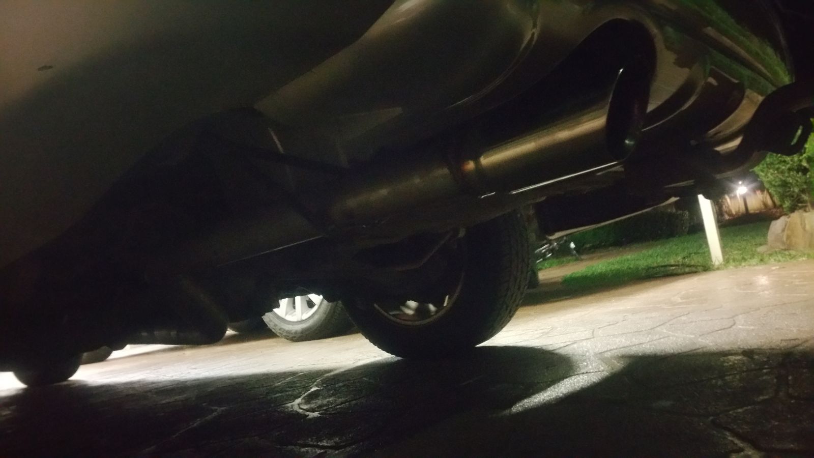

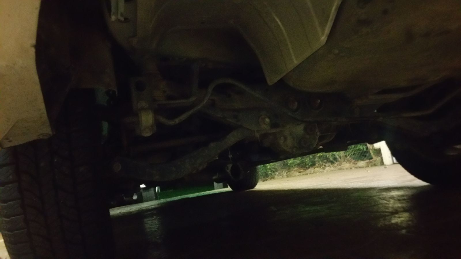

I got bored one night and decided to take my rear muffler off to see what it sounded like.
I was surprised to hear it sounded alright and wasn't that loud, fairly crackly obviously with there being no muffler.
29
30
So my options were:
1. Get a new diff back muffler welded together by my local exhaust shop.
2. Get a straight pipe diff back  welded together by my local exhaust shop.
For the giggles i went with the straight pipe. I will get a muffler in the future because long distance driving will probably kill me but for now i'm having a bit of fun haha.
32
33

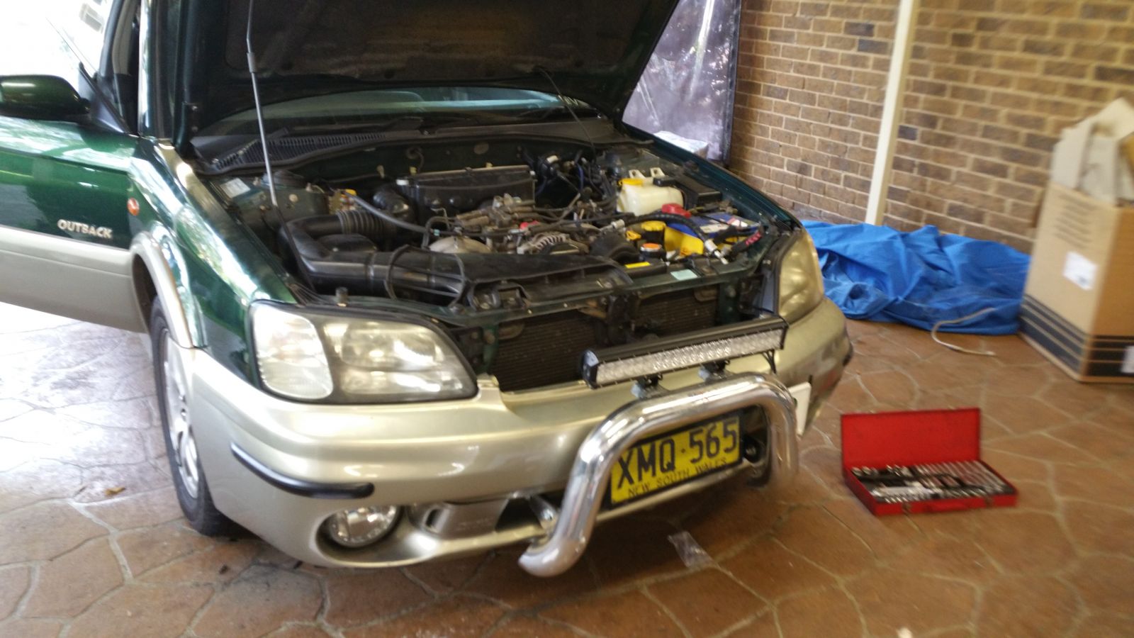

Moving forward a couple of weeks i then decided to put my lightbar on properly
I wasn't happy with the way it was sitting when i first put it on so i drove to bunnings and bought a piece of aluminium. I cut and drilled holes to try and lower the lightbar down below the stock mount points on the nudgebar and now it is exactly where i wanted it.
It doesn't shake as much as i thought it would when driving which is what i was worried about because the aluminium is fairly thin.
