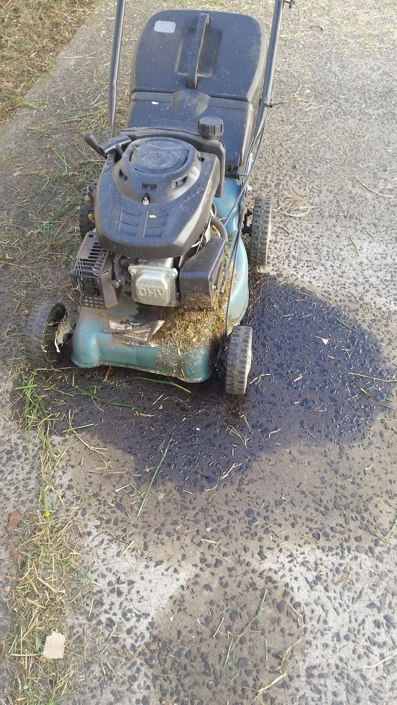

The moment you realise, EVERYTHING you own is a massive piece of shit...
Nearly threw the cubt onto the road into oncoming traffic.
I wish it was TT so it had less problems
94ef7f1d-cbb2-4ecf-9960-2ed636c3a2c2_zps

Forkin thing just pisses all the fuel out the carby. Cannot for the life of me figure out why. As soon as you fill the tank, its leaking like a sieve.
God forbid it stalls out as its a total cubt to start again. I have to put it on its side so it doesnt piss out fuel, just to start it again.
Fuel line is fine. I have nfi how to adjust this carb bullshit. Is there any way to fork with something to adjust the fuel that goes into the carb?

Normally the carby is just a simple diaphragm thing. Must be a forked seal or something.

Probably The fuel bowl

Did you hose 10 mod it Jimbo, that's probs the problems.

Might be a suck needle or crook float Jimbo.
If so, carby has no way to control fuel level in the bowl.
