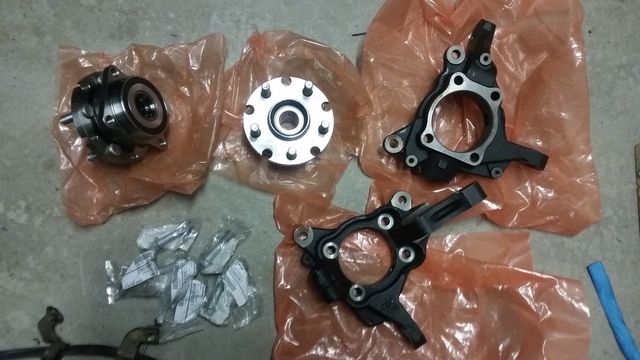

Brand new 6 Gun 05+ STi front knuckles and bolt in hubs modified to suit early struts, and hubs drilled and trimmed to suit 5x100 rims :)
These things are god damn solid!!! The bearings are huuugggeeeee!

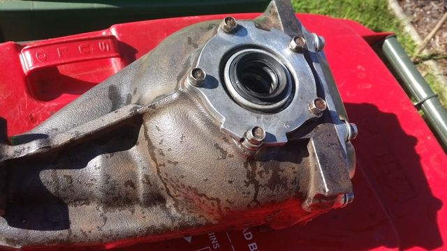

So spark breakdown issues and the fix aside, not much has been done, aside from cleaning up the R180 rear end bit by bit before install...with all new axle seals and rear cover gasket installed on diff....shafts stripped, cleaned and waiting for rebuild....hubs had brake dust covers removed and are waiting to be refurbished asap. Lots of surface rust removed...lots lol

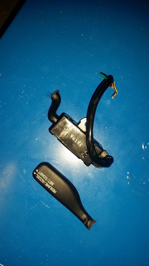

Also got sick and tired of bumping the cruise stalk that has no use anymore...so tore it out and chucked it in the bin...mucho better!

Hey Matt, how much did the new front hubs and knuckles set you back? I'm interested in doing something similar to my lib.
#899 Matt
Matt
  • 4,380 posts
  • Location:Lake Maquarie NSW
Posted 17 June 2015 - 07:27 PM
As in the 05 sti ones?
They were $1000...they are second hand, but never used...cost the dude well over $2000 a few years back
You need the alloy rings that move the abs tone rings in more to suit them aswell
6 gun is no longer in business...but lic over in the us does them aswell
The gd ones i got in atm were $195each though...refurbed and fresh bearings
If you want the normal gd wrx hubs in a month or so theyll be up for sale ;)
But if you get the LIC ones, i have the rings and dont need them (no abs ;)) so hit me up

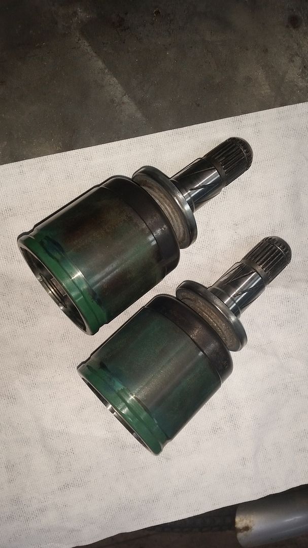

Are the R160 Axles/CV's the same diameter on the spline? Basically I'm asking will my R160 axles bolt up into these, or will I need to source some R180 CV's to go onto the 160 axles? (If such a product exists)
I suspect they won't, but at this stage I'm looking at moving into R180 gear anyways. Sorry for the questions, just want to make sure I understand what is required before I go bolting them in and things not fitting correctly. If I know beforehand, it means I can arrange the parts before wasting time trying to bolt it all up and things not going to plan.
