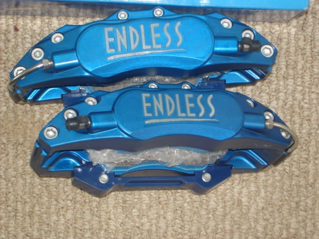

Id love to fit Brembo's (already had a complete set ready to go) but dont want to change my wheels and these will fit.
Forgive my ignorance Mark, but these look like Brembo calipers so how do they fit where Brembo's don't?
Is it because they run on a smaller rotor?

Looks like they're a one size fits all type caliper with adapter brackets bolted to them specifically to fit 294mm rotors. Versus an OEM Brembo with the mounting points cast into the rear caliper housing.

Theyre an Endless caliper. Just have Tommy Kaira on them instead of Endless. Thinner rotor and thinner caliper means less wheel clearance required.
6 pot Brembo's utilise a radial mount design also. ;)

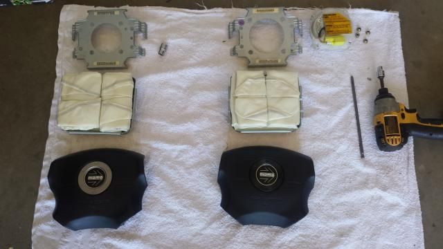

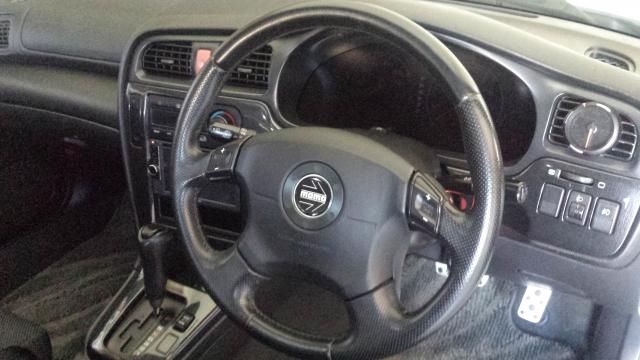

Steering wheel arrived so I could swap my horn pad to a black momo centre - personal preference, and I could replace the plastic trim that had the cruise control buttons on it.
Had no airbag module fitted and the airbag module was larger on mine so wasnt a straight swap. I had to do a complete strip down to swap just the horn pad.
No more cruise buttons.

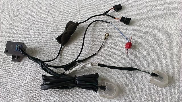

Picked this up, just some more unique JDM touches. :)
JDM Gen3 OEM option footwell light kit. 100% complete, plug and play.

Bulbs have green covers on them standard but im probably going red, maybe white LED.

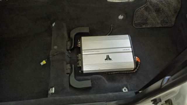

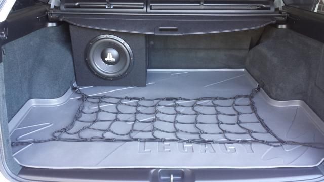

Finally finished off the stereo with amp install and sub.
Amp powers front splits and sub, rear fill from the hu. All JL Audio components and I'm very happy with the SQ.
Picked up some oem duct extensions also to go around the amp.
On a side note, the carpet in this car is amazing. Not a wear mark or stain on it.:)

Hmmm if you're using the e4300 amp, and still using the ducts, I should be able to use my ducts with the hd900/5
