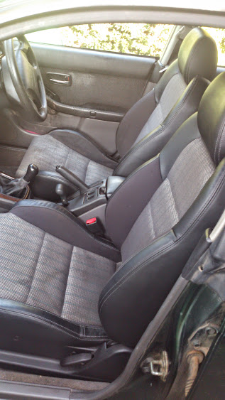

Posted 24 May 2015 - 09:44 AM
Sam's GTB/RSK seats went in this morning.
Diagnosed the dead electric rail last night in the driver's seat.. there's a single motor driving a worm gear directly on one rail, and via a flexible drive shaft, another worm gear on the other side. The flexi-side worm gear was stripped.
Did a bit of googling last night and couldn't find any references to any spares for electric seats, so figured my chances of finding new spares (not 'almost about to die the same death' used parts) was pretty slim. I'm not so keen on power seats anyway - they tend to break.
No worries, 'I'll just pop the seat onto my manual rails' he said.
It turned out not to be so simple, but not impossible, either. The power seat is different from the rails through to the steel seat tub. The tub differs in the cloth-clip rails underneath to clear the power gubbins versus the manual.. so the power tub won't fit on the manual rails and mechanism. I had to remove the cover and foam from the power seat and put onto the manual tub. The tub shape is fortunately the same.
Similar problems with the backrest mechanism - the power seat mech just unbolts, while the manual one is riveted, or circlipped on. I couldn't see the obvious way it would come apart. So I had to partially remove the backrest cover to be able to get to the two bolts on the driver's side pivot mechanism and then bolt that onto the manual one. Good thing I did, also found a busted bolster spring attachment point (cable tie fix FTW).
They're much more enveloping, and look the sex. Don't obviously mismatch the rear standard cloth seats, either.
Before and After...
#291 Guest_KONG_*
Posted 24 May 2015 - 10:21 AM
Wow, a lot of work but the end result is heaps better.
These are the most comfortable Suby seats I've tried.

#294 zahmad
zahmad
  • 967 posts
Posted 24 May 2015 - 01:18 PM
Good on you for putting in the effort, Sam messaged me to see if I was interested by I didn't have the time or energy to try fixing them...
#295 Samwise
Posted 24 May 2015 - 01:19 PM
Looks better ;)
I may be biased there haha.
Yeah the electrics weigh heaps!

#299 Samwise
Posted 25 May 2015 - 04:15 AM
NSW spelling ???
Beer spelling*
