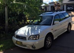

I bought my first Subaru about a month ago! It's a 2002 Outback 3.0 Australian model. However, there are a couple issues that I have been trying to track down.
