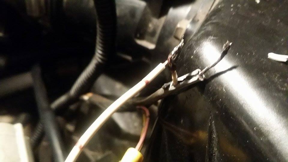

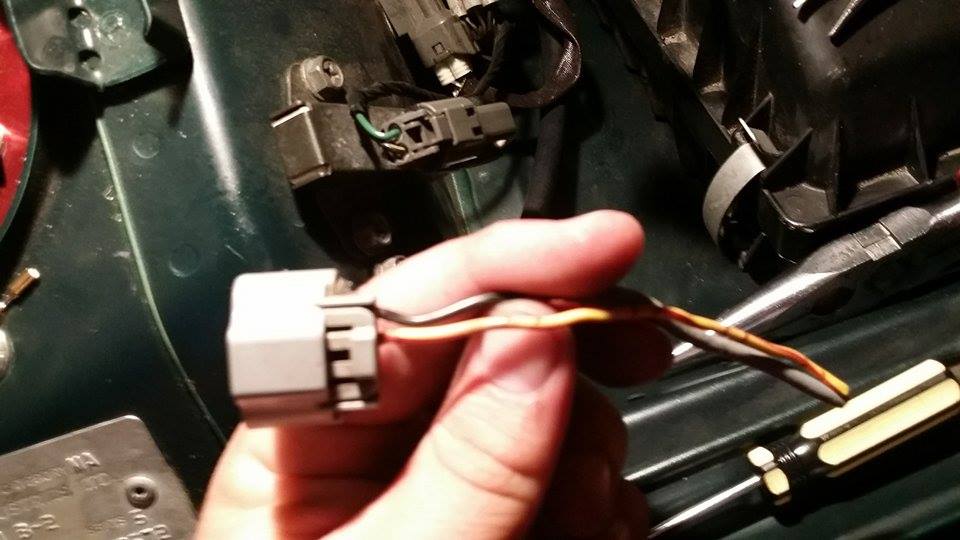

so this broke away three times on the way home today explains why i was surging and all the problems ive been having on idle since nov lol it finally broke in my hand tonight while i was checking it
sooo on a mission to get my car fixed for work tomorrow smile emoticon

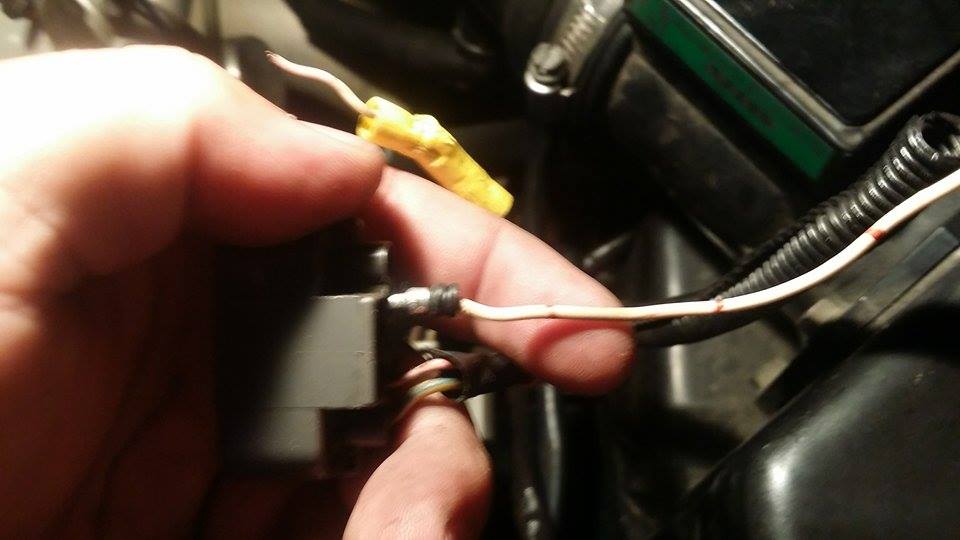

11057005 10152819475525369 418342433 N

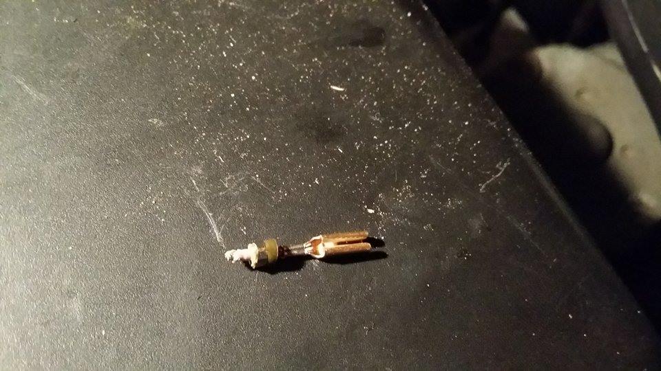

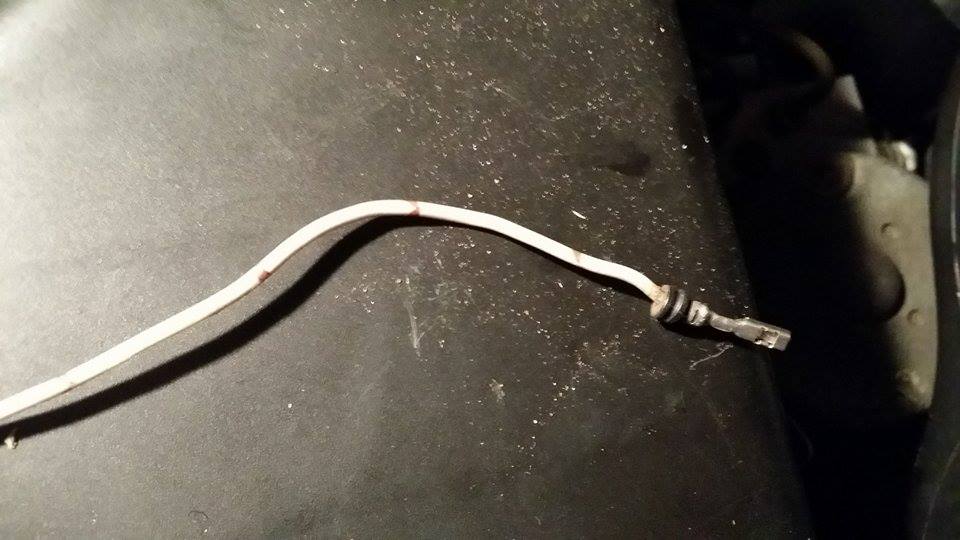

after a but of struggle and looking for the smallest screwdriver i had i pushed the old pin out the cable was rock hard from heat frown emoticon

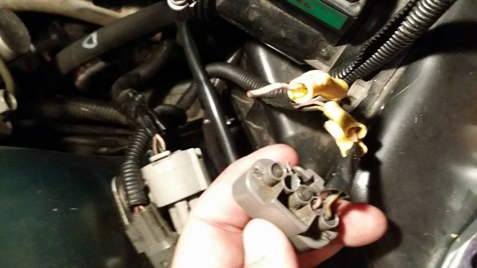

11051357 10152819475430369 1009245049 N

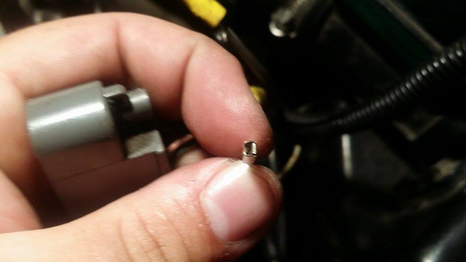

cut this injector lead off a spare manifold i have as the signal wire is the same spec and the brass clip inside is the same size also
11051379 10152819475455369 605642563 N
11047267 10152819475490369 139517765 N

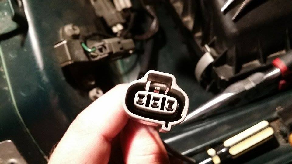

new lead and clup from the injector plug (must be the white with red
11006095 10152819475580369 334455898 N
the B shape side must be at the top of the plug where the grey plug clip is otherwise it wond slide onto the maf side

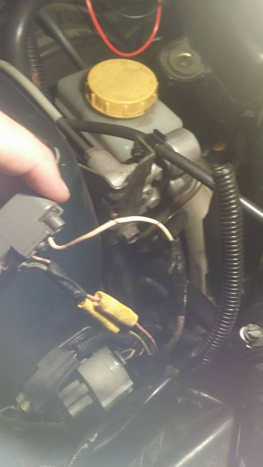

soldered and earthed back to chassis like it was meant to be frown emoticon
11047252 10152819475755369 878051366 N
all ready to be taped up and hooked up again ill be getting new power and neg leads to replace the other to that were stuffed around with before i got the car frown emoticonbut atm there fine and points all good with the multi meter smile emoticon
