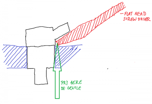

Once you take the top cap off (with the two screws)
Lots of wiggling and brute force, try not to throw them across the room when they finally pop out

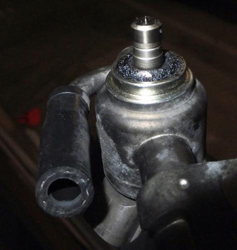

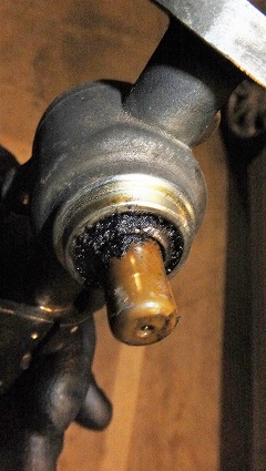

I did the passenger side... it's weird, this side seems to be a lot worse off than the drivers side. it had the rocker cover leaking oil in the past, but the drivers side didn't. now I only did injectors on this side, but the car runs so much better. no CEL under load, cold start is excellent, fuel consumption dropped.
To separate the injector from rail, there is no need to dismount the rail from manifold, but I think it should be done, so it's all accessible for cleaning... anyway I used a flat head screw driver to break them free of rail.:
post-5378-0-76287900-1476015529_thumb.pn
One thing I wanted to mention, the plastic caps on the injectors:
Well this plastic cap was so fragile it crumbled upon touch. one piece even remained glued by that gunk on the inside of that manifold inlet hole... fishing skills increased.
Now I cleaned everything, put it all together, without caps:
post-5378-0-71761000-1476014749_thumb.jp
So, to conclude. Even though the pictures here show just the dirty state, I ended up wiping all the gunk, and as ironically, fuel still works the best as a cleaner.
I then flushed the injectors with injector cleaner. I used the battery and some leads to operate the relay inside the injector, very simple setup...
And then put it all back together and yeah, it's a successful temporary fix.
One question that is on my mind. Do these injectors actually "spray" the fuel? Because when I was flushing them all I could see was a stream of injector cleaner fluid.
But ideally, there should be spray no? So the fuel mixes well with the air...? Maybe this happens under higher pressure. When the fuel pump operates...
Hmm I often wonder if what I write makes sense to anyone...

Those plastic caps are called pintle caps. You can get them anywhere that services injectors. Easier if you have an existing one to compare.
