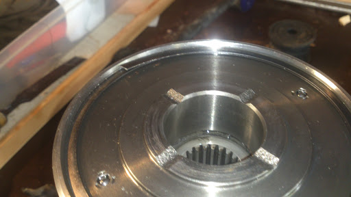

That's I found when I had to replace my transfer gear+shaft. Circlip had started to 'unscrew' and a small chunk had snapped off -- damaging the transfer.  Lucky to have caught it early. '99 outback.
