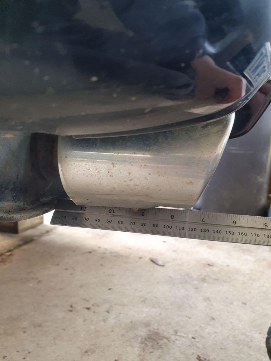

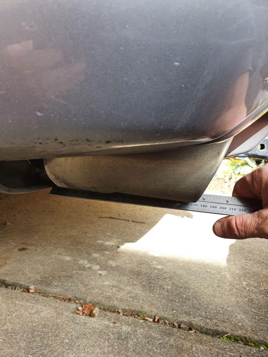

Been keeping an eye out for some STI quad tip mufflers, for anyones reference in future, hears the difference in tip length from sedan to wagon. I'm pretty certain the STI mufflers with have the same difference?
Wagon exhaust tip measurement - 170mm
Sedan exhaust tip measurement - 120mm

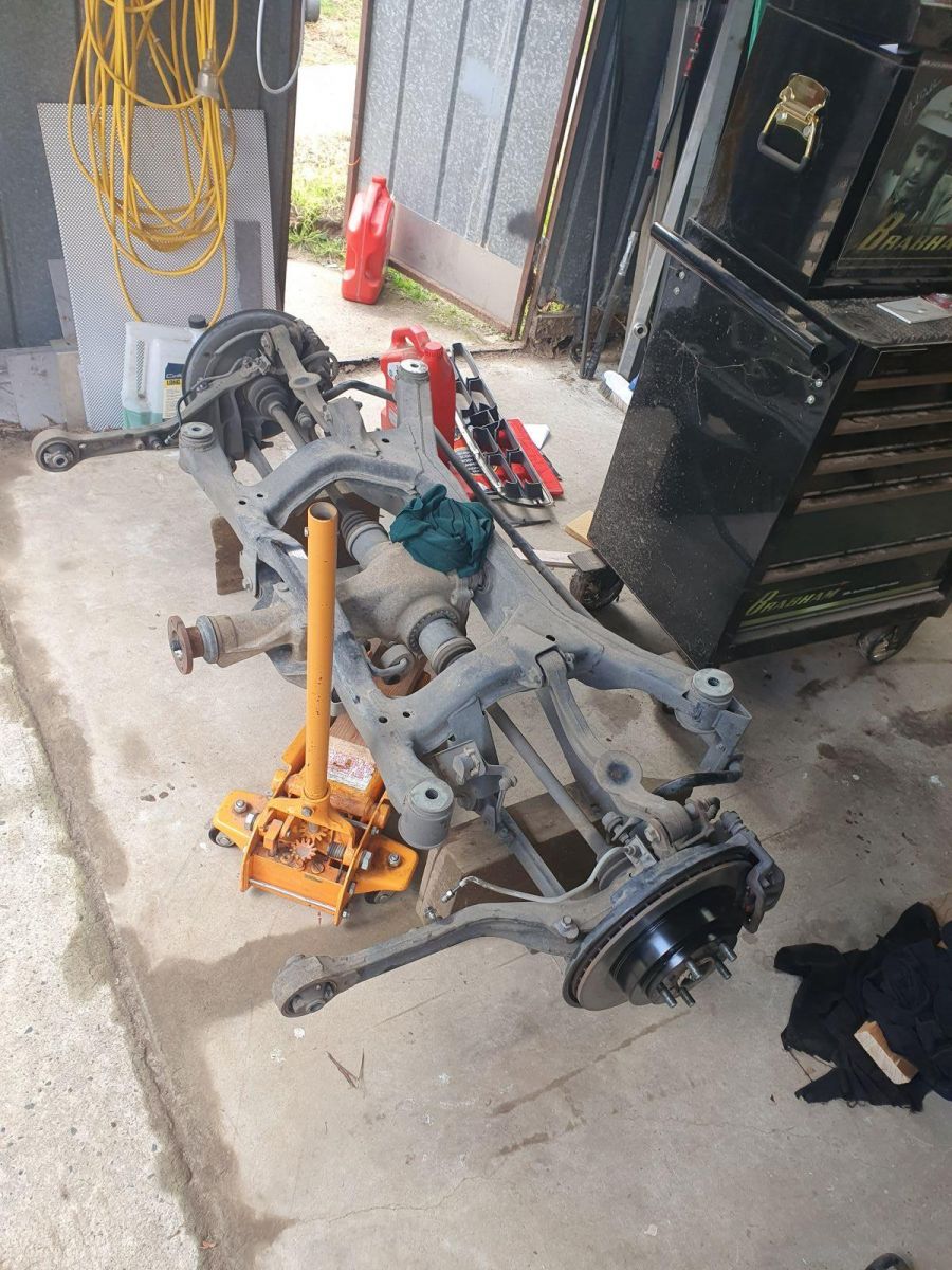

Posted 28 August 2020 - 07:53 AM
Well rear trailing arm and diff bushes turned into the whole rear end coming out.
Hopefully this choice of whiteline and OEM bushes goes alright:
- whiteline trailing arm front bushes, rear diff and diff carrier
- oem everything else
- new bilstein bushes for the rear shocks
Next on the list will be to rebuild the front struts (bushes and seals arrived yesterday), seem to have a funny noise when reversing out of the drive way at a slight incline.
Has anyone here noticed a difference when running alloy rear suspension arms? I almost thought of ordering some but don't really want to wait 3-5 more weeks!

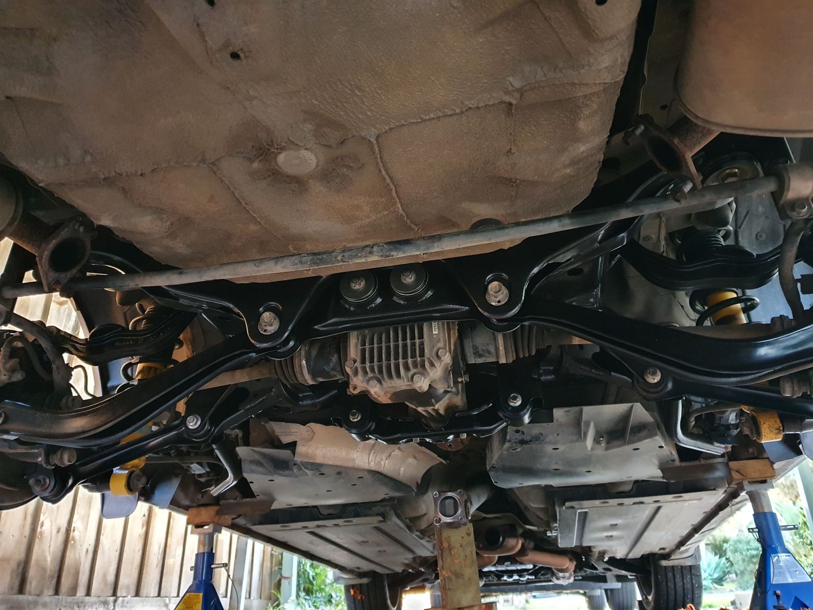

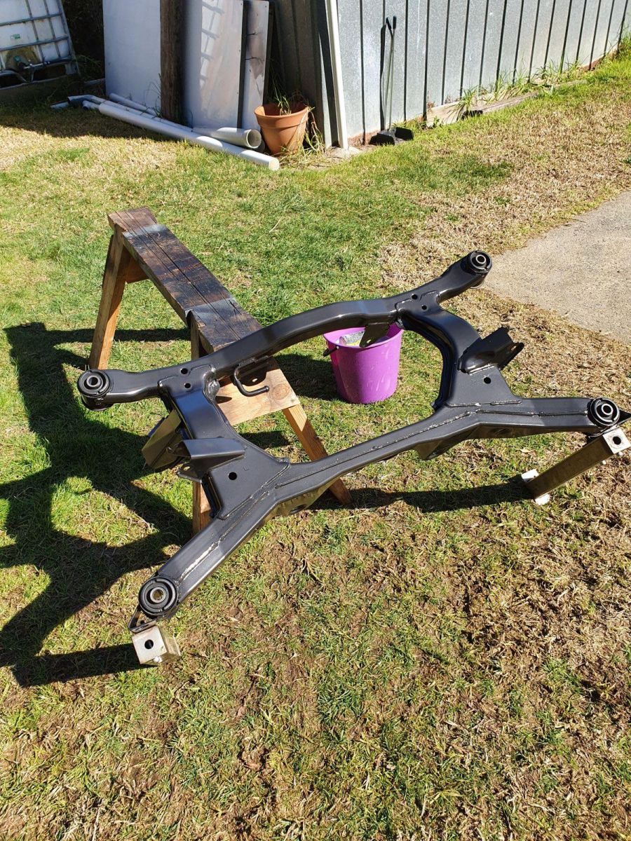

Posted 10 September 2020 - 11:35 AM
Almost ready for the roadworthy check!

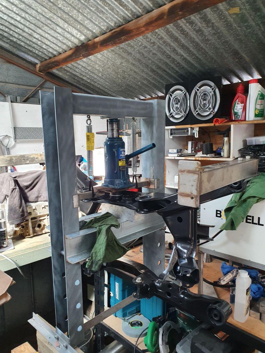

All the rear end bushes replaces including the lower shock bushes, but not the sway bars. Hoping to get a bigger sway bar when possible.
Kept picturing barb's clean powdercoated parts in my mind every time I looked at this. Hopefully it stays this clean for longer than 10min! Barbachello how does yours look after a few drives?
rebuilt rear end
gen4 rear diff bush install
spray painted rear subframe

Looks good mate. I’d love to have a press! And also Barb’s money bags and patience to powder coat everything!!
All the best with the roadie!

All still looks good. Little bit dusty comes off with a wipe instead of a scrub etc

Posted 10 September 2020 - 03:11 PM
Yea the press is the best thing I ever made! Cost less than $100 (now and then you see them for sale around that!), and luckily the subframe actually fit in it.
