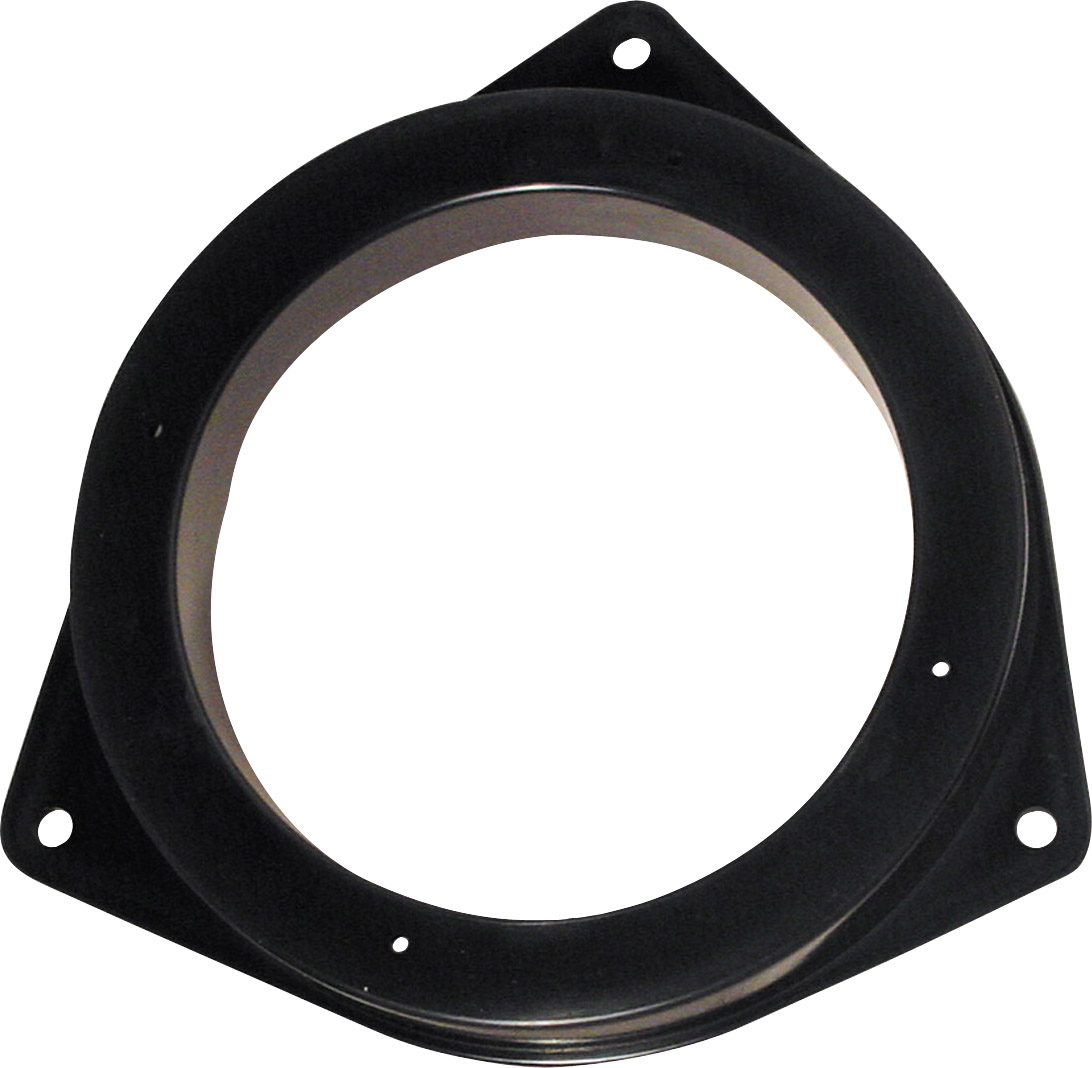

Gen3 speakers are 6 inch.
The speaker on the left is similar to wat GEN3 speakers look like...
If you are wanting to put in aftermarket speakers u need to make or purchase a speaker adaptor...
Posted ImagePosted Image

I managed 2 fit 6.5" ones in all 4 doors, just made my own spacers out of mdf... Theres plenty of room there 4 them 2 fit just make sure the spacer is no more than 12mm thick...

I used $15 spacers from autobarn. I have 6.5" speakers in the front now.

i just took out the existing plastic bracket and used that as a template to cut out the mdf...
easier to drill the holes for the same screw position into the door and hole for the speaker as well
then just a couple more little cuts and trims when you fit it to clear the door trim...then all done...did it all last year

Yeah but the new stock speakers are very thin, and the new speakers (unless they are slimline) will need the spacers behind them.

very very bad idea. the window is surely to hit the coil on the back of speaker. stocks are only rated at 30w, pretty much anything other than some infinity slimline series requires spacers.
