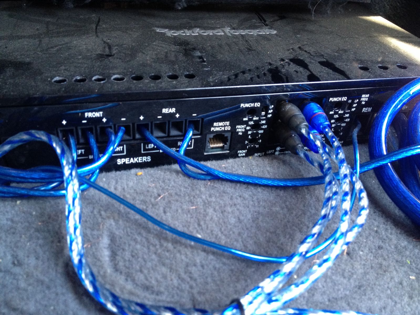

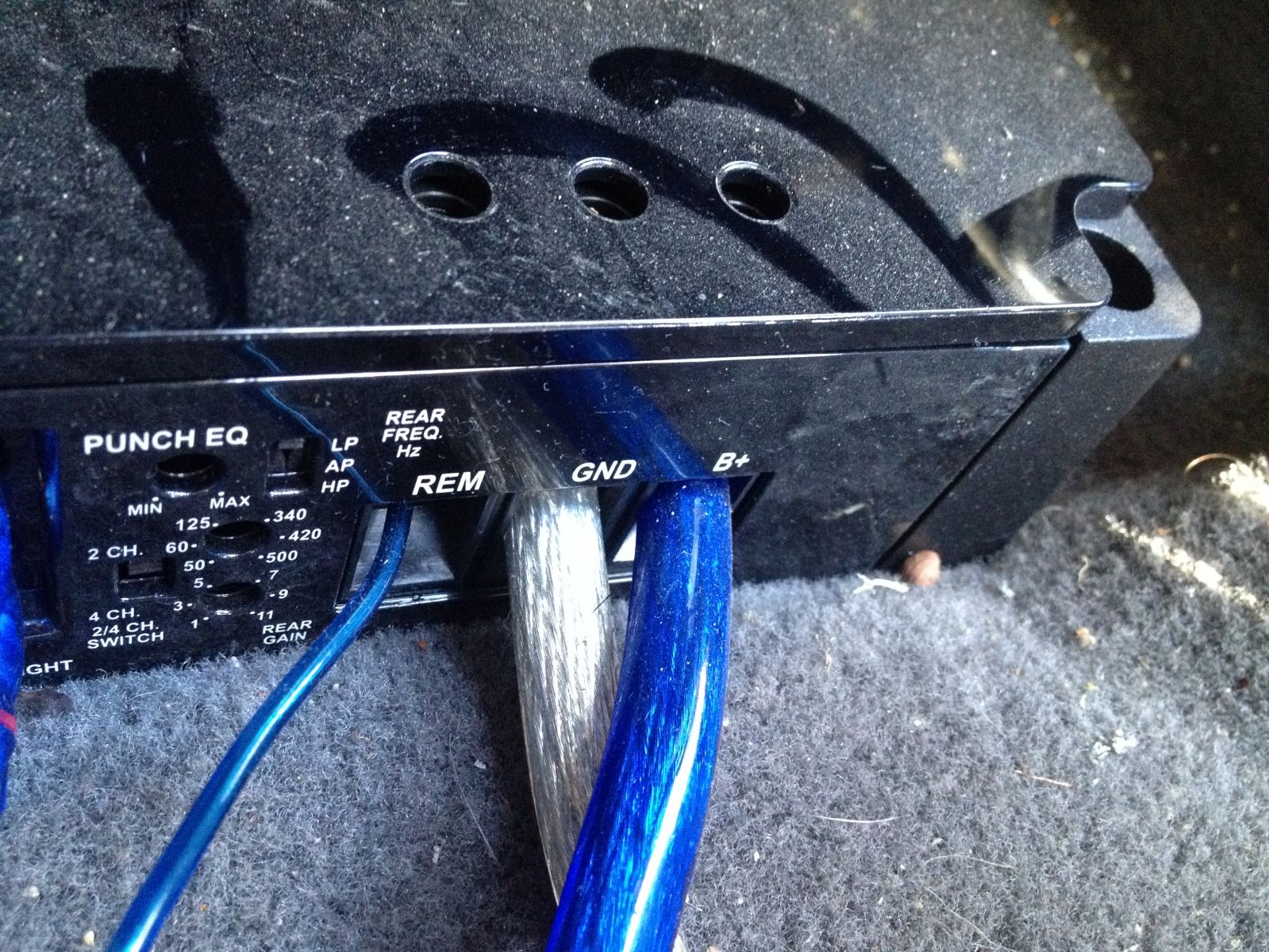

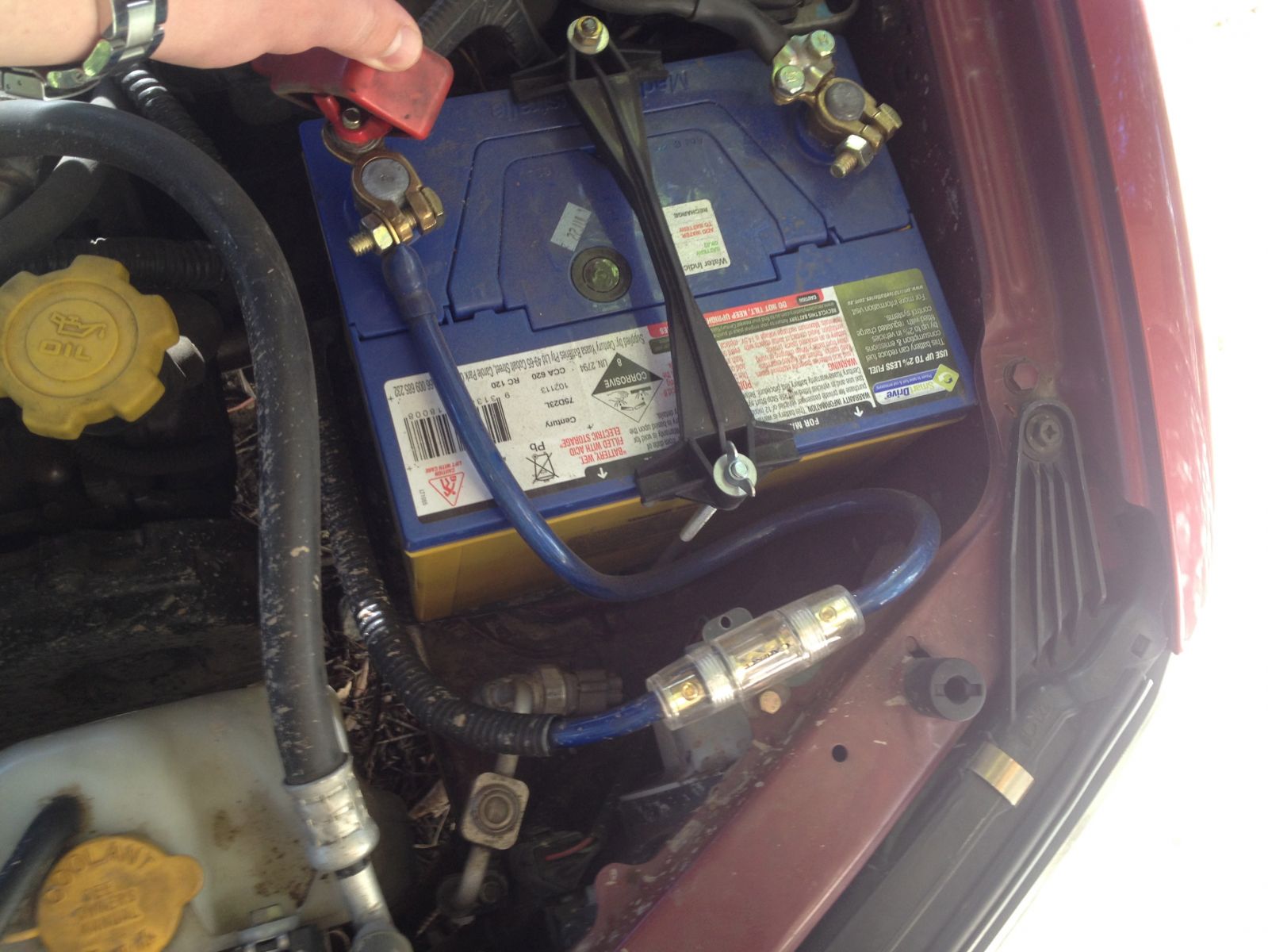

#15 tamastar
tamastar
  • 103 posts
  • Location:Blue Mountains, NSW
Posted 26 October 2013 - 05:52 PM
IMG 0809
IMG 0808
IMG 0807
Some photos of the install. Obviously RCA's from the amp go to the pre-amp outputs on the back of the head unit and remote wire goes to head unit wiring loom. The ground cable from amp is bolted into stripped back bare metal behind the seat belt bolt under the side trim.

#16 Sic'Em
Sic'Em
  • 43 posts
  • Location:Adelaide, SA
Posted 07 November 2013 - 09:58 PM
In that case, it's probably a faulty amp.
Is the amp over heating when the sound system is cranked up? You might have a bad/dry solder joint on the circuitry somewhere... tbh it could be anything. I'ts hard to diagnose with a keyboard over a forum. Take it to a car audio specialist and go through the motions of what is happening, they will soon tell you what the issue is.
