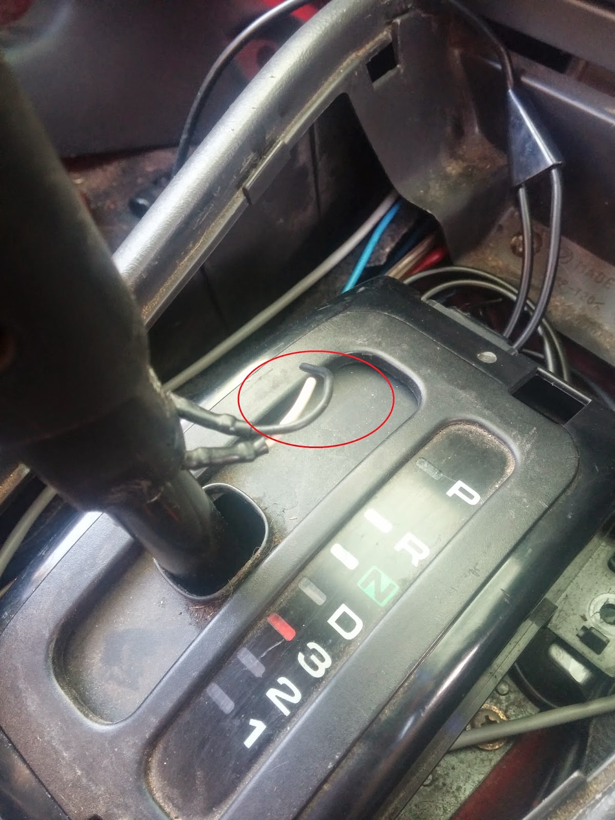

Remove the screws located on either side of the gear selector base and pull the selector up
If you have the power button you will have to cut the wires, you can wire it up to another switch later but for now i'm leaving mine disconnected.

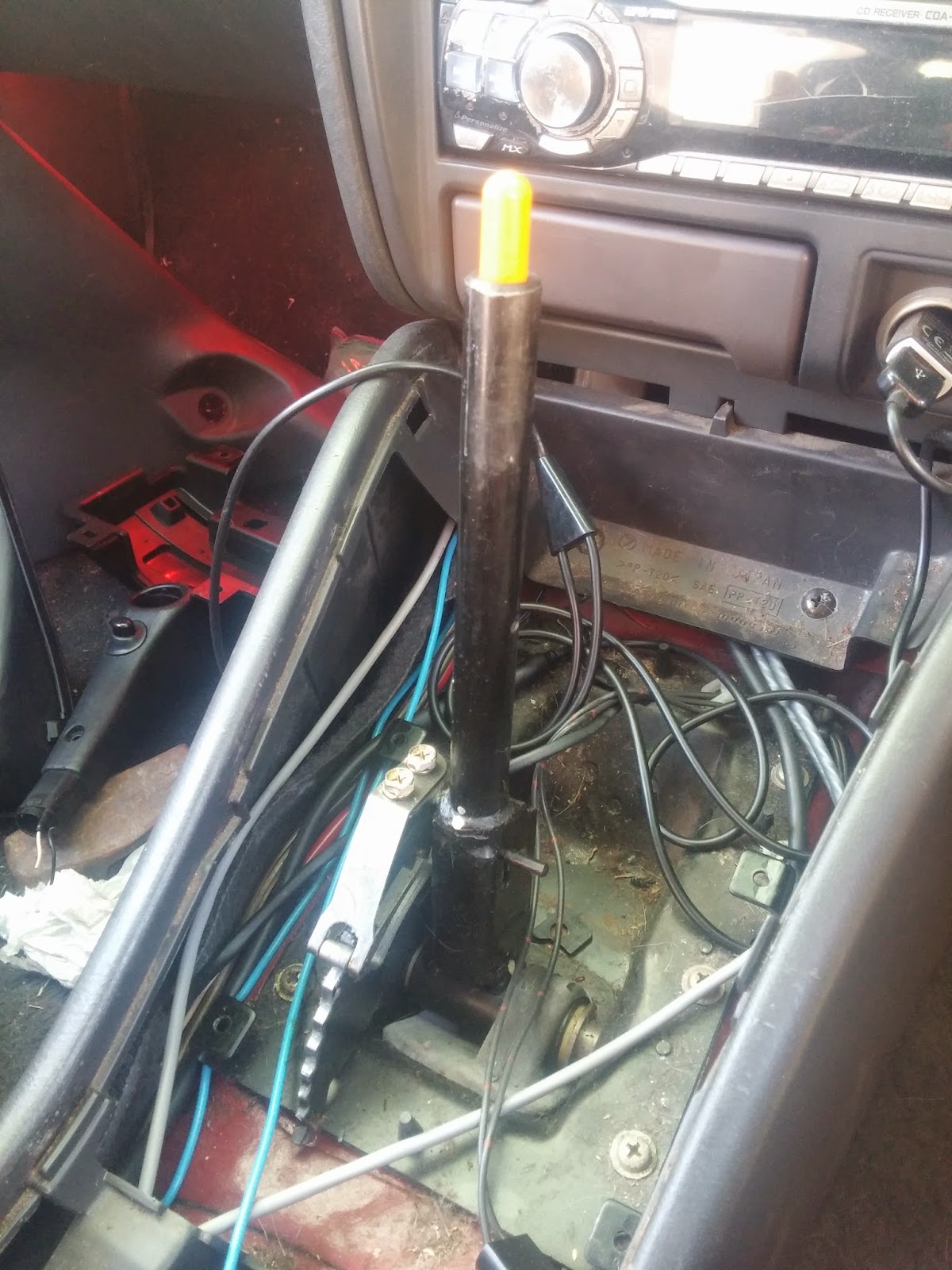

Remove the four screws holding down the gear selector housing.
This is what you'll be left with, the yellow button is pushed down to allow the selector to move
Pop on your aftermarket knob and original boot from the manual and it should slip right on.
To change out of park you should be able to push down on the knob and change like normal
