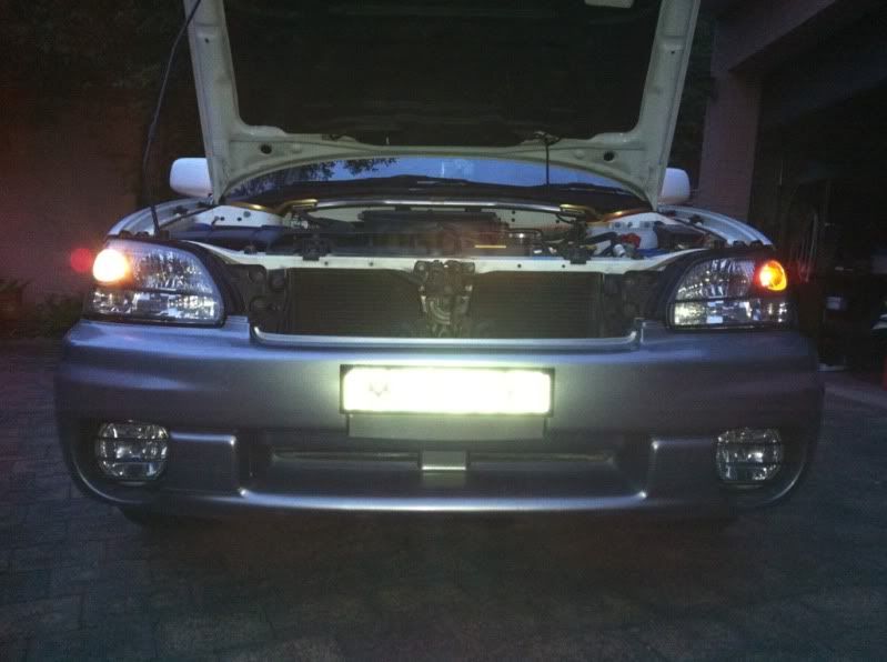

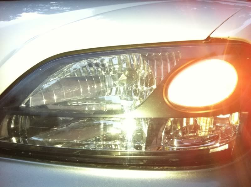

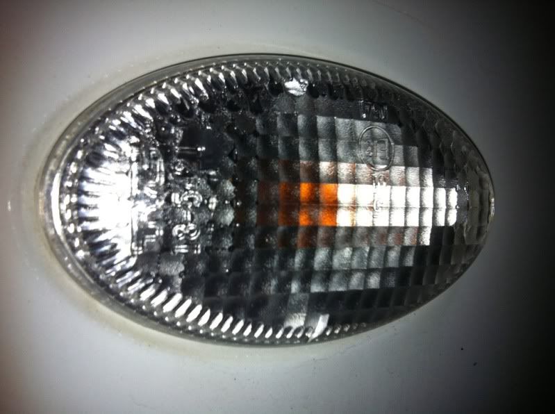

Posted 13 April 2011 - 07:49 PM
Zero orange left on the car.
Chrome globes arrived and installed today
Stock halogen
RHS done - LHS stock
Orange globes - side indicators
Chrome globes

#315 Morgan
Posted 28 May 2011 - 12:09 PM
Wrote this up in someone elses thread not too long ago
Re globes. I've found a few mobs on ebay who sell chrome globes that flash orange.
T10 wedge style (side indicators)
T20 wedge style (the Rev D/E have these for the front indicators. I think Rev A-C have bayonette style)
Bayonette style with in-line pins (for rear indicators)
Bayonette style with offset pins (for rear indicators - my Outback uses these)
Clear side indicators (You can buy these here or get some off a Foz or Impreza. They all fit
