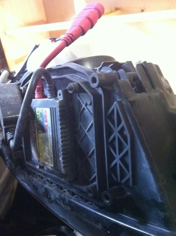

#296 Morgan
Posted 08 April 2011 - 05:26 PM
They're done :)
A few little scares. When putting the two pieces back together again, they just wouldn't line up! Had to pull apart 4-5 times for it to finally work!
I got some of the glue (man that stuff is like tar!) on the lens but nothing a good squirt of De-Solve-It can't fix. However, I did accidently get some on the inside of the lens! BAHHH!! Got most of it off and it's not too noticeable thank goodness!
Once it was all put back together I tested out all the lights and the highbeams weren't working. Everything was plugged in right. After pulling it all back out again, turns out both the globes broke in the process! Haha!
Also, does any one else know if this is right:
When lights are on, you either pull back on the stalk to flash high beam, or push forward to lock it on.
BUT, when you don't have any other lights on, if you pull the stalk forward, the regular lights flash instead of the HB globes???!!
Weird.
And annoying because HIDs take a while to warm up!!
Anyway, here's some pics :)
I love it!
Turns out there is a silver cup holding the orange cap in place. I'm not sure if I was supposed to leave the silver cup in there but one of them snapped so I guess that answers it for me!
Took a pic of this too because I didn't when I installed the HIDs. This is my small ballast mounted onto the underside of the headlight.
All I have to do now is buy some chrome large wedge-style globes that flash orange :)

Weird issue you have with the lights ON. Obviously the high beams should supplement the lows when pulled back. When pushed, nothing should happen.

Hey morgs.
I did leave the plastic chrome cup in there. But the first one I snapped aswell but superglued it back together.
