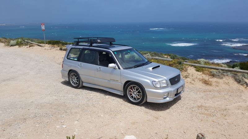

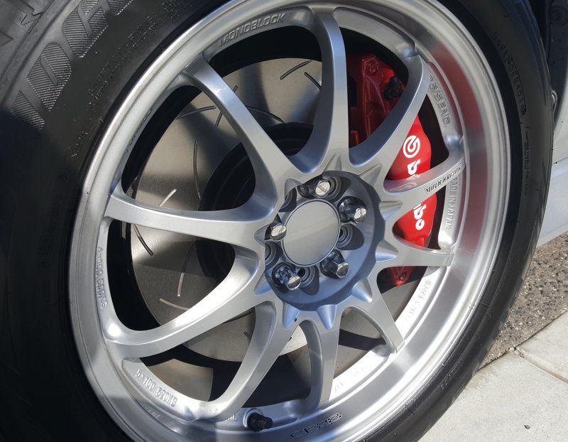

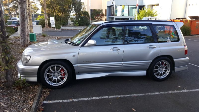

Posted 25 April 2017 - 01:29 PM
Some of the mods since the last post from soooo long ago. Will also update the initial post build list later.
JDM Floor Mats
Rays Volk CE28N Titanium Silver 17x8 rims with Potenza Adrenalin S001 235/50R17's
Tein Flexwagon coilovers with superwagon springs
Rays Volk steel lock nuts
Blue heated side mirrors
Autodim rear mirror with compass
Repainted rear bar
TIC Holy Shift Kit
CCI STage 2 clutch and lightened flywheel
GDB-E Front Torsen LSD diff (Rear GRB torsen lsd installed a while back, no more sureslip!)
SuperPro replacement RCA kit
New DBA4000S discs and EBC red pads
