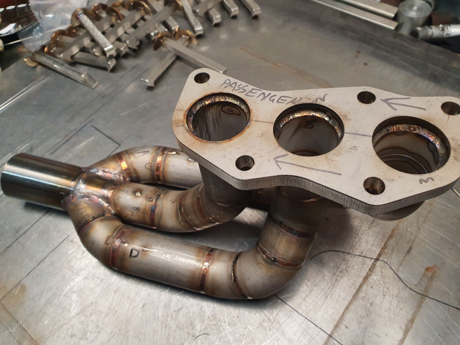

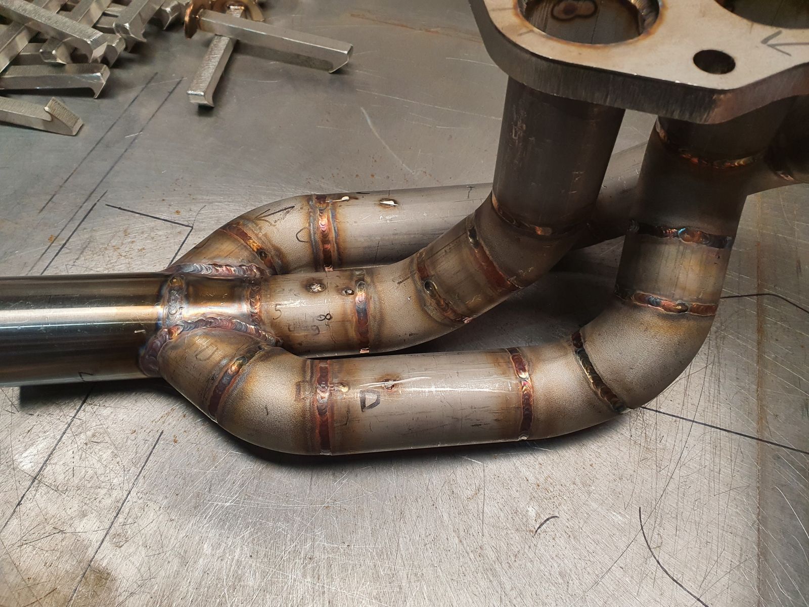

Manifold specs: 32NB stainless pipe (36mm ID, head exhaust ports measure 35), supergramps style design merge into 50mm tube, will have v-bands and into a 2" (maybe larger) up pipe. I'm not expecting this to go 300+rwkw like actual supergramps, hence the smaller pipes etc.
