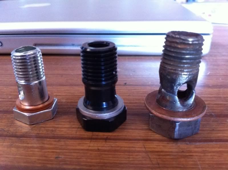

First Fail: Subaru water banjo fitting bolt on the left, Garrett water banjo fitting bolt in the middle (blackz0rs) and the original on the right.
So bolts went in... But the coolant return line kept weeping. New bolt. New crush washers.
Then I discovered this:
The banjo fitting had a hairline crack in it.

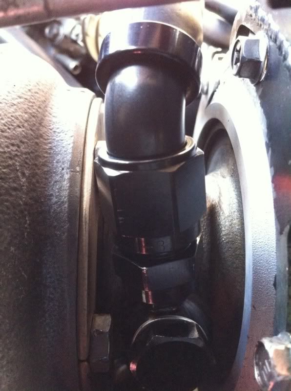

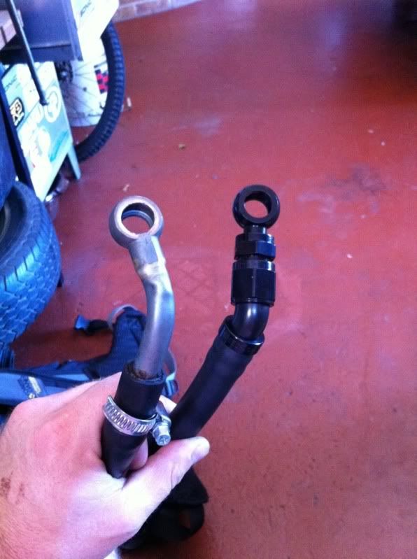

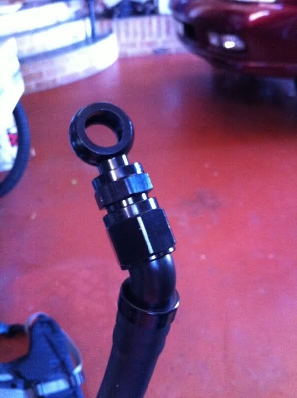

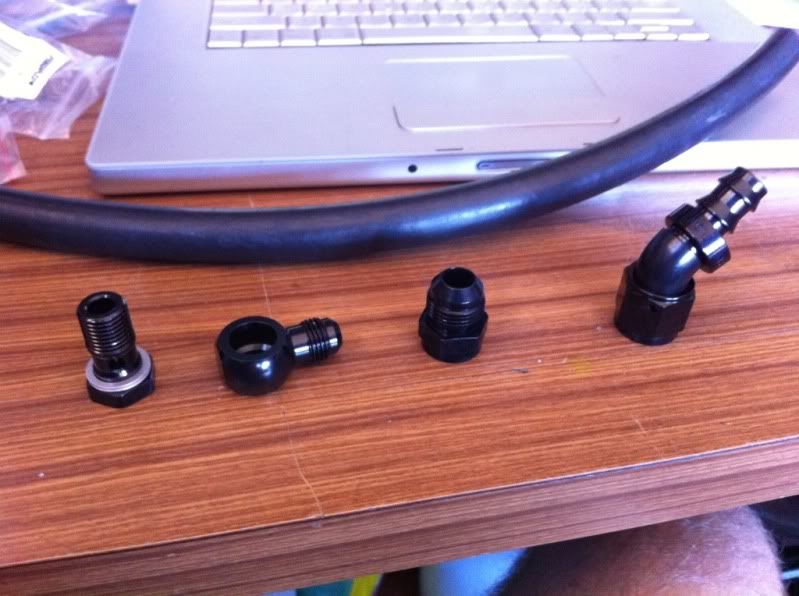

So I went back to Motorsport Connections... and bought some fittings and fresh hose (flameproof,because its near the turbo exhaust housing (anodised black... no less.) One thing I liked was the fact that the fitting had a push lock fitting. No hose clamps. Win.
and now its fitted.
No more tears. No more leaks.
Probably an over-engineered, over-priced fix (I can hear the penny pinching haterz now), but it works, and looks good.
And this could be the start of a Speedflow fetish?

Looks good Alex.
Does the new bolt allow enough coolant flow? Holes look smaller.
The dodgy one looks as if it was overtightened, seems twisted.
Tip: I always put a bit of copper grease (Wurth CU800 or Copper Eze) on bolt threads that are exposed to coolant, to prevent them seizing.
