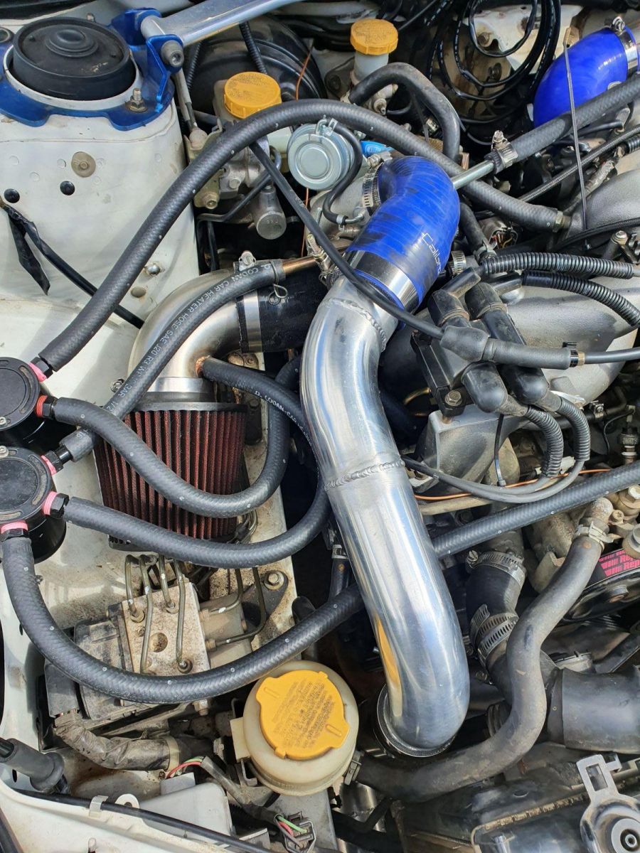

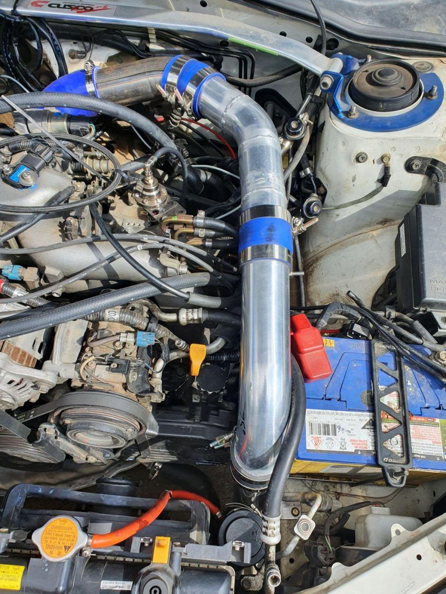

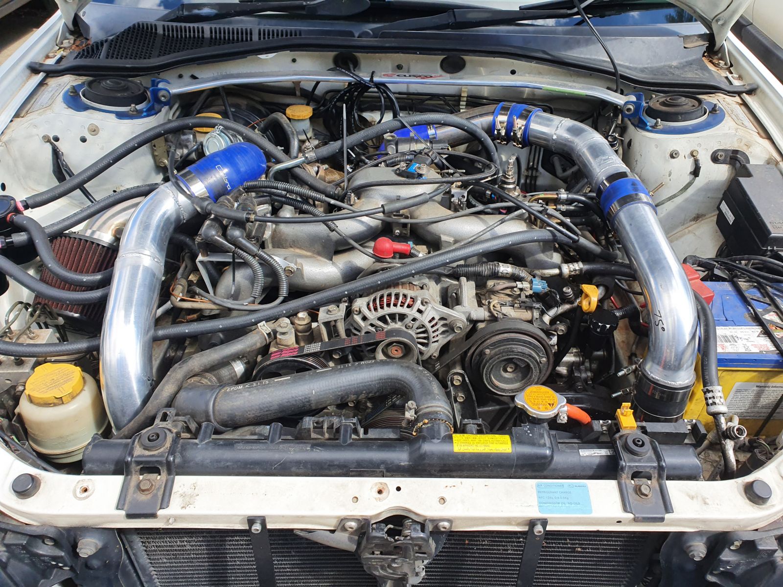

G'day gents,
Been a long time and I talked about this turbo install for even longer! Well it actually happened! Has been in for a while now, running 5psi and from what I can see it looks pretty safe from the (project lambda) datalogs and drives pretty sweet! I don't think i'll ever go back to an n/a 2.5!
Still have to finish the last section of piping (ran out and had to use some mild steel..) and install the BOV, for now it makes some slight flutter and mad spool/induction sounds!

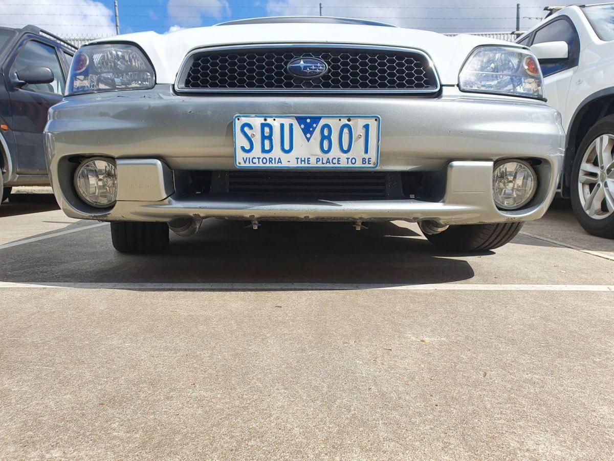

Wasn't too sure how the intercooler piping (2.5") would go under the radiator but so far it isn't too bad. Hangs a little lower than hoped but I have not scraped anything yet.
I'm waiting to see how long the dual-range box lasts. I actually think they might be stronger than people think. ADS advertise some decent power ratings (250hp/185kw from the base model, with a turbo 3rd/4th gearset). I thought the hi-low gearset would be a weak link but might be strong enough for this setup. I don't think I'll ever try a decent launch though..
Other specs:
- full 2.5" exhaust with twin-turbo BE5 muffler (valve always open) - fairly quiet and should have plenty of flow for this motor.
- forester 2.5 TD04 turbo
- 450*300 fmic
- 550cc injectors
- delta 1500 cams, 9.9:1 comp, STI headgaskets, arp head and rod bolts.
- turbo oil return into the valve cover - zero issues so far
- 2.5i exhaust manifold, custom up and down pipes - For anyone thinking of doing this, I'd strongly suggest doing the turbo crossmember swap and using standard up/down pipes.
For s4its and giggles I'd love to dyno it and see what it makes, any guesses?
