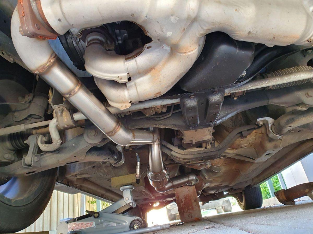

Interesting setup with the turbo! Did you do the yank up pipe trick from behind the engine crossmember?

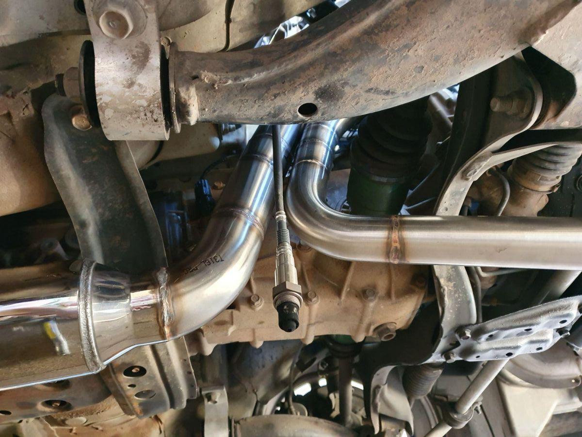

I made an up pipe that goes under the crossmember and up from some 2" SS. I'll try find a photo. The twin catch can system is basically identical to a mishimoto setup for a wrx. 1 can for the crank case and 1 for the heads. The crank case can catches a fair bit but the other doesn't.

I wrapped the up and down pipe together with exhaust wrap. So far nothing has melted on the firewall!

Neat exhaust work CRJ. I like the O2 sensor “mod”! :P

Haha thanks El_Freddo! That was a test fit before the first install which had the oil leak so the piping was re-jigged slightly so the turbo is horizontal.
