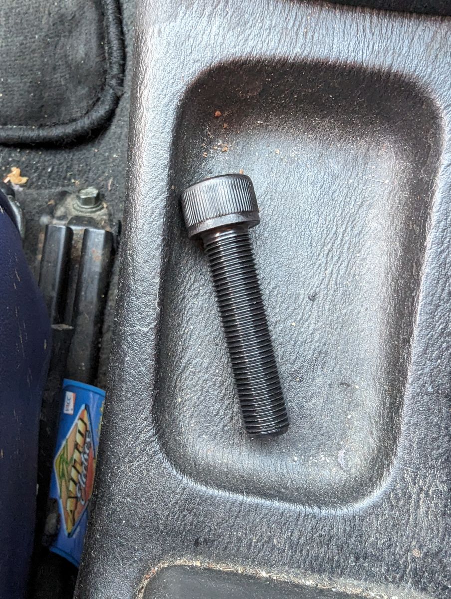

Got some appropriate cap head GR12.9 bolts sitting at the local supplier waiting for me to pick them up...

Ok, bolts acquired. Ended up getting cap heads, as that's what the supplier had in stock, and he was going to have to order in a special box of 50 if I wanted the normal 10.9 hex heads, at around 70 or 80 bucks. This way cost me 13 bucks. They're set screw unfortunately, but once they're done up nice and tight, they'll be fine! Would have been good for get a shank on them, but not worth the money or the fact I'd have to have 40 odd spare bolts I'd likely never use...
Will get these fitted over the next week or so and fit the rest of the rear end.

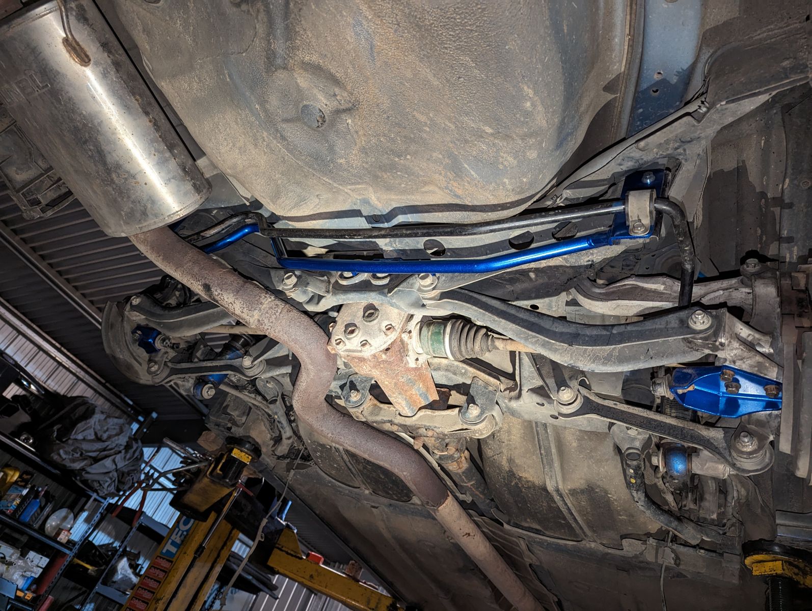

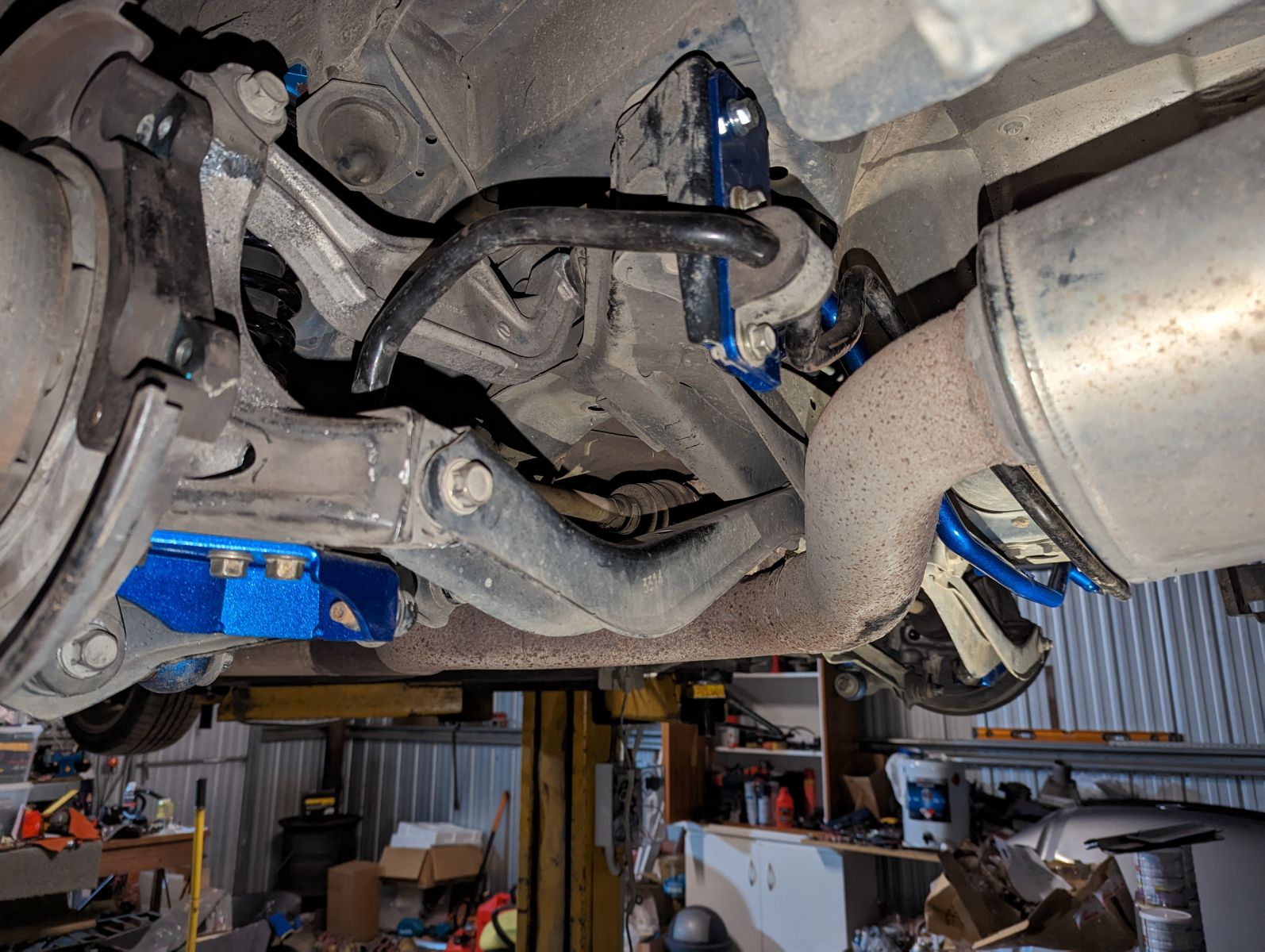

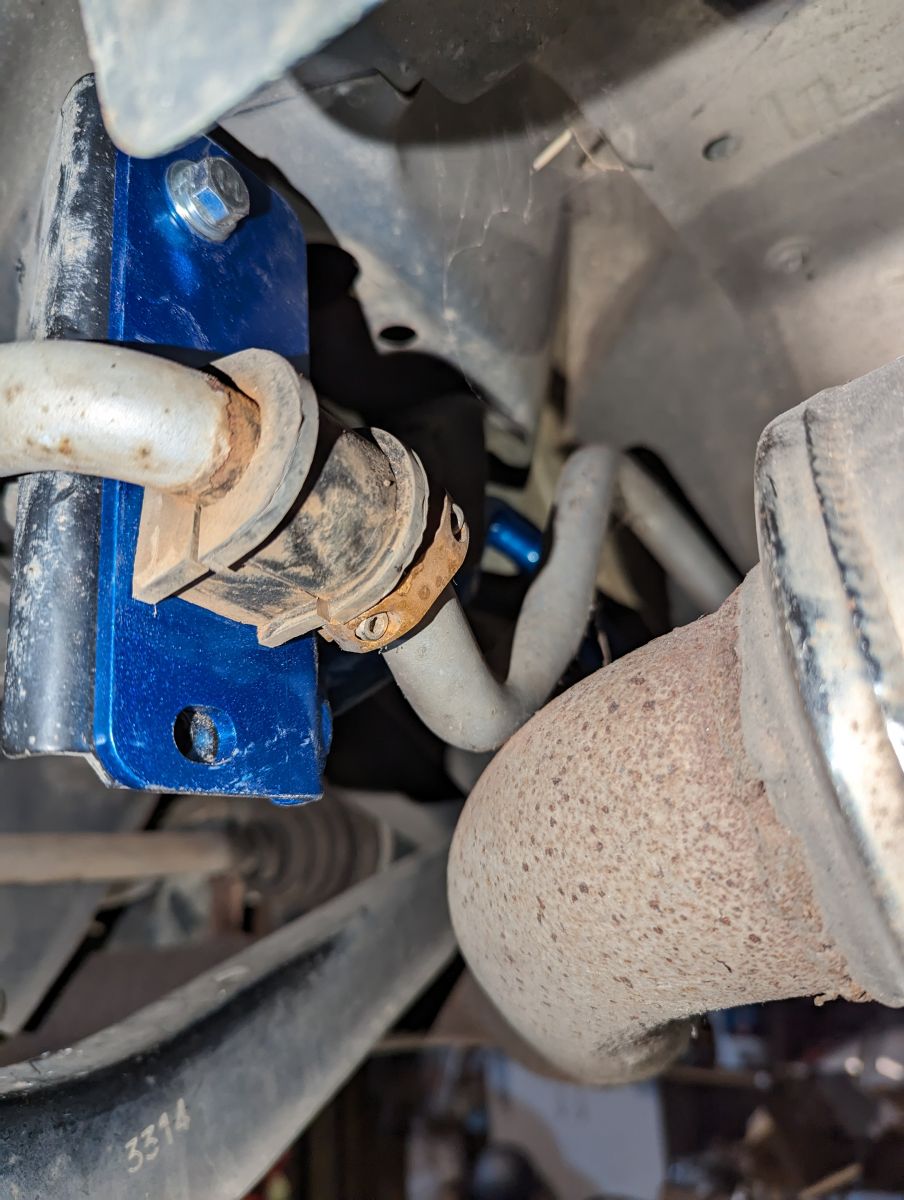

Got out into the shed tonight, all the hubs are done up nice and tight, so they're not going anywhere. Also pulled the rear bar off and started installing the Cusco rear diffuser and brace bar. Turns out the brace bar also braces the sway bar mounts, so the gen4 ones are not required. Shame I've cut one a bit, otherwise I'd sell them on. Ah well. Either way. Love the look of the dual bars (Cusco one follows the same lines as the sway bar).
Also tried to put the Whiteline rear sway on. No go. Doesn't fit the 3" exhaust. Shit design, as it has a kick down where the stock one does not. So there was a half hour wasted...
Stock one has now been reinstalled, and all bolts tightened up. Will hopefully finish up the diffuser install later today, but we'll see how that goes.

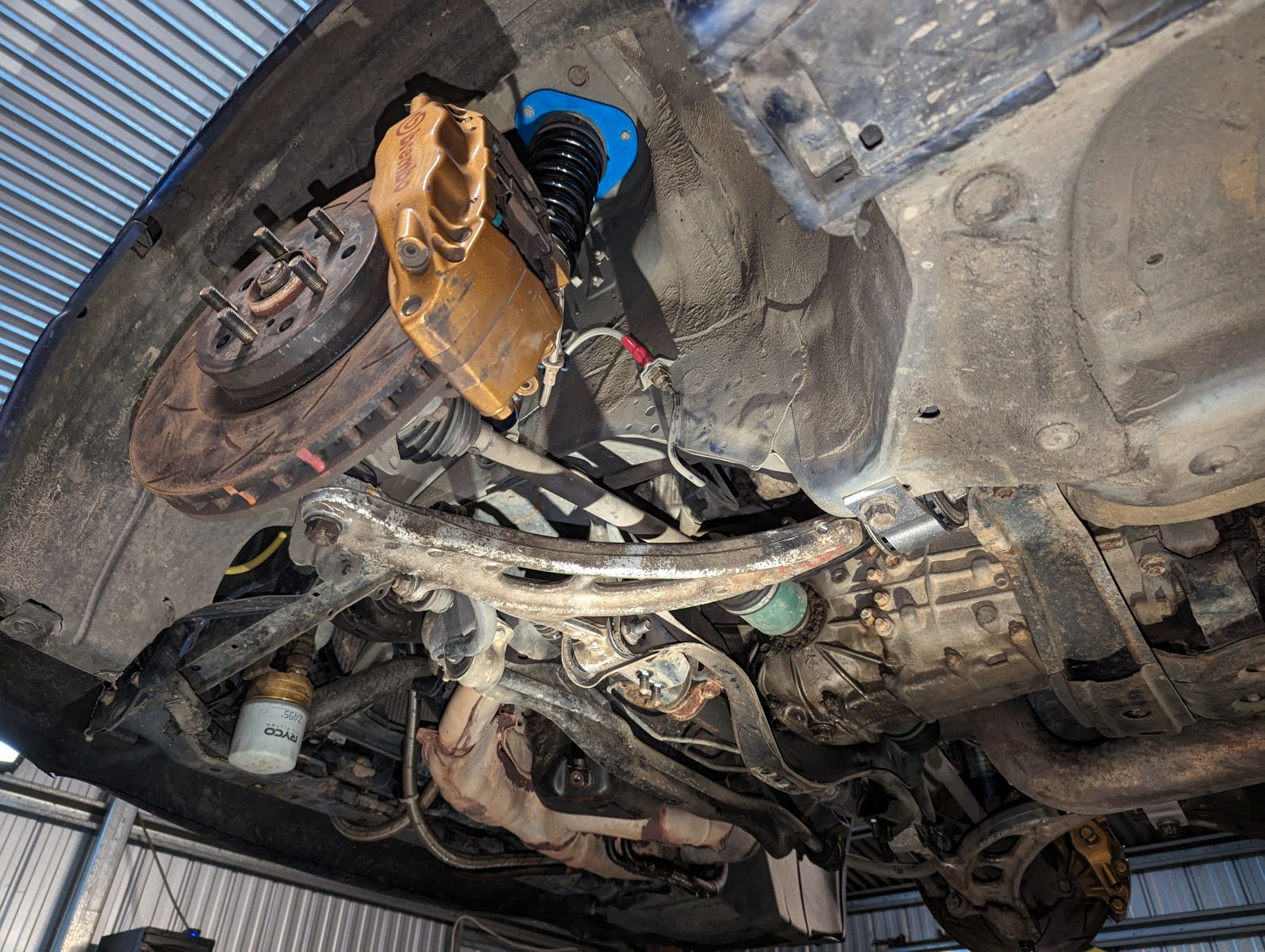

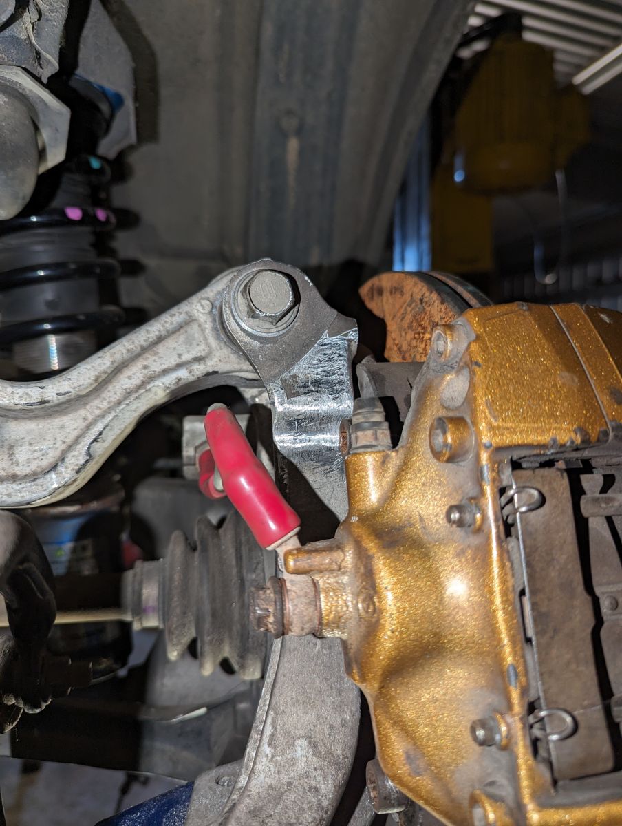

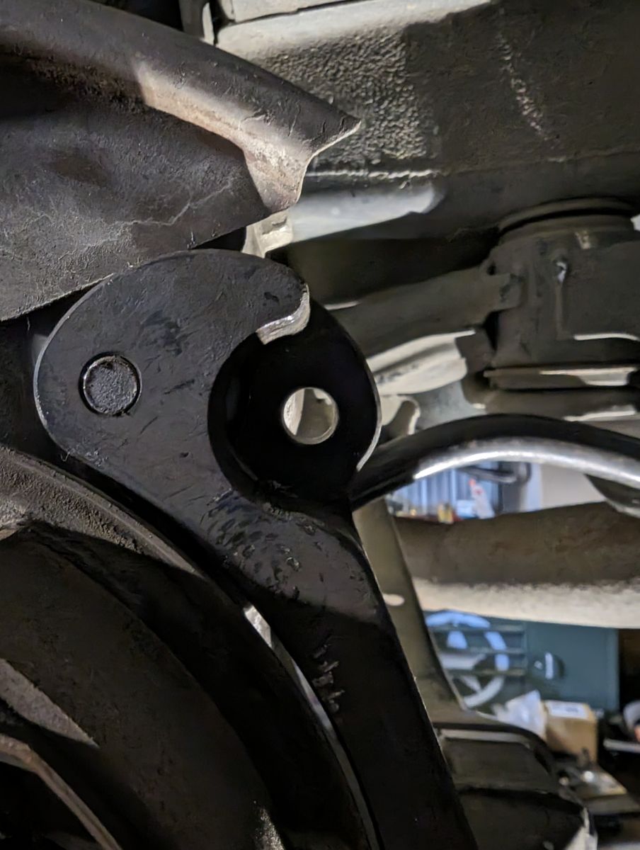

Have to do some "adjusting" to the alloy arms to allow me to get the bolts into the Brembo calipers, as the alloy is a lot thicker, whereas the steel arms fit no issues. Going to be putting cap heads in again, just to reduce the amount of adjusting required. Can't wait to get this all finished up. Still lots more to do yet. But I'm slowly getting there.
It's hard to see, but you can see the alloy arm through the top hole, so I have to take off a little bit of material to allow the bolt to slide in and sit square on the bracket. Last thing I want to do is cross thread the calipers, which are known to strip threads as they are...

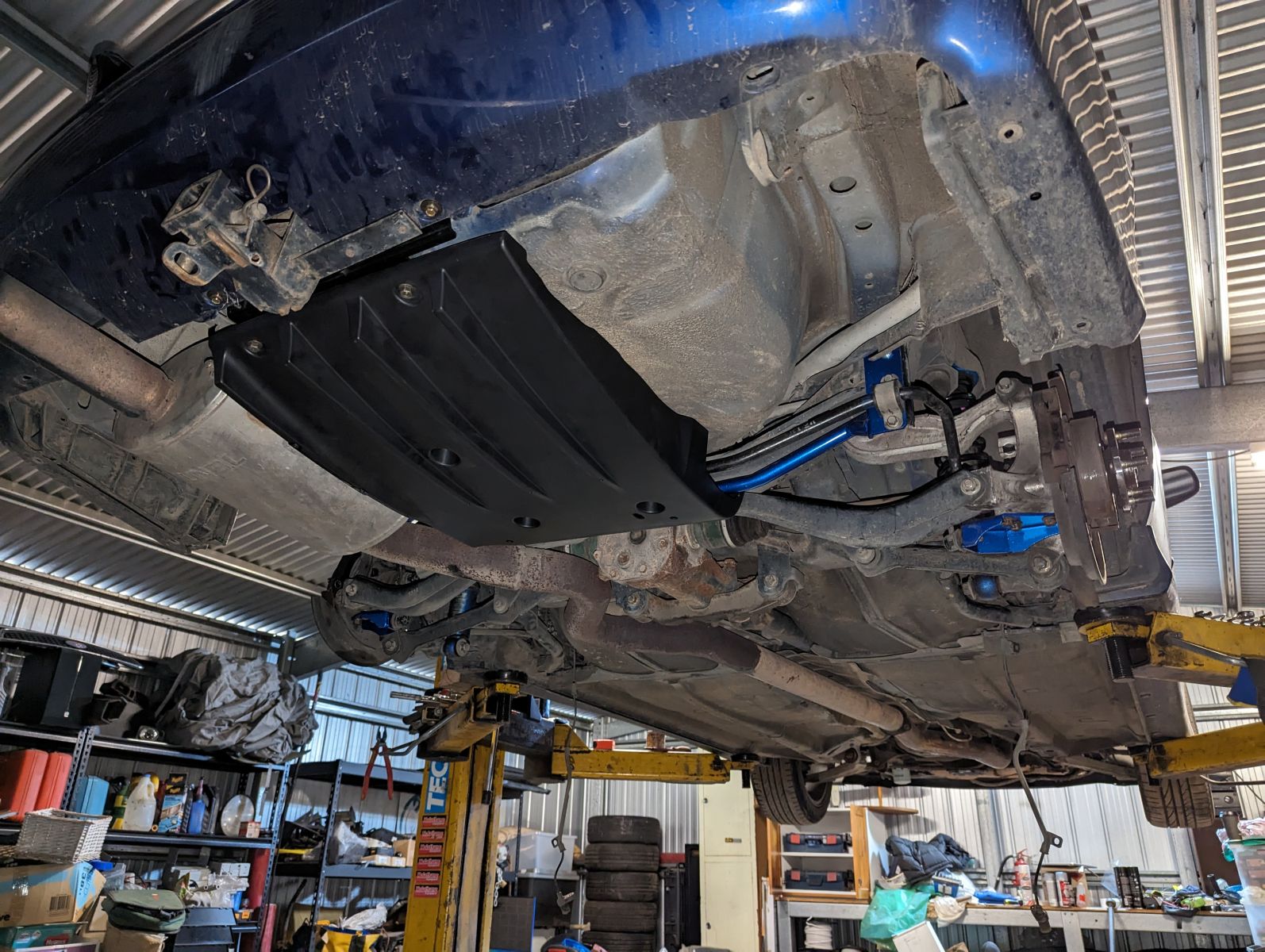

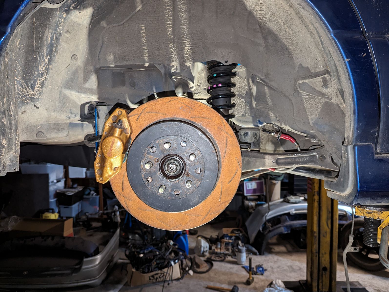

While Seb was down, finished off the diffuser install, which required some trimming of the diffuser to suit the chassis. Instructions (with photos, a godsend, cos I can't read japanese) laid out which parts to trim and how much, which was good. Initial test fit identified that I hadn't taken enough off, which was a simple task, but a bit more time.
Made a start on adapting the passenger side alloy arm so I can get the brembos installed as well, after finding out my dremel actually came with a die grinder bit with it. Slow going, as it doesn't take much material off, but its working a treat. Plus I'm test fitting the bolt every so often as well.

I think I need to buy a proper die grinder, cos the dremel is so slow! Despite spinning at 30k rpm, because the bit is so tiny, it doesn't take much off, and cant get a good grip on anything. A proper grinder would certainly need to be watched!
Went back in last night at about 9ish, spent another 3 hours tinkering. After a few hours I got sick of the dremel, and grabbed the drill with a standard drill bit and used it as poor mans die grinder... things went much faster then!

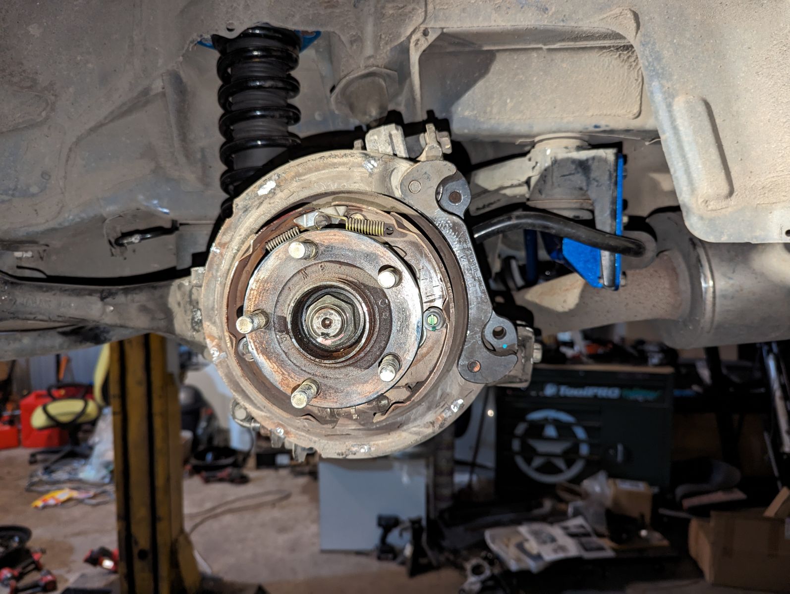

Also needed to take the rear dust shield off, as its smaller than the actual rotor...
Drilled out the spot welds, then took to it with a chisel followed by the dremel with a sanding tool on it to smooth out the spot welds left on the backing plate.

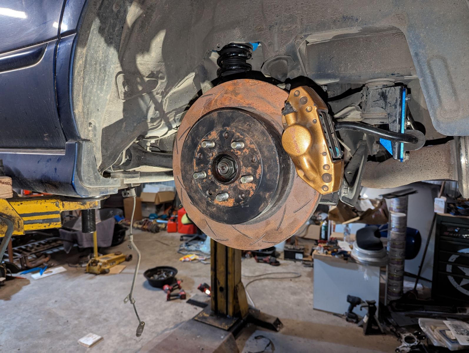

Passenger side all fitted off nicely! Brake lines are going to wait until everything is mounted and ready to go.
Also got the drivers side close enough to done as well, but I don't think I took enough material off the arm, as the lower caliper bolt feels like it's trying cross thread once the upper one is close to being done up. Once I figured that out, I decided to call it a night, go have a shower to wash out all the aluminium dust and shavings out of my hair and go to bed. Will get the drivers side apart again and sorted once Seb goes down for his nap later today. There's a remarkable amount of material that needs to come off even for cap heads, let alone the proper hex head bolts.

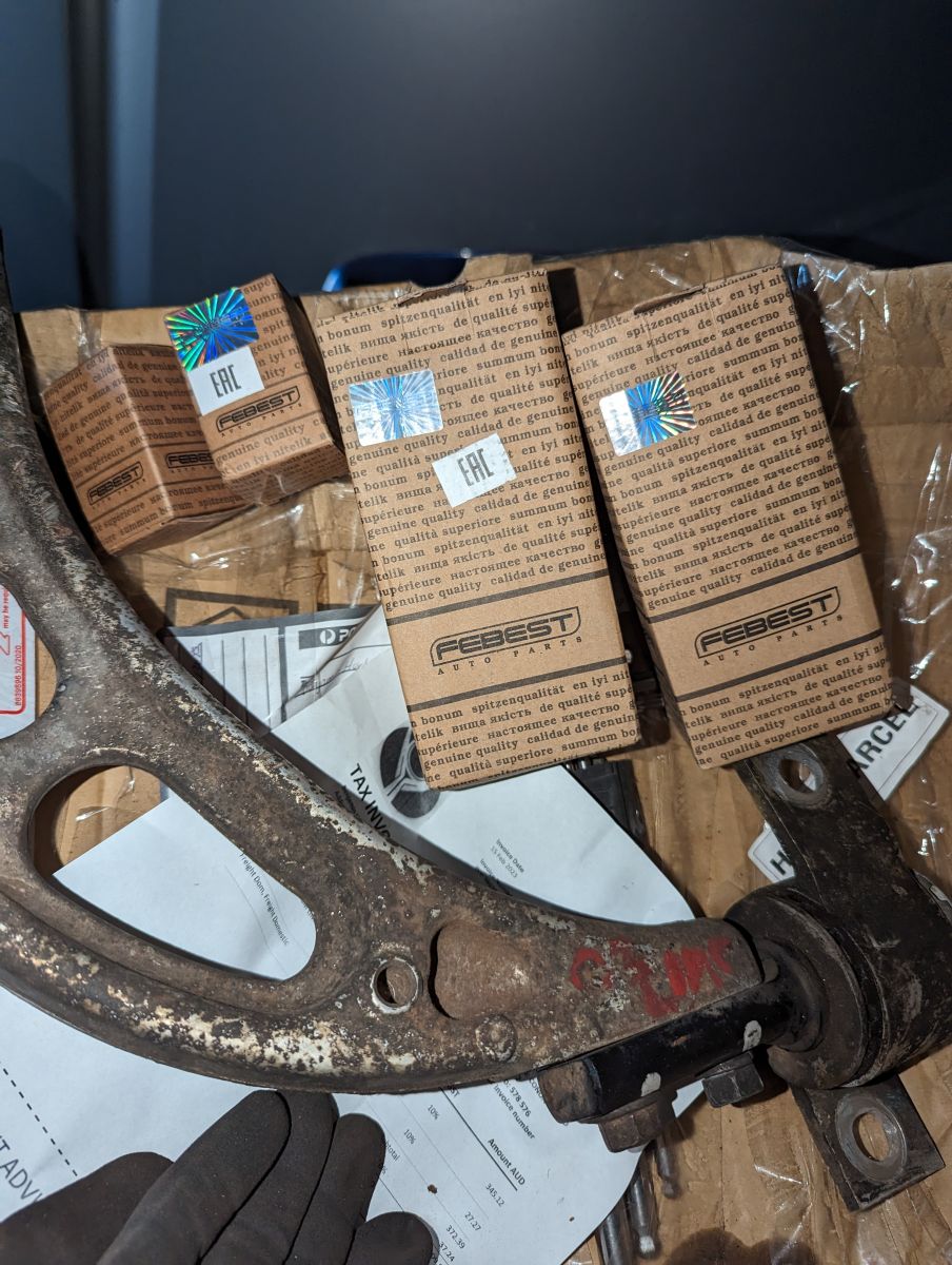

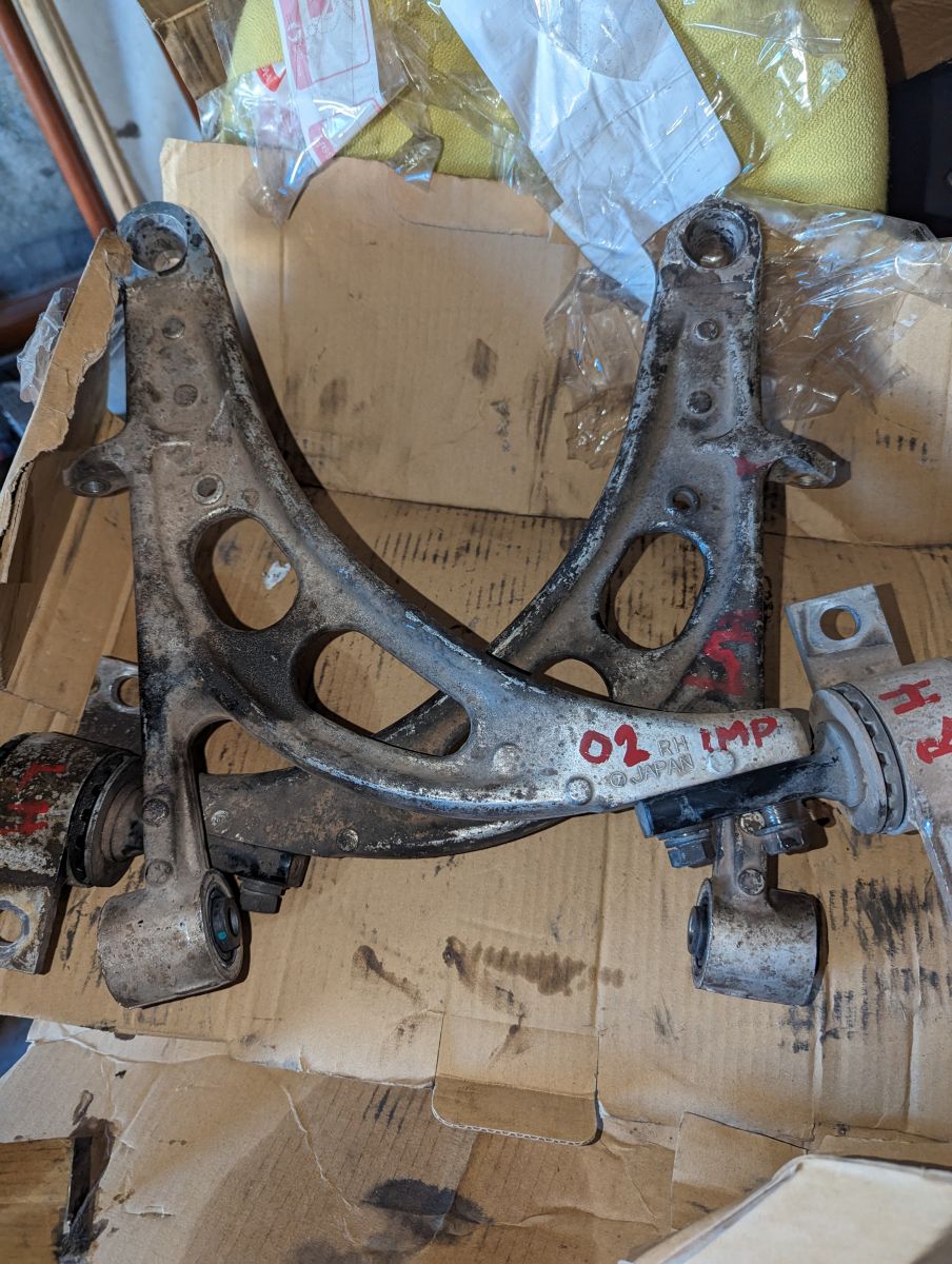

Ordered and received a properly sized set of bushes for the Impreza alloy arms that I initially bought for GX30 (they were supposed to be B4 arms), but they sent the wrong ones. These give extra track on the lib/leg chassis, but the bushes are also slightly wider where they slide into the subframe...
So the new correct sized bushes will be fitted, the freshened up Impreza arms will go on this car, and GX30 will get the arms out of this that I re-bushed back in 2015ish. The bushes on the steel arms on GX30 are knackered, and I'm chewing tyres as a result... but no point replacing tyres until I fix the issue.

Also picked up some new cap head bolts for the calipers, as the old ones that came with the brackets were a little rusty and looked a little ordinary. You can see one of the old ones in the post above. Fresh zinc coated ones will look much nicer.

Got the liberty/legacy bushes pressed into the impreza arms this arvo. Plan of attack tonight is to fit them to the car and remove the arms for GX30. Then finish off the rear arms, brakes bled, and get it all back together so I can pull this off the hoist and put GX30 up there. Photos incoming with the next post once all this is done.

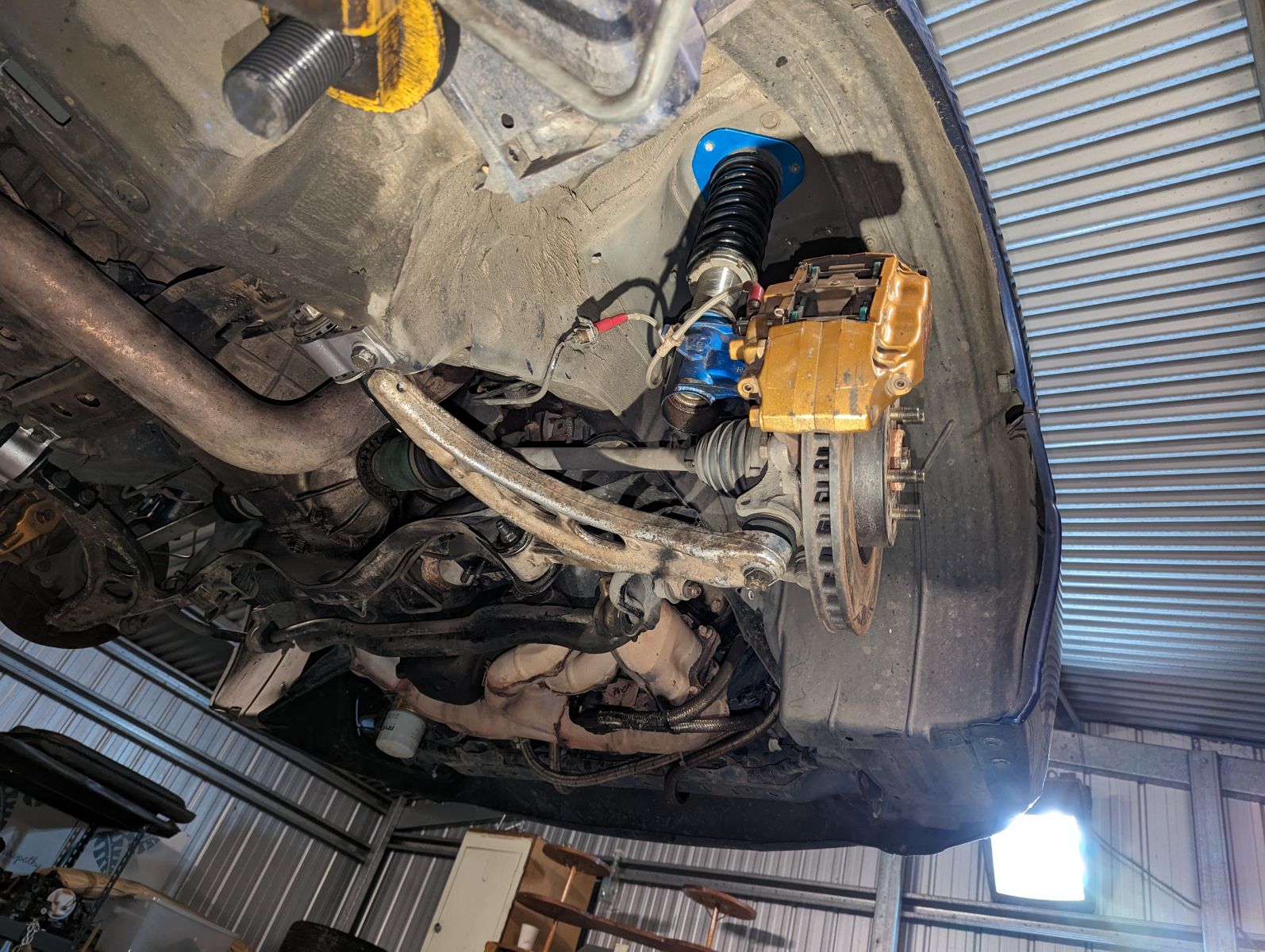

Ok, so after 2 nights plus an afternoon in the shed working on this jalopy, she's finally getting close to being ready to come off the hoist...
The front Impretzal LCA's are on, and everything is nice and tight.
Rear arms are now completely together, and after quite a few pull it off, put it back on sorta deals, its all looking good. Had to run some taps through a few threads as they had started galling up.
Bit of a better photo showing how much material has to come off the arms

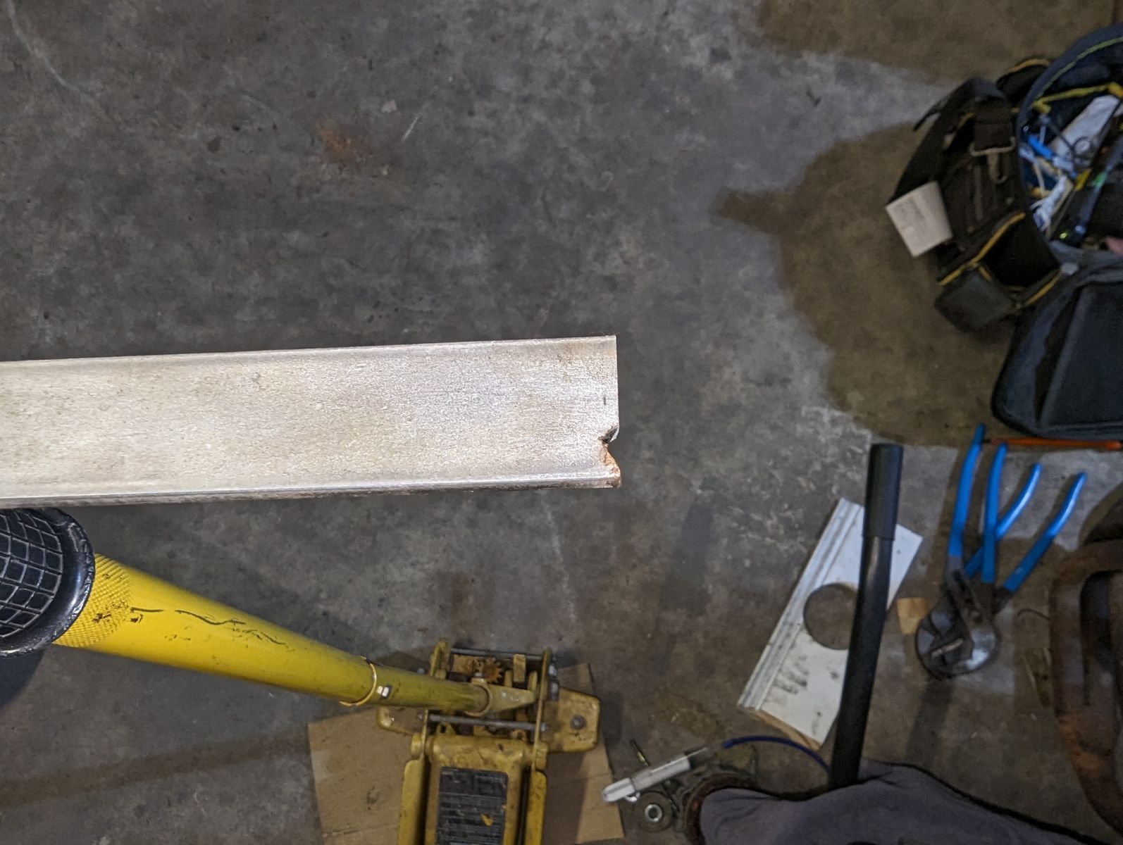

Made the appropriate "tool" to be used as an abusive C spanner out of 5mm thick 316L bar.
Worked a treat after a few heavy smacks to the rusted solid height collar...

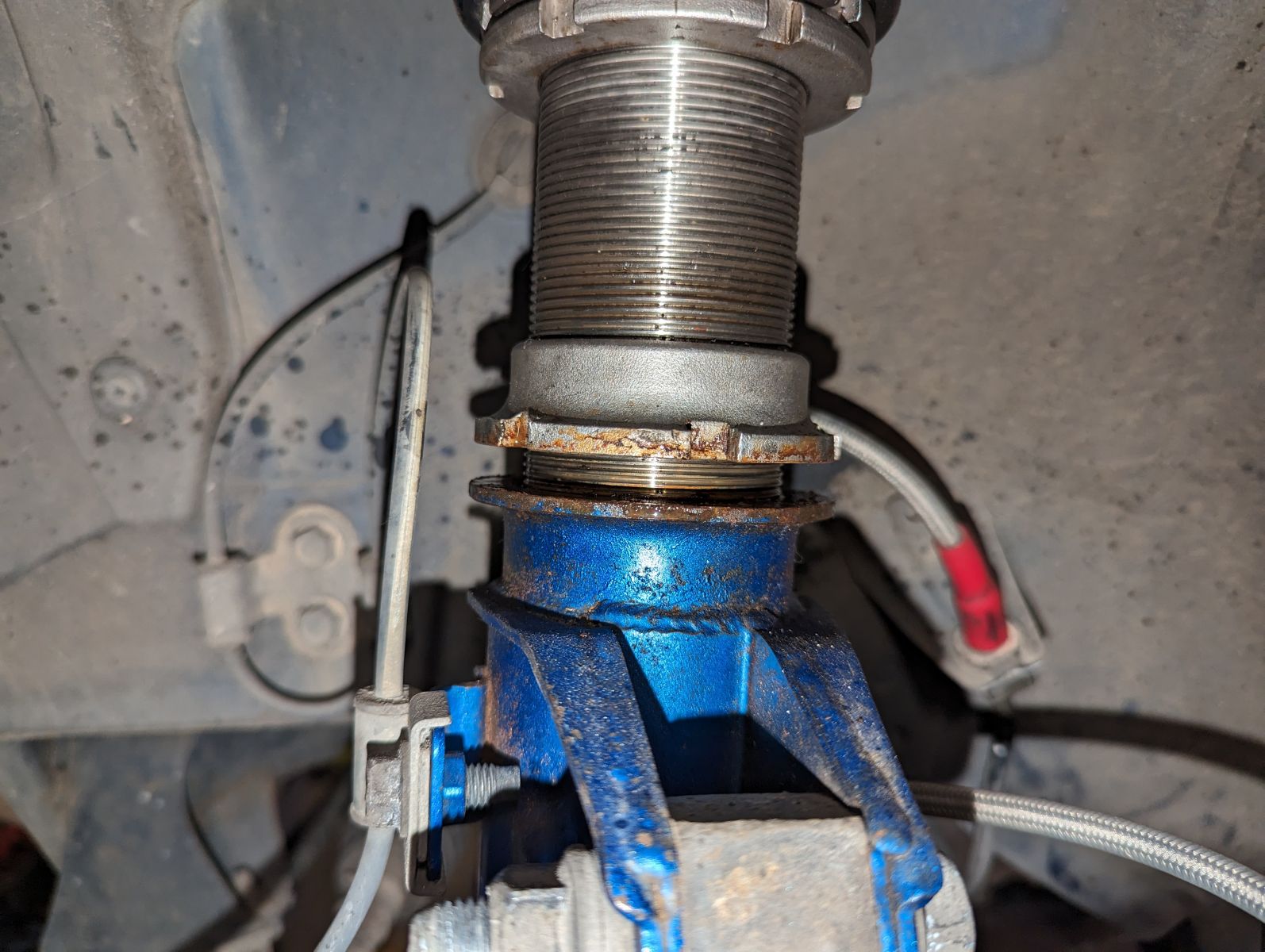

Cheers Jase, its been a mission, but I'm slowly kicking some goals! Next attempt on this will be trying unlock the height adjustment thread from that rusted up coil.
I haven't tried it yet, but I'm thinking that the rust will have probably penetrated into the threads and locked them up as well, not just the collar... but we'll see in due time.

Start soaking those threads in WD40 etc now, you have probs done this already.

Yeah, all over that side of it Simon! Hopefully a week or so of soaking will be enough... Hahaha, this one will! Just no tongue in it. Using it as the tow point, as the plans I have for the arse end will render the stock ones either side inaccessible. Still a work in progress there though.

Giving the strut a healthy dose of time to allow the penetrant to go to work but. With any luck it works well and I can just undo the lower bolts and spin the lower mount down a bit! But we'll see how that goes, I'm not holding my breath there!
