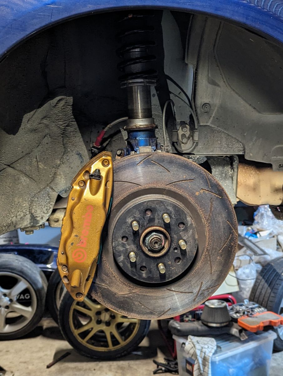

One corner mostly done. Haven't bled the brakes yet, but will probably wait until I've done all 4 before I do that. Was thinking that there probably isn't any point doing the rears yet as I still have to change the trailing and upper control arms when they rock up (I'd think judging their usual timings, probably in 3 weeks or so), so there's not a lot of point to putting bigger brakes on that are just going to get in the way for that job.
And just for size comparison, check this out!
277x24 vs 326x30
Just a slight difference lol

That’s a huge difference in brake size!
Any reason why you didn’t wait to do all the brakes at once when all bits that get in the way are present?

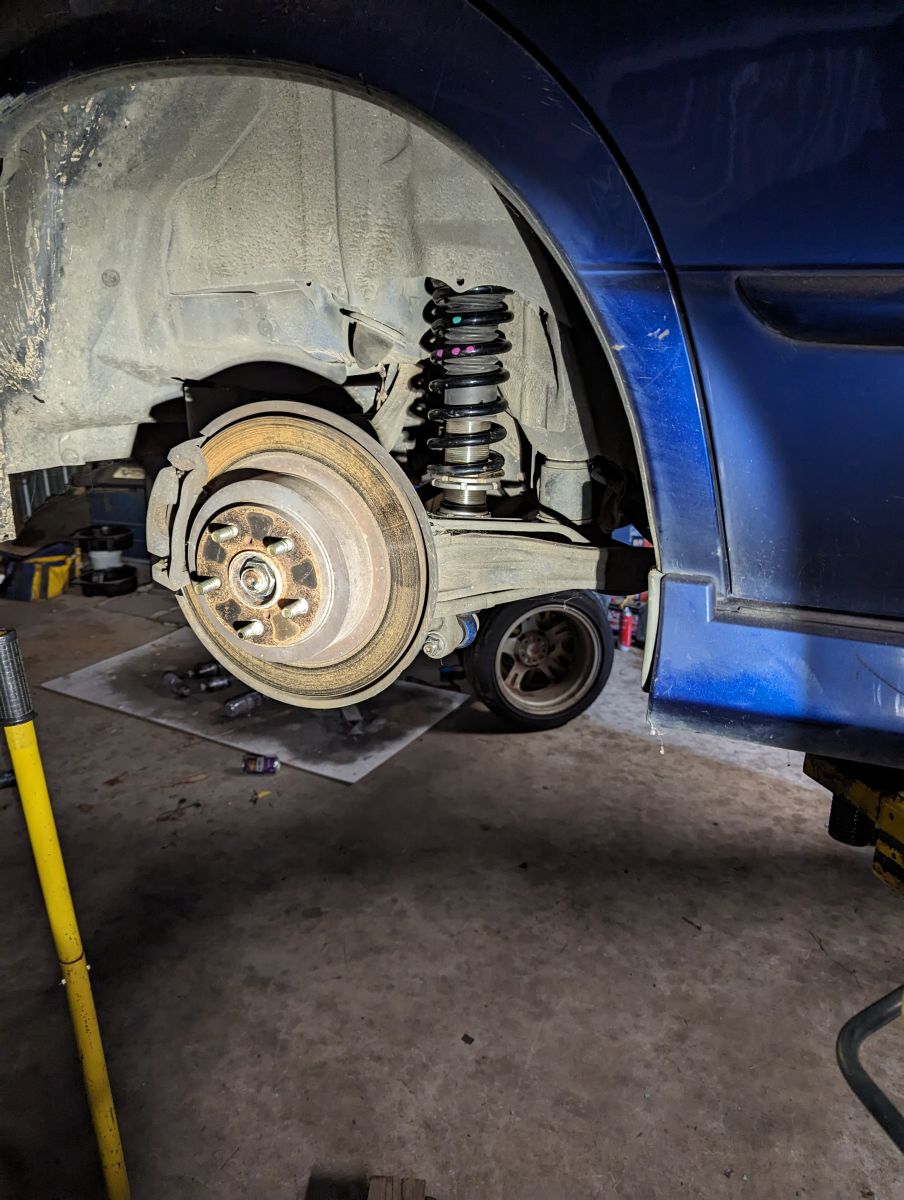

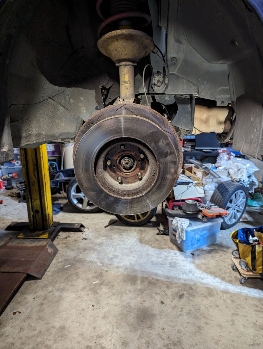

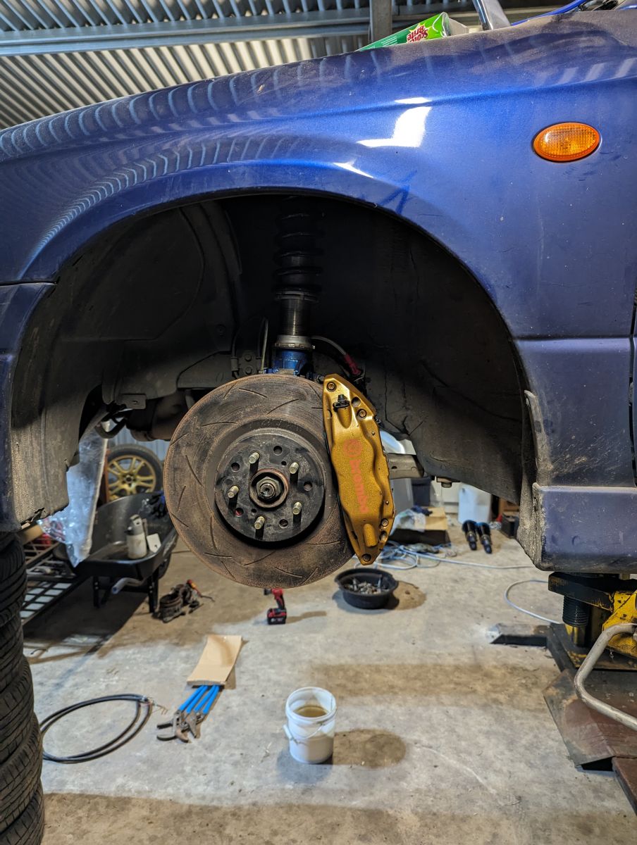

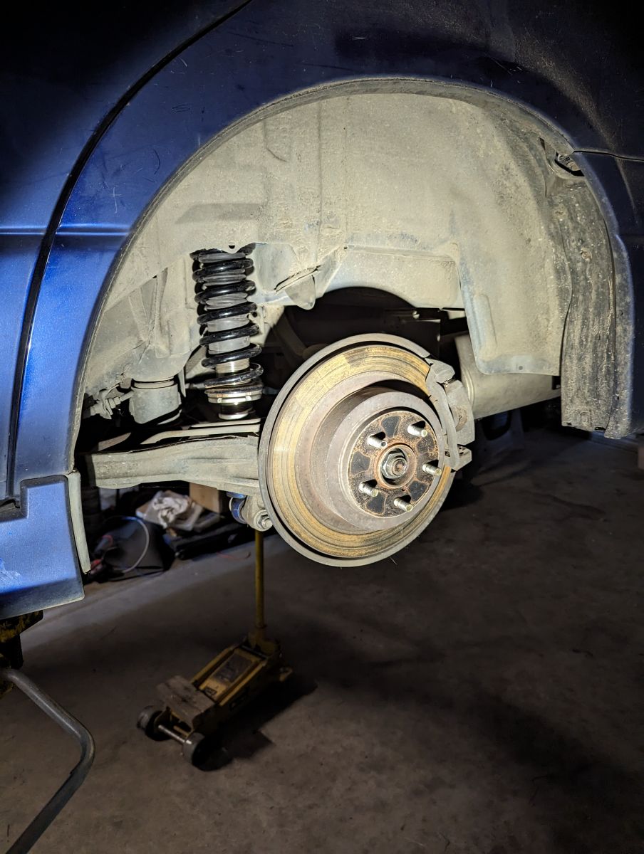

Another small update. The other side front has been sorted out. not quite sure how I'm going to go with the coils height wise, but hey. I'll deal with that later.
Rear coilovers have also been installed.
Tried to set the rear coils to about the same height before I put them into the car. Fronts are just going to be a suck it and see sorta deal.

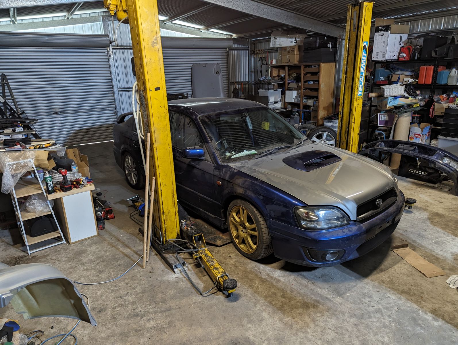

Coilovers work a treat, and despite being very low, still have good control and rebound with me jumping and bouncing on the car. So should hopefully be quite nice on the track.
Put the wing back on after finding out the other wing I have actually has broken mounts. Plans are afoot here as well, more on this once things get locked in properly.
Taillights and the rear garnish got put back on today as well, as it will spend some time in the back yard over the next day or two while I pull another car in to be stripped of useful bits. Bonnet was refitted and it's starting to look like a proper car again!

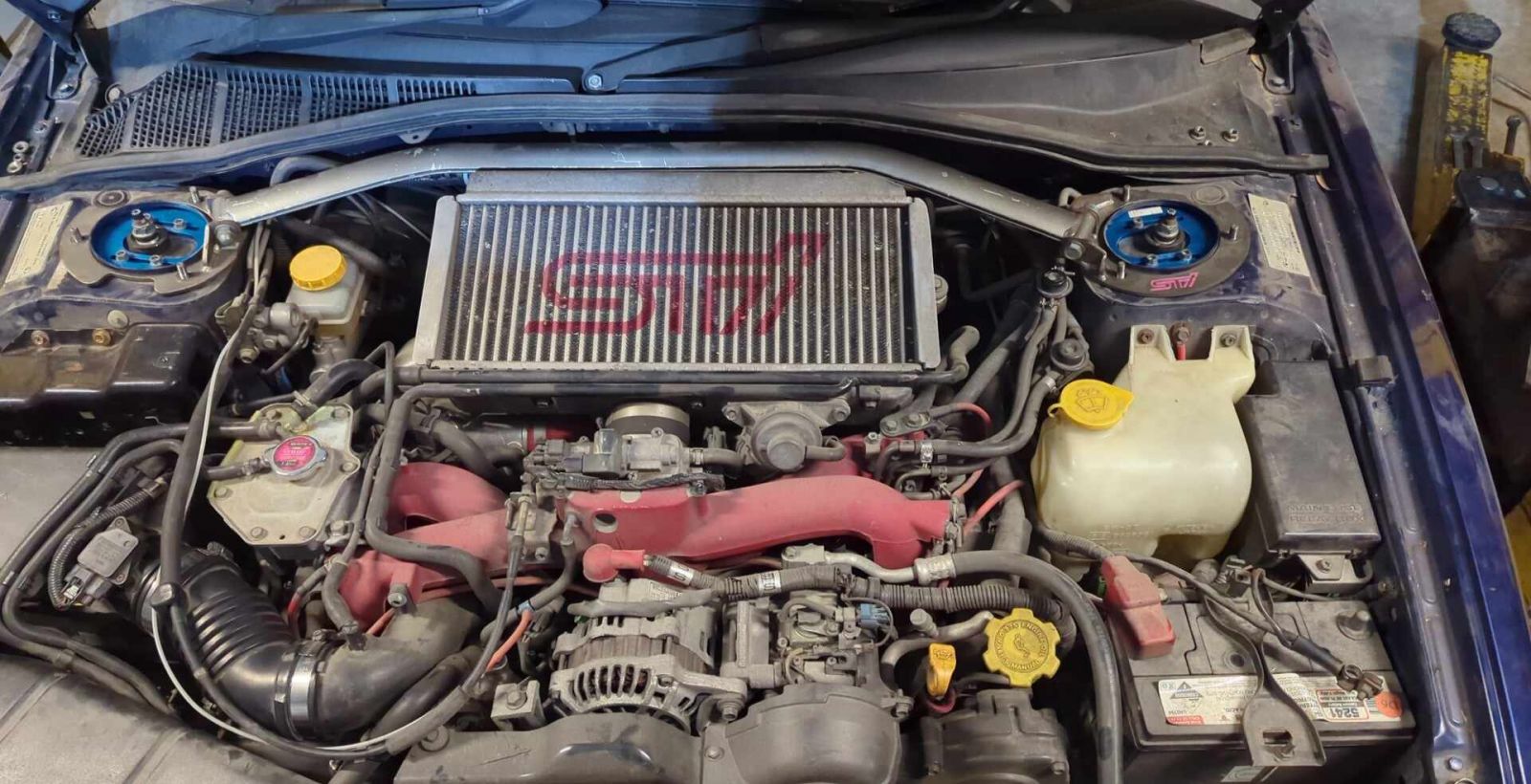

Now has the S401 strut brace fitted up as well. Really wanted to put the Ganador Titanium one on, but found out tonight that it fouls on the STi cooler, which is painful. So, the STi brace was removed from the wagon and the ganador one fitted to the wagon.
Turned the key and she started first pop, even with a half dead battery too. She's running a little rough at the moment, but she runs. Could be stale fuel, or any other myriad of things, but I figure it's gonna get a retune soon for corn juice, so I'm not overly concerned just yet. Still idles and everything, there's just a bit of a miss there. Can certainly say a Walbro is bloody noisy when there's no back seat or covers to provide sound deadening!

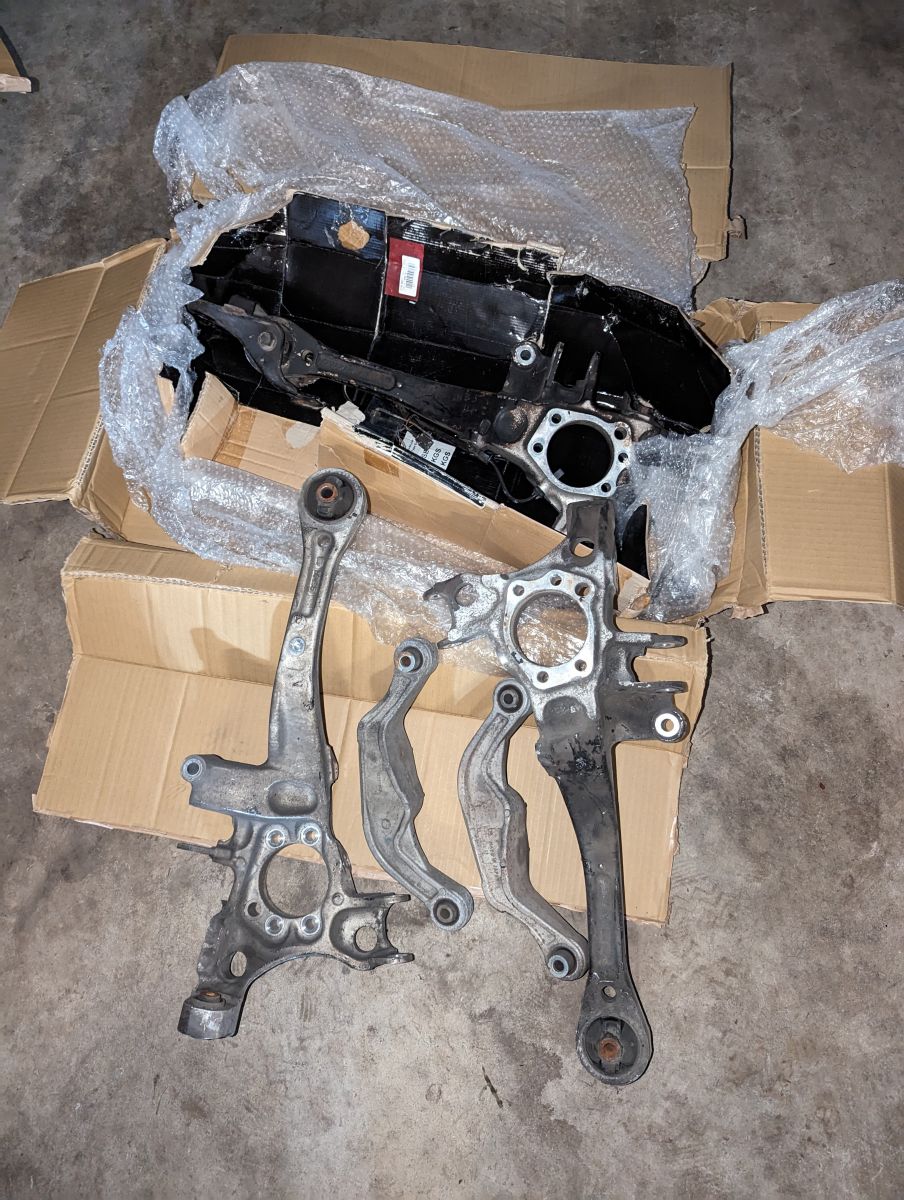

Had the majority of my next round of parts rock up for this yesterday. Will look into shed work over the next couple of weeks to get them fitted...
Still got the alloy diff mount on its way, stuck in sydney awaiting customs clearance by the tracking. Will fit the rear brembos once these are fitted up...

Seems these Gen3 alloy arms are all the rage at the moment! Might have to get me a set just because…

Only problem is the ABS sensor is different on the gen4, Maybe you can modify these to work with the gen3 sensor.

Yea, they are a fairly interesting upgrade nowadays Bennie, although the gen3 never actually got alloy rear arms. The gen4 ones just fit with some machining for the different ABS sensors, removing a shiteload of weight in the process. And the joy I have, is I'm not going to be running ABS, so I don't need to worry about doing that extra work.
