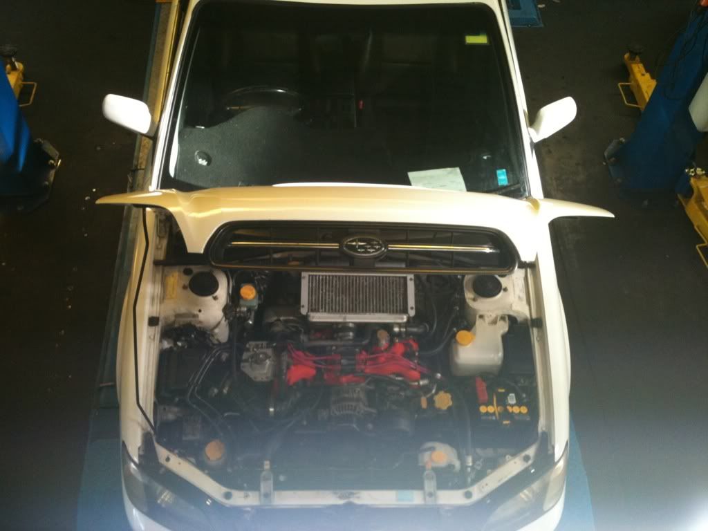

Also, snapped this up at the workshop on my iPhone.

here's a big tip for you. get rid of the plastic BOV if its still there (can't really see that well in the pics).
I ran one just after my old conversion and it leaked like a mofo.
if you get an my99/00 top mount aftermarket bov adapter piece and place it in reverse with some hose you can run stock metal BOV from 99-00 which are bulletproof.

Ahh, thanks Alexxx. Yeah its just running the stock black bosch one that sits just undsr the cooler. To be honest, I was thinking of just grabbing one of those adjustable plumb back turbosmart jobbies. I had one before and it never leaked. Won't be for a while yet though.
