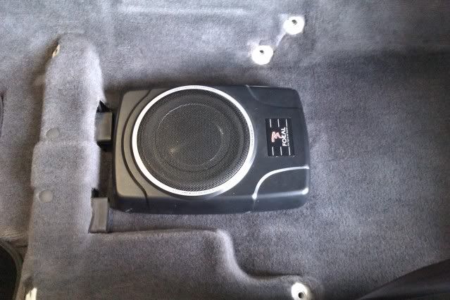

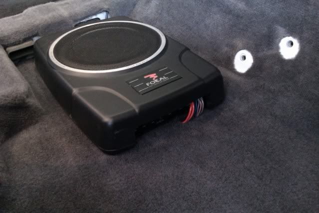

Focal BUS20 under seat sub installed.
All wiring under carpet for that OCD neatness. :lol:
Sounds alright, havent really played with it yet. Realised it didnt come with the remote bass controller. Ordered one, $47. :D

Your carpet is clean.
Interested to hear what you think! (of the sub)
How much was this sub? Cheers

This retails for $480. I bought it off Ebay 3 months old for $220.

Let us know what you think mark. Thinking about one of these for the foz but if it falls well and truly short of a normal subs then I think I'll pass

yes very interested in the hole sub under seat, love to know how it goes

I'll get the sub remote hooked up and then take it into my mates car audio shop to get him to get the settings spot on.
I just didnt want a sub in the cargo area but wanted a little (not a lot) more bass.

Nice choice, I run two under seat subs as well so it doesn't get in the way of the cargo area.

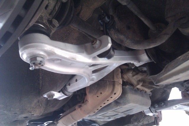

Im in the process of delifting the outback properly.
This requires removal of the spacers all round, Liberty steering column and knuckle, shorter bolts for front and rear crossmembers, Liberty trans crossmember, Liberty rear swaybar to chassis mounts and alloy control arms to finish it off.

Picked up the Liberty steering column, knuckle and auto crossmember today.
All other required parts are on their way from the States from Chaplins Subaru.
Should be delifted in two weeks time. :D

#299 CRUISN
Posted 09 July 2012 - 07:49 PM

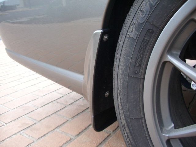

Outback specific parts removed and Liberty parts installed with alloy arms.
S/h factory Outback mudflaps located and purchased. Colorcoded...
