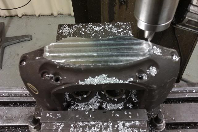

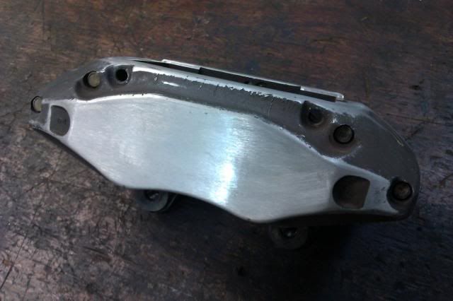

Sneak peak at the Nissan fronts I started the day before holidays.....

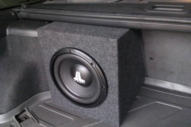

Stereo install completed.
Plastic and shitty tar removed.
Dynamat on the front doors to block all open area's, also section installed on outer door panel behind speaker = Massive improvement in bass from front speakers and decrease in road noise.

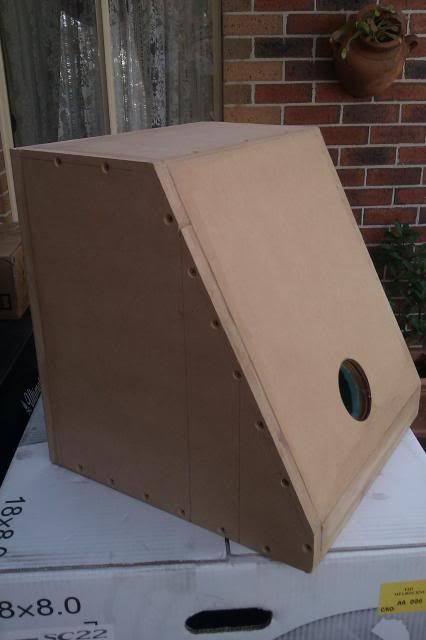

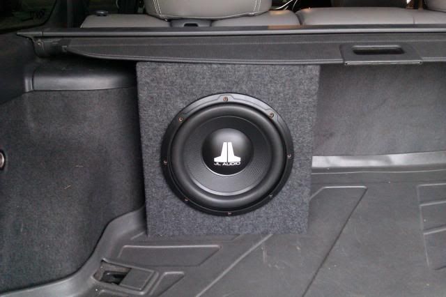

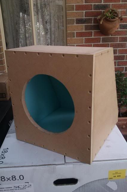

Designed and fabricated box to recommended internal dimensions for sub and to sit snug against back seat under cargo cover and within area of 40 seat so 60 seat can be folded down for boards.

#607 Hypnotic
Posted 16 March 2013 - 07:27 PM
You irritate me with your awesomeness Mark!
Looks great as always, love the JL sub, looks like a W0v2 :)

I concur. You should make and sell custom boxes.
I wouldn't mind f'ing off the JL Audio box I have, that takes up half the boot.

Sweet. I assume you're some sort of mechanic?
How easy was it to make up the box? I've got a 15" MTX sub but my box is rooted... I've been meaning to make a new box but have never really sat down to plan and create it.

Sweet. I assume you're some sort of mechanic? How easy was it to make up the box? I've got a 15" MTX sub but my box is rooted... I've been meaning to make a new box but have never really sat down to plan and create it.
In the old days my trade was electrical "mechanic", but Im just an industrial sparkie, work in the beverage industry / high speed packaging.
There's plenty of sub box calculators on the net nowadays which makes getting the correct internal air volume calculations very easy.

I'll look into it. What materials did you use? MDF? What type of fabric did you use to finish it? Felt?
#619 CRUISN
Posted 20 March 2013 - 10:31 AM
I used 16mm MDF.
Carpet is sub box carpet bought from a car audio shop.

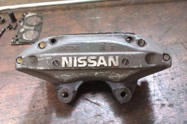

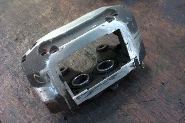

Mark, how much is this actually eating away at the sidewall thickness of these brake calipers?
They wouldn't technically be legal any more I guess.
Is all the metal you shaved off actually just excess metal to mount the nissan logo, or is it eating away the caliper sidewall thickness?
It's probably a negligible amount, but it looks like you've taken a fair bit off with that mill.
