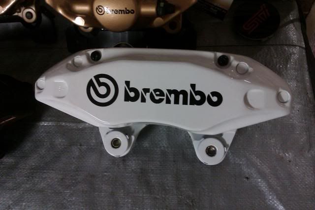

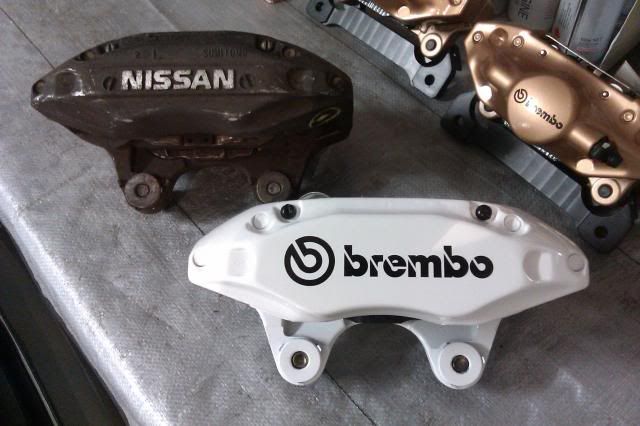

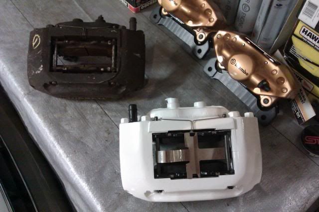

Refurbed a front caliper. Results are nice. :D
Looking to make the adapters next week.

Wow!
Why did you use Nissan callipers?

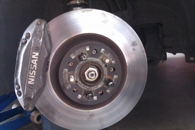

1. Cheaper than WRX 4 pots - Paid $180 for the fronts and they had new seals in them.
2. Theyre alloy and weigh about half of the cast iron WRX ones.
3. You can run a Brembo rotor in them, something you cant do in a WRX caliper.
4. Just beacuse I can. :P
Otherwise they run the exact same pistons and pads as WRX 4 pots but look nicer. The rears are also going to be Nissan 2 pots as they mount further away than the WRX 2 pots and require a small mod to my adapters to make them work with Brembo rear rotors.
This is a one off for me. ;)

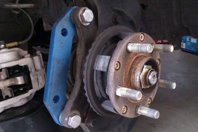

Front brackets finalised to mount the Nissan calipers.
Made a prototype out of nylon to check my measurements. Spot on. Running a 326mm Brembo front rotor.
I'll be making the final product this week.
