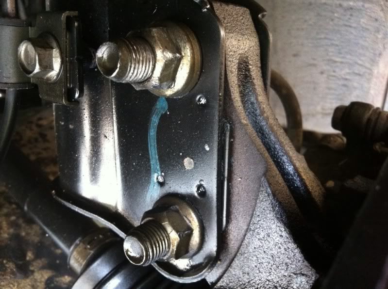

Cheers dude yea I have your number. Bolts have a 19mm head (guessing all Subarus are the same?)
I'm using a he. Spanner set but my sockets are normal. However, the sockets are useless cheap ones that were given to me to start off my tool set. Good for small things but not so good for these bigger jobs ;)

You've rounded them a fair bit already, mate.
Are you using a 6 sided hex set like Marv mentioned?
Morgan, you need bigger muscles. That might help.

I have a $500 gun and, even with a big fcukoff compressor behind it, my 18" breaker bar and a good single hex socket will beat it hands down. I ofter slide a length of pipe over the end for max torque.
Gun is handy for where you cant get in with the bar.
H..T..H..
edit: looking at the pics Morgs.
There is a fair bit of thread showing. Is the socket deep enough to reach the flare on the nut?
I only use a breaker bar on those. Never really a drama.
Also, WD40 will only help the socket to slip. Only really useful for rusted nuts after it's had plenty of time to soak in. (rust is porous, steel is not)

Tried putting heat into it?

Right. 2 things will help you.
Firstly, try undoing the bolt side first. Ignore the nut side and get the bolt spinning.
Secondly, what I'm about to tell you won't make much sense, but it will help you. I've done this on large-frame bolts like those 19mm ones and it does help. Tighten it.
Lean on it to try and tighten it very slightly. The aim of the game here is to get the bolt/nut moving.
PS: Lefty loosey, righty tighty ;)
PPS: You need a big breaker bar and socket. Do not use shifting spanners as they're ALL shit.

Just tried the rear ones and the top ones budged ever so slightly but the bolt ever so slightly spins with it.
With the force I'm using to budge the nuts, I have nothing left to hold the bolt still lol
THIS.
I think the dremel is the answer...
FARK THAT.
You will go nowhere unless you can hold the bolt head. A ring spanner is fine for this, just let it jam up against something (ie inner guard) so it will hold.
You can do this.
USE THE FORCE YOUNG ONE.
