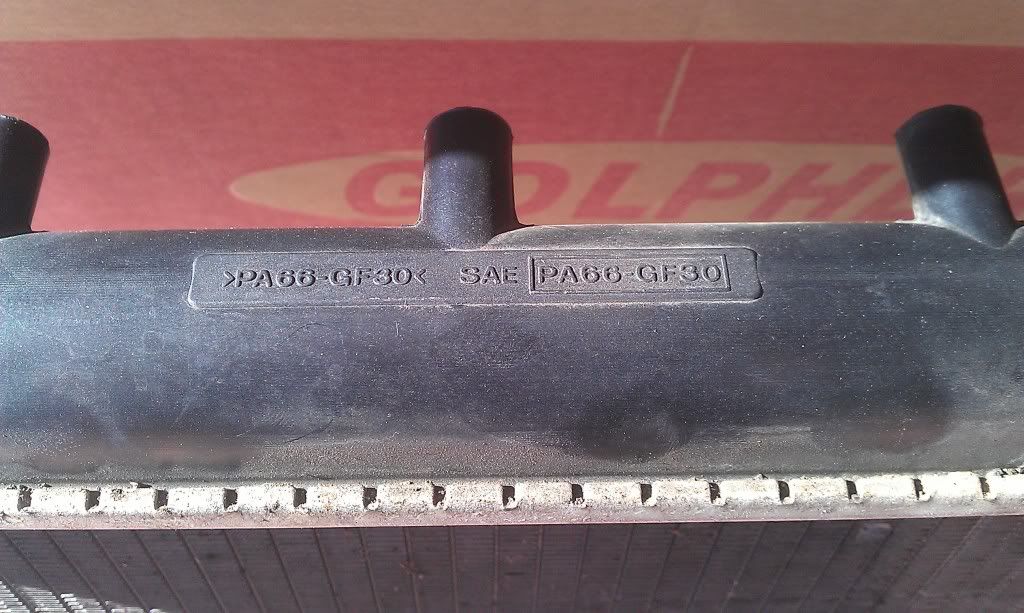

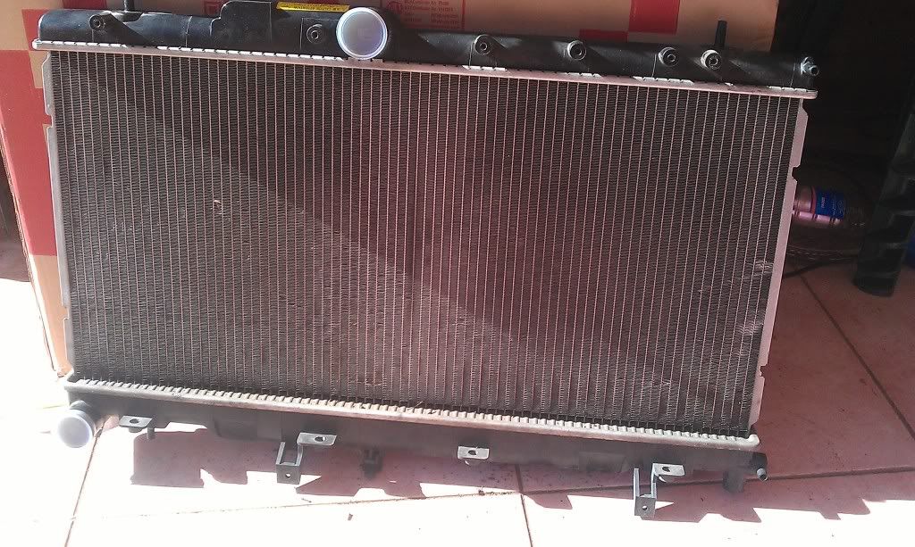

Warranty? If not, Narellan radiators charged me $200 for a new adrad radiator a few weeks back... Seems okay!
#22 migoreng
migoreng
  • 557 posts
Posted 18 April 2013 - 09:34 PM
Yes warranty. I'll see what the eBay seller can do for me tomorrow. If he can tell me where the warehouse is, I'm happy to go and swap for a replacement.
Why me? -_- radiator worked well for almost 1000km...
I'll give narellan radiators a call..if they're quicker ill get a refund from the eBay seller.

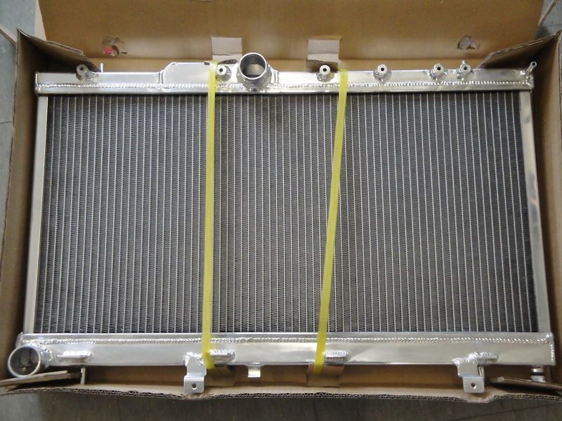

What do you guys think about a full alloy radiator? The existing hoses, screws, mounts should fit without issues right?
BRAND: GOLPHER
MODEL: SUBARU LIBERTY B4 TURBO
Year: 2001-2003
TRANSMISSION: AUTO/MANUAL
CORE SIZE: 340 x 686 x 26mm
MATERIAL: ALUMINIUM TANK / ALUMINIUM CORE
#25 aekOne
  • 10,349 posts
Posted 19 April 2013 - 09:02 AM
I've got a Golpher alloy radiator in the Foz and it's been really good. No issues what so every. And it looks cool ;)
#26 migoreng
migoreng
  • 557 posts
Posted 19 April 2013 - 09:17 AM
Thanks Aek, I'm upgrading to the alloy for $50...hopefully it will be fine for years...

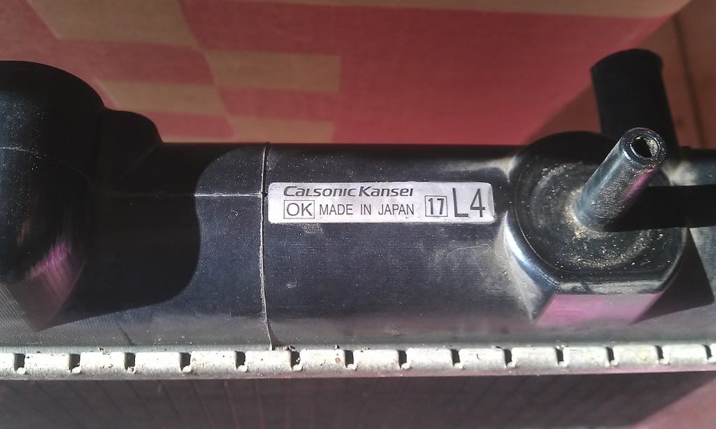

Asgaard,
Here are some photos of the Calsonic, not sure if that's the part number. Let me know if you need anything else.
