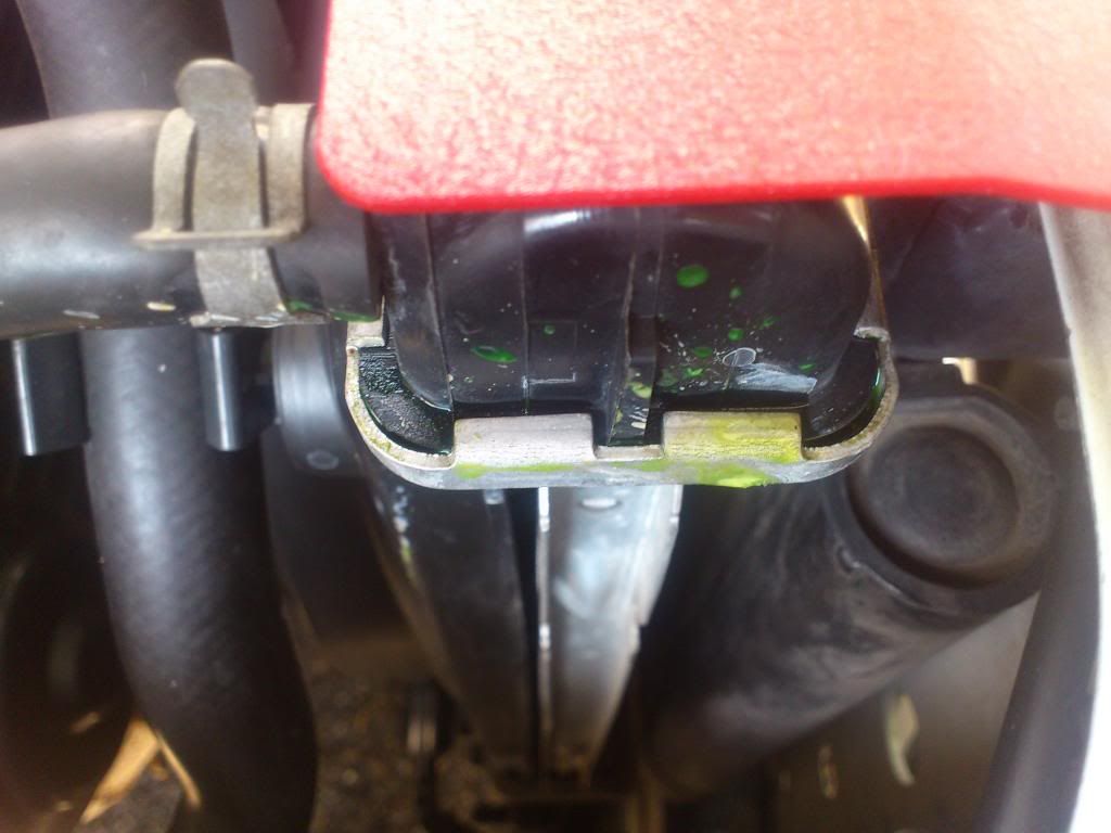

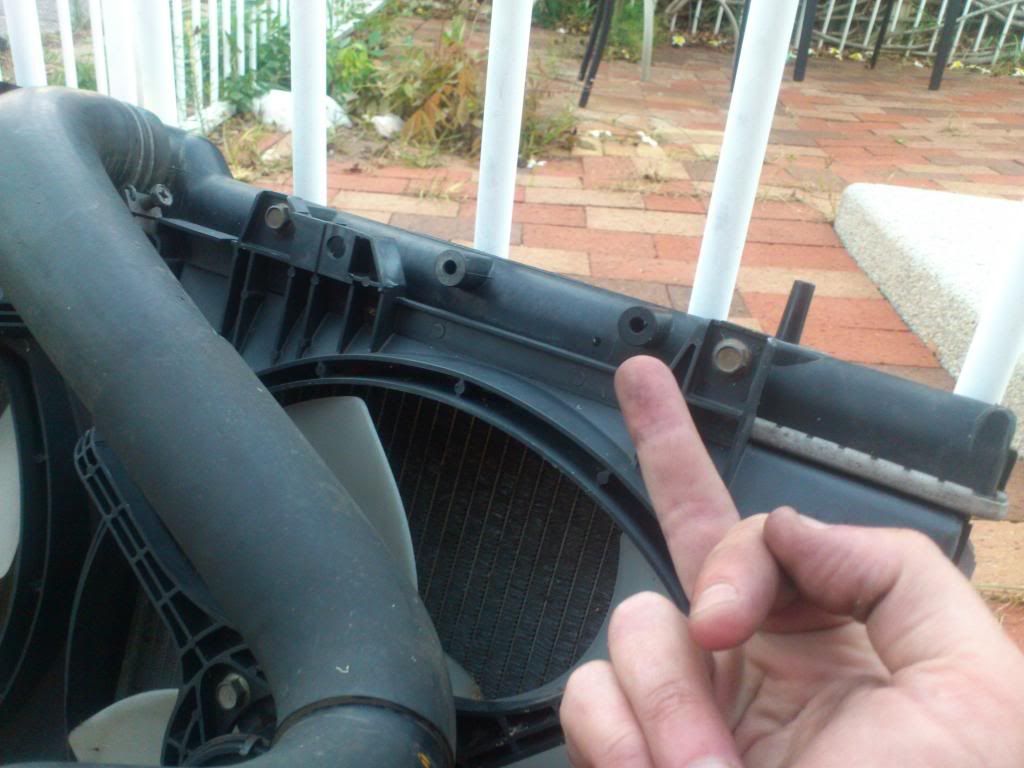

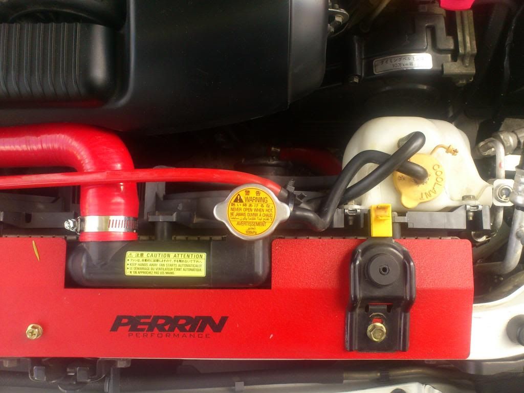

I noticed coolant leaking from the ends of the radiator the other day.
I was using a 1.3 bar STi radiator cap and I blame it for the damage.  Other contributing factors were obviously the summer heat, age of the radiator and sadly the way I bled the coolant system when I installed silicone hoses.
The system was full of coolant and there was some left in the funnel and I didn't want to pull out the funnel and have it go everywhere so whilst revving the engine I noticed the extra coolant would get sucked in.  I put the cap on whilst reving aaaaaaaaaaaaaand here we are. Too much pressure I guess and the STi cap wasn't allowing the excess to flow back into the reservoir bottle.

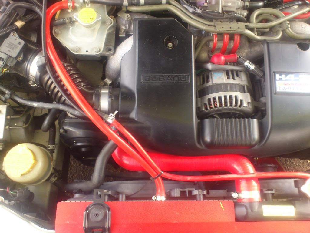

I had a spare radiator but it was from an Automatic Liberty so there was no return line plug on the top driver side and the fill cap was on top of the radiator.
Having 2 caps didn't seem like much of an issue really, just looks weird.  An extra hole would need to be drilled for the extra hose to the overflow bottle.
Not having a return outlet that connects to turbo coolant reservoir was a problem though.
My idea was to drill into the header tank through this bad boy and use it for the connection to the reservoir.......
So that's what I did.
I used silicone hose so it would stretch over the thicker new connection.
I also had to run a new coolant line from the turbo coolant reservoir as the metal return line that sits on top of turbo radiator didn't fit anymore because of the fill pipe on the replacement radiator.
Two return lines to the overflow bottle......
The other line plumbed in.....
It works fine and saved me from having to train it to work today.  Long weekend = no shops open.

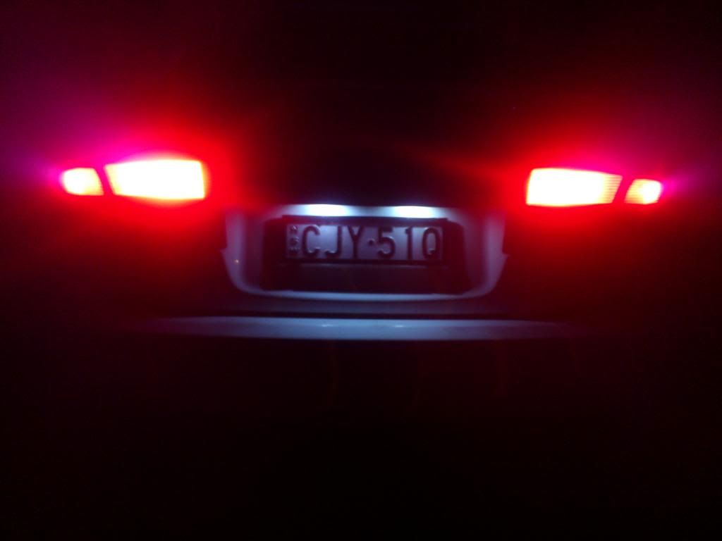

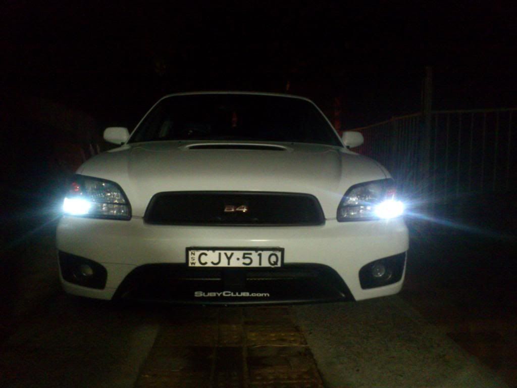

Heres a few pics I found of the led parkers and numberplate lights I installed a while back......
I love the white light.

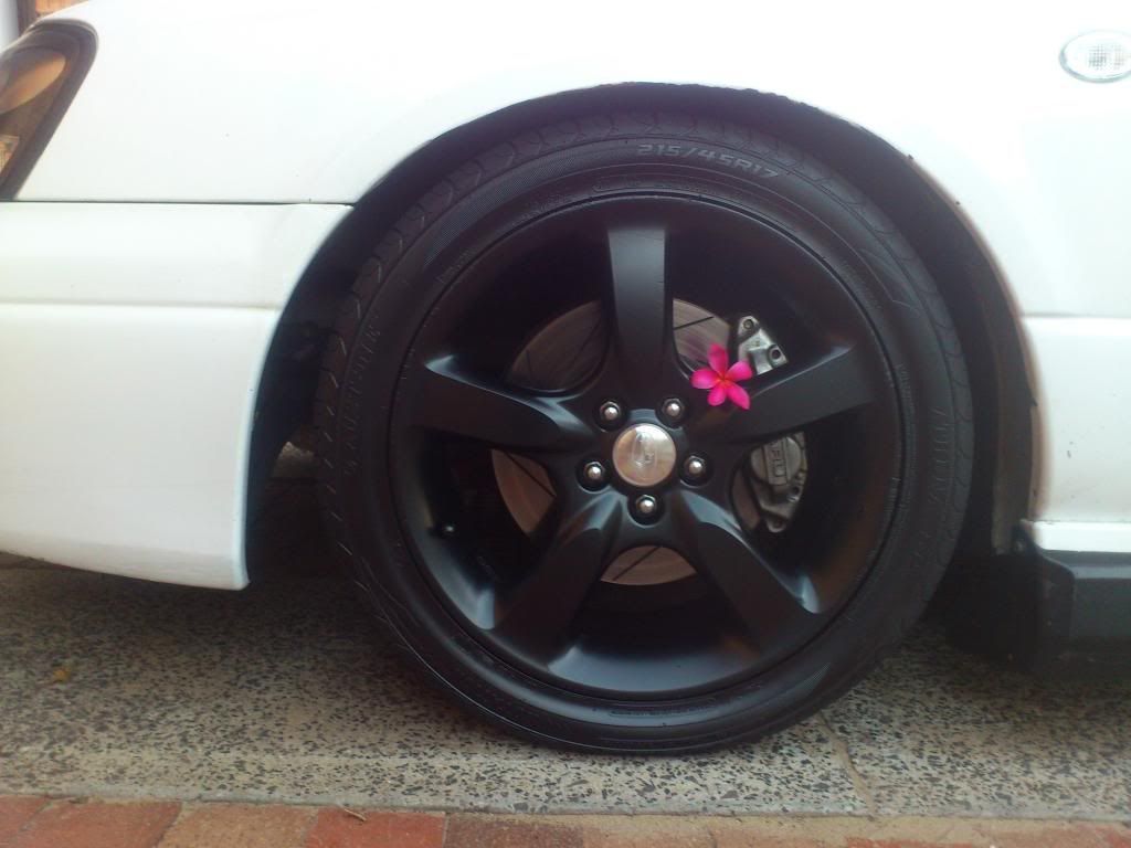

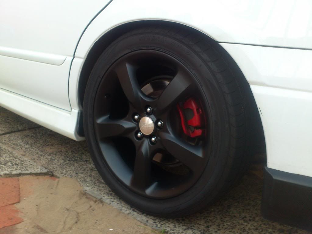

Painted my GT rims black Yesterday......
The center caps were left alone as I might paint the rims silver again when I sell them.

Did the rims come with a pink flower?
Lookin' good Josh.
#366 Zac
Posted 30 January 2014 - 07:49 AM
What paint did you use boss? 2pac or Plastidip?
#367 Guest_KONG_*
Posted 30 January 2014 - 11:10 AM
Lookin' good Josh.
Finally!  Someone commented on my frangipani.  :D
Beautiful isn't it?
I used export satin black spray cans Zac. I didn't even mask up the tyres because no fucks given lol. Just a quick paint job to hide the horrible gold that was making me feel ill every time I looked at the car.
I'm just using up the tyres for the moment and restoring  my 18's.  I'll be selling them once the 18's are are done.  I won't get any extra cash for the tyres so may as well use them up first.
#368 Liberty
Posted 30 January 2014 - 11:46 AM
It is. It has a very vibrant colour.
#369 Zac
Posted 30 January 2014 - 12:13 PM
I wanted to try to restore some wheels but got talked out of it... apparently it is a tanker full of work... and I don't have that much time... LOL
#370 MrSober88
MrSober88
  • 971 posts
  • Location:Canberrra
Posted 30 January 2014 - 04:27 PM
The rims look really good! I might have a go at doing the rims on the GTI
#371 Guest_KONG_*
Posted 30 January 2014 - 08:10 PM
Satin black is freakin tops paint man.
I'm going to hit them with clear now. I reckon it will make the finish more on the gloss side, but the finish of satin black on it's own is awesome..... such a flat, even coloured base to work with.  It hides minor imperfections and goes on so easily.  .

Black rims look soooooo good man. Impressed! I want to do something similar? Will paont flake off etc?
#373 Guest_KONG_*
Posted 09 February 2014 - 09:57 AM
Not if you clean and prepare the wheels. The satin black does fade over time and gets a grey tinge to it. The best thing to do would be clear coating them & I noticed Repco has cans of clear for wheels. Think they were around $20.
I think putting clear on them would take away from the matt/satin finish and make them more glossy.
#374 mark300
  • 3,067 posts
Posted 09 February 2014 - 10:50 AM
you can get a satin clear coat, i got some from super cheap auto when i painted the rims on my liberty last year. gives you a little bit of shine but no where near the amount that a gloss does

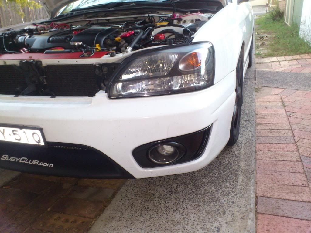

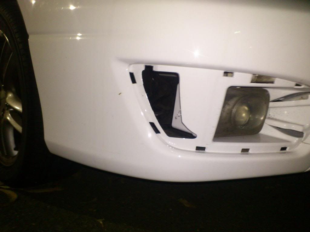

I updated the fog light surrounds from RevD to RevE. Some cutting was required for the vents in the RevE covers. I used a large cooks knife to cut the bumper. It was so easy and it cut smooth straight lines. It looks better than the pic below which is the factory cut. Looking shitty right there SUBARU! Bits hanging off and stuff... pfft.
The new covers fitted.

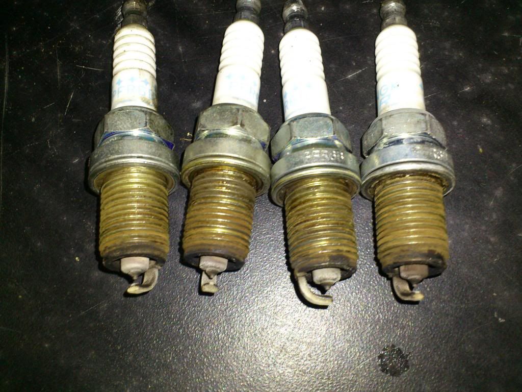

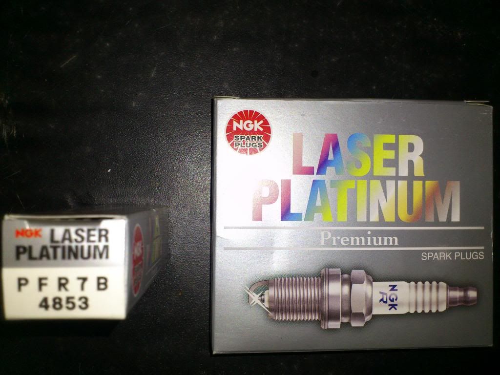

New plugs.
The old ones.....
These ones were in the engine when I did my conversion. This is the first time I've changed plugs since then and they have seen 45000 kms. It took about an hour and a half to do which I thought was pretty good for a first timer. They don't look too bad considering.

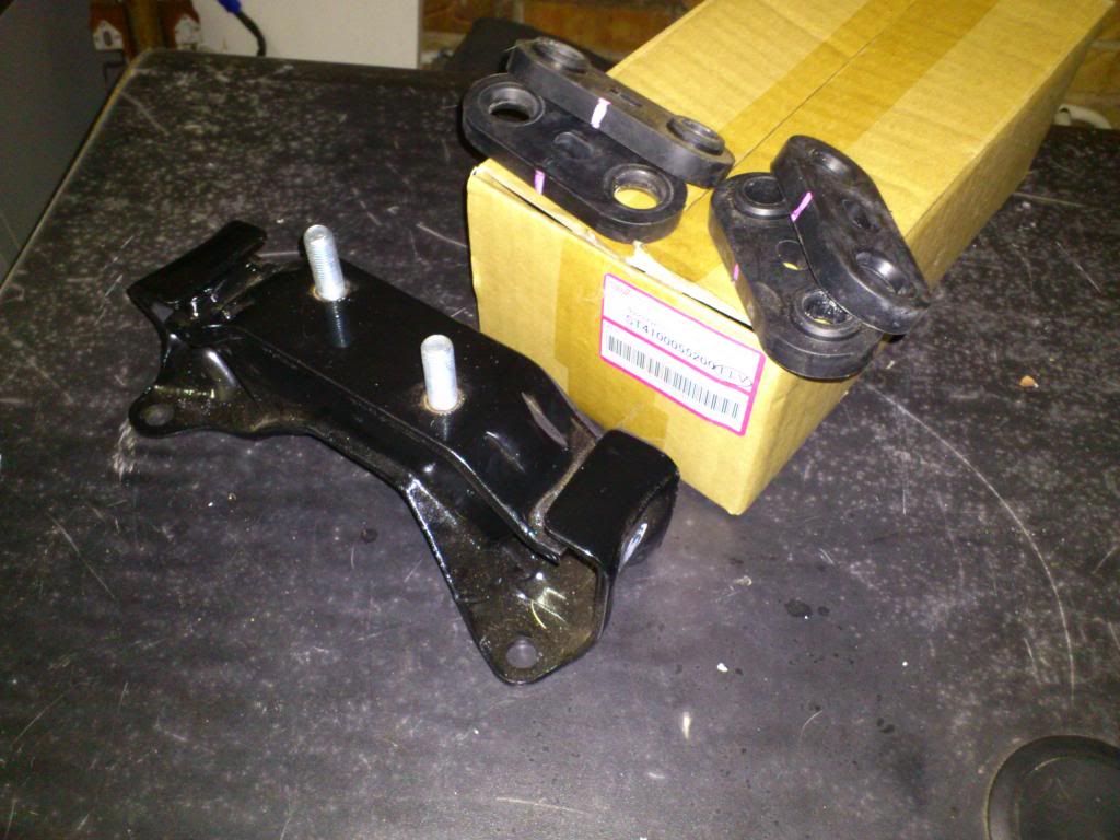

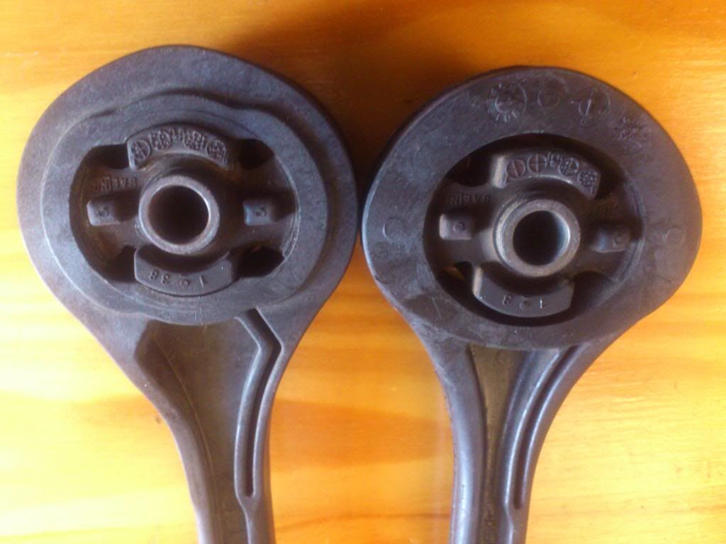

I was noticing some drive train movement so I swapped out the pitch mount. The old bush has a fair bit of room to move compared to the replacement.
Today I will be adding some more pink bits to my ever growing STi part list.  I'm such a sucker for the pink badge.
Hopefully the backlash will be sorted after that  ;)

Group N trans mount? I've had one on my shelf for >6 months haha, let me know how it goes.
#380 Guest_KONG_*
Posted 02 May 2014 - 10:00 AM
Yes Group N.   Hahaa same. I bought it off Sam about 6 months ago.
