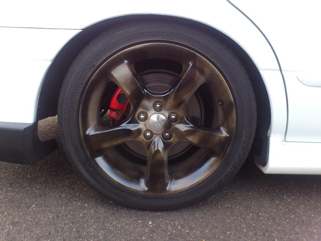

New look.....
Because beer & paint.  Rat rod yo.
#347 Robert
  • 9,419 posts
Posted 11 January 2014 - 06:43 PM
I think we need to see more to get the whole effect.
#348 Guest_KONG_*
Posted 11 January 2014 - 06:52 PM
Drink a beer and then look at it.
Looks great from where I stand. :D

I love the wheels.

I love the wheels.
Hahaa they're so shit .

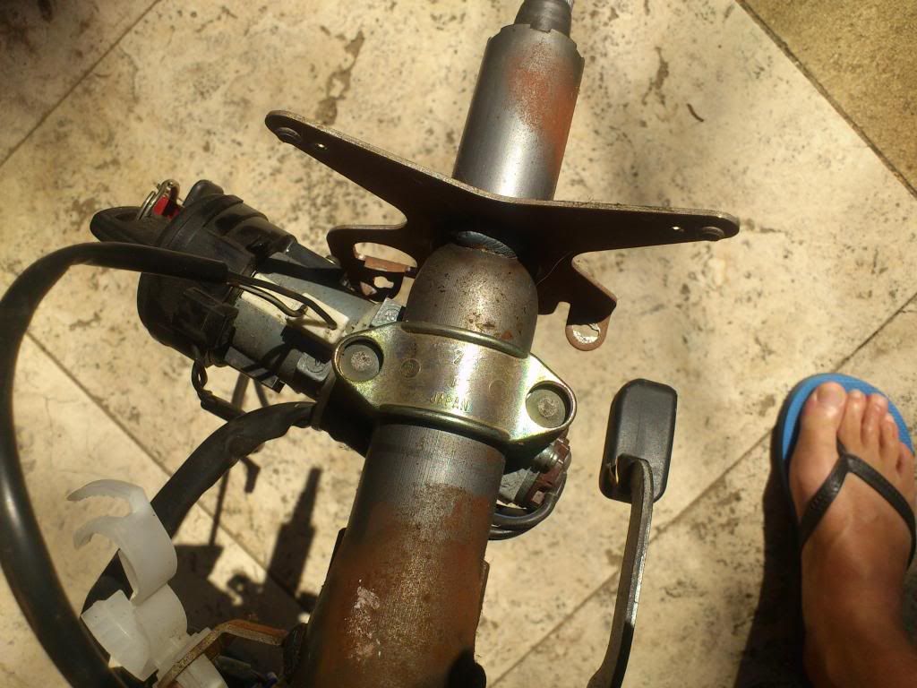

I have to do my clockspring also, doesn't look like a very hard job. But I have finally sourced myself a ignition barrel also so will be changing that over at the same time.

Looks great.
Thinking, of also spraying the air dam but maybe just the B4 effect. only the bottom not all around :P
#355 Guest_KONG_*
Posted 13 January 2014 - 09:04 AM
Looks great.
Plastidip/armorall protectant is great stuff mate. Use electrical tape for masking and spray the masking line so it's wet just before you remove the tape.
Your car is still looking the goods, still very jealous of how your engine bay looks.
Yeah the clockspring is a peice of piss mate.
I just checked out a Gen 3 column I have in the shed. Looks like a shit job!!!
I'd rip out the whole steering column and do it on a bench. Looks like you'll have to drill out the screws too.

Plastidip/armorall protectant is great stuff mate. Use electrical tape for masking and spray the masking line so it wet just before you remove the tape.
Yeah this was the mistake I made, i peeled the tape of when the dip was dry, bad move.
#358 Tim.
Tim.
  • 2,024 posts
Posted 13 January 2014 - 12:10 PM
Yep totally different to paint. I found i could run a blade around the mask line and score through the plastidip to get a clean edge.
Going to give it a shot, I asked Subaru and they wanted $899 just for the barrel without install. So figure I should give it a shot myself first as its not a big job, just annoying. It will be good to be able to jump in my car, put the key in and just start it. I look like i'm stealing the car everytime I have to start it hahaha.
All because some low life drilled out the barrel.
