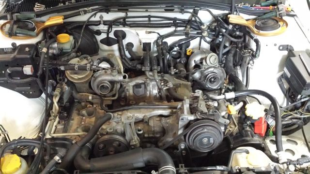

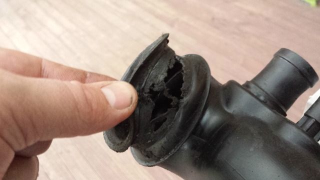

Posted 29 May 2016 - 09:33 PM
Been a while since I needed to swing some spanners on the GTB.
Pulled the intake manifold off as I could smell some fuel on the drivers side. Didn't find anything untoward but the brittle PCV pipe broke in the removal process and the PCV pipes were hard as fork and the intake pipe was split on the secondary inlet so all new parts enroute including all gaskets.
Turbo's are nice and clean and no play so that's good.
#1540 Guest_KONG_*
Posted 30 May 2016 - 05:12 AM
Well hopefully that's the source of you reduced performance lately.
