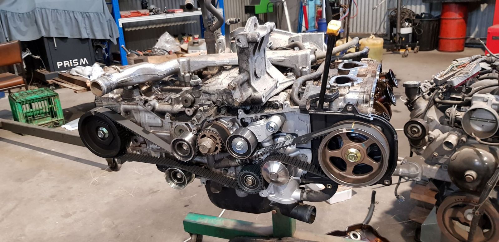

Well, time for yet another update...
Parts arrived on Tuesday.
Spent another 6 hours on her on Sunday. Heads removed, Gaskets changed, new water pump fitted and new timing belt installed. Engine was put back together and is just sitting waiting to be put back into the car.
Once the engine is back in the car I'll give the engine bay a bit of a clean up with the pressure washer. Have to clean up old oil leaks and things like that for the roady. Will be wiping down things while the engine is out, but would rather clean the top of the engine etc once everything is back together, less chance of getting water in places that shouldn't have it.
I didn't think I did too badly to have all that done in 6 hours. I can see how with a little more practice, it could be done much faster.
Ben

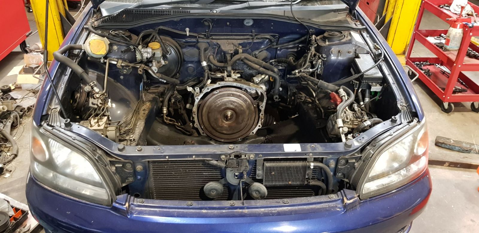

Well, its been a while since I've posted on this, and those who have been paying attention on club lib or subyclub facebook will know that that on re-installing the engine I made the rookie mistake of not rotating the crank as it slid onto the box, leaving a gap of about 5 to 7mm between the box and block. Knowing how much of a pain it was to separate initially, I decided tighten it up on the bellhousing bolts. Not a good idea, and once everything was nicely seated, there was a very loud crack, and a full quarter of the bellhousing broke off the engine...
So. Not only had I proper broken the engine, I was fully expecting to have a broken gearbox as a result of forcing the box onto the motor, smashing the oil pump.
Heres where the advantage of the stripped B4 comes in. Got another short motor off Chris, and proceeded to put my heads and associated bits onto it. Gearbox and LS diff from the B4 has found its way into this. Had a few curves to get round like cutting down the auto brake pedal and installing my old clutch assembly. Then of course the wiring headf@#% of making everything work with the manual box.
But. Everything works, and I've just got a couple of little bits left for roadworthy.
I'll post up some pics when I get to it.
