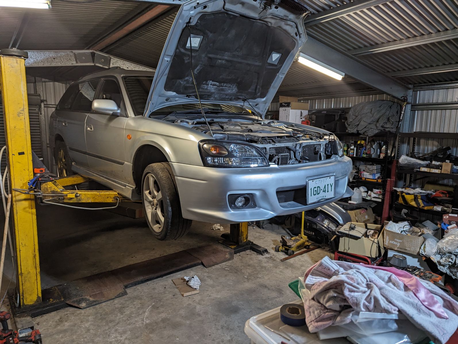

Last night was a good run on this jalopy. Got it into the shed ready to be hoisted in preparation for when Seb finally went down for the night.
The Ganador Ti front strut brace was swapped a night or two ago with the track car, as the Ganador one didn't clear the massive STi TMIC. Looks pretty understated in this engine bay.

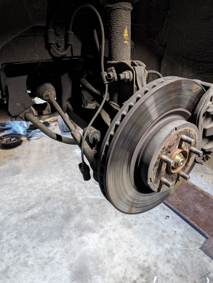

Pulled the front wheels off so I could start the process to replace the lower control arms. Had a quick look at the struts to see if there were any leaks, as the passenger side wheel well and everything in there was covered in oily dirt. Nothing fresh though (assume it was from my auto trans cooler lines leak ages ago). While I was having a look, found the reason why my ABS hasn't worked from about 2 weeks after the conversion.
That'll do it! Cleaned the bolt thread out and gave the sensor a birthday (surprisingly, the sensor does not look damaged, but was caked in crap), grabbed a new bolt and stuck it back in and away we go!

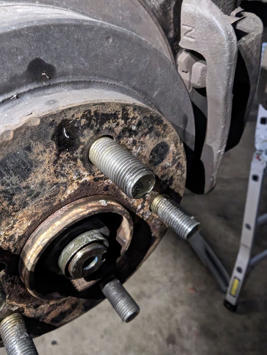

Also pulled the rear wheel off and fixed a stud that was rooted. First two threads were stuffed, so I needed to use a rattle gun to put a wheel nut on. Been like it since the conversion, but ran a die down the thread and hey presto, all fixed! Nut spins freely on the thread again.

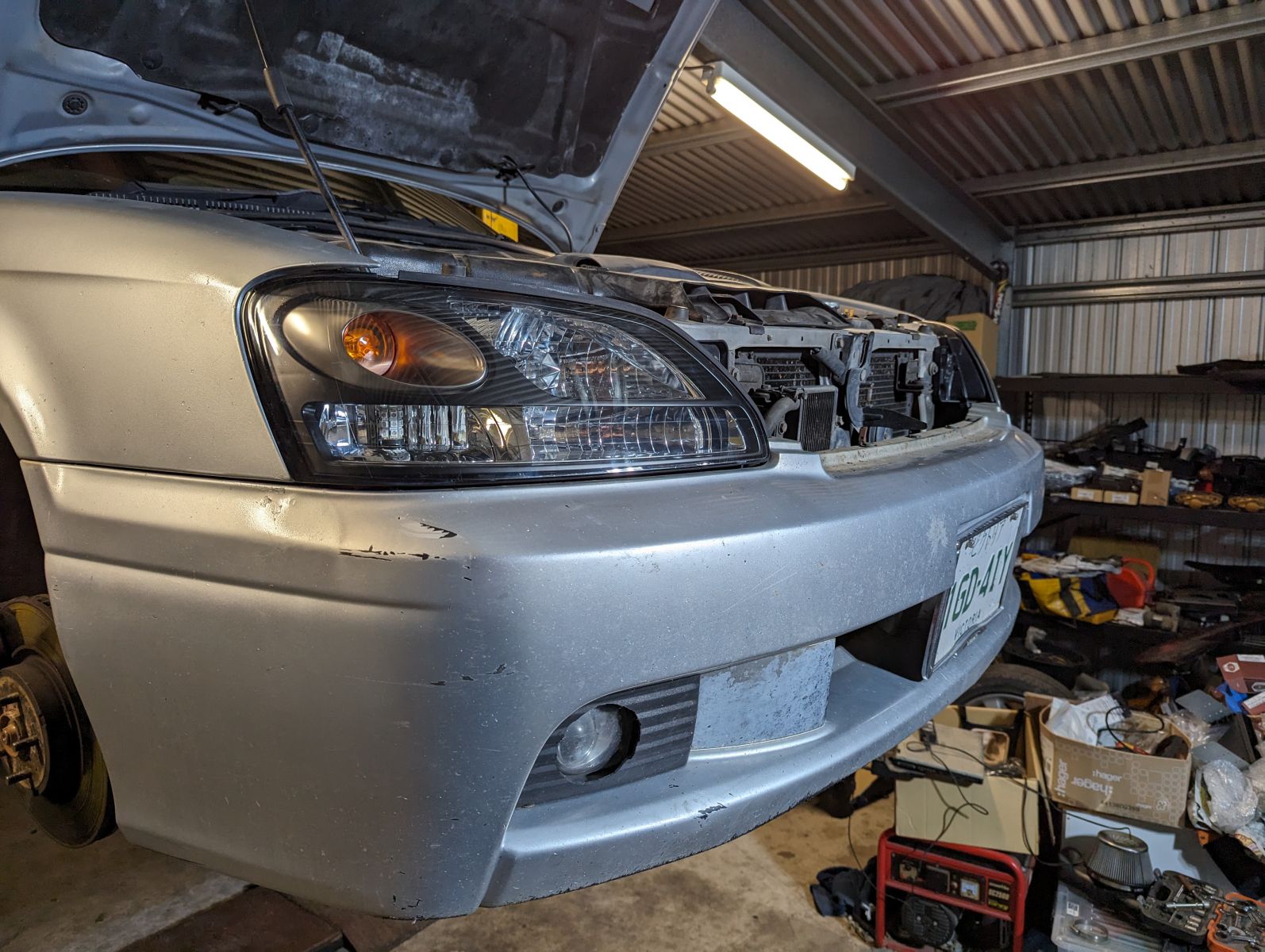

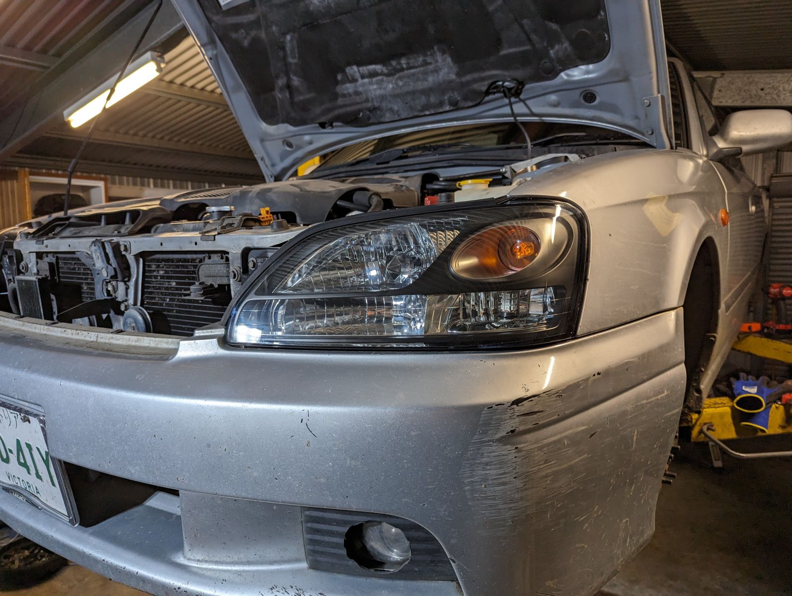

Put a pair of really good condition headlights on as well. Got another pair out of Japan a while ago when I started having issues with one of the ballasts a while back. Figured I'd buy a pair rather than just a single ballast, so I could refurb the current blitzen pair. Prices weren't that much more for the pair.
Swapped the adapted dust covers that I have the Aussie 3 pin plug on over to the new lights and swapped all the LED globes over. Hopefully I get a bit better light output given how faded and shit looking the blitzen ones are.

Holes are all in for the side skirts to be fitted tomorrow, and the S401 front bar got put on as well. While I'm not enamored by the quality of the clear coat, it's not going to matter a whole lot, as being fiberglass, it's going to chip regardless of the clear coat thickness.

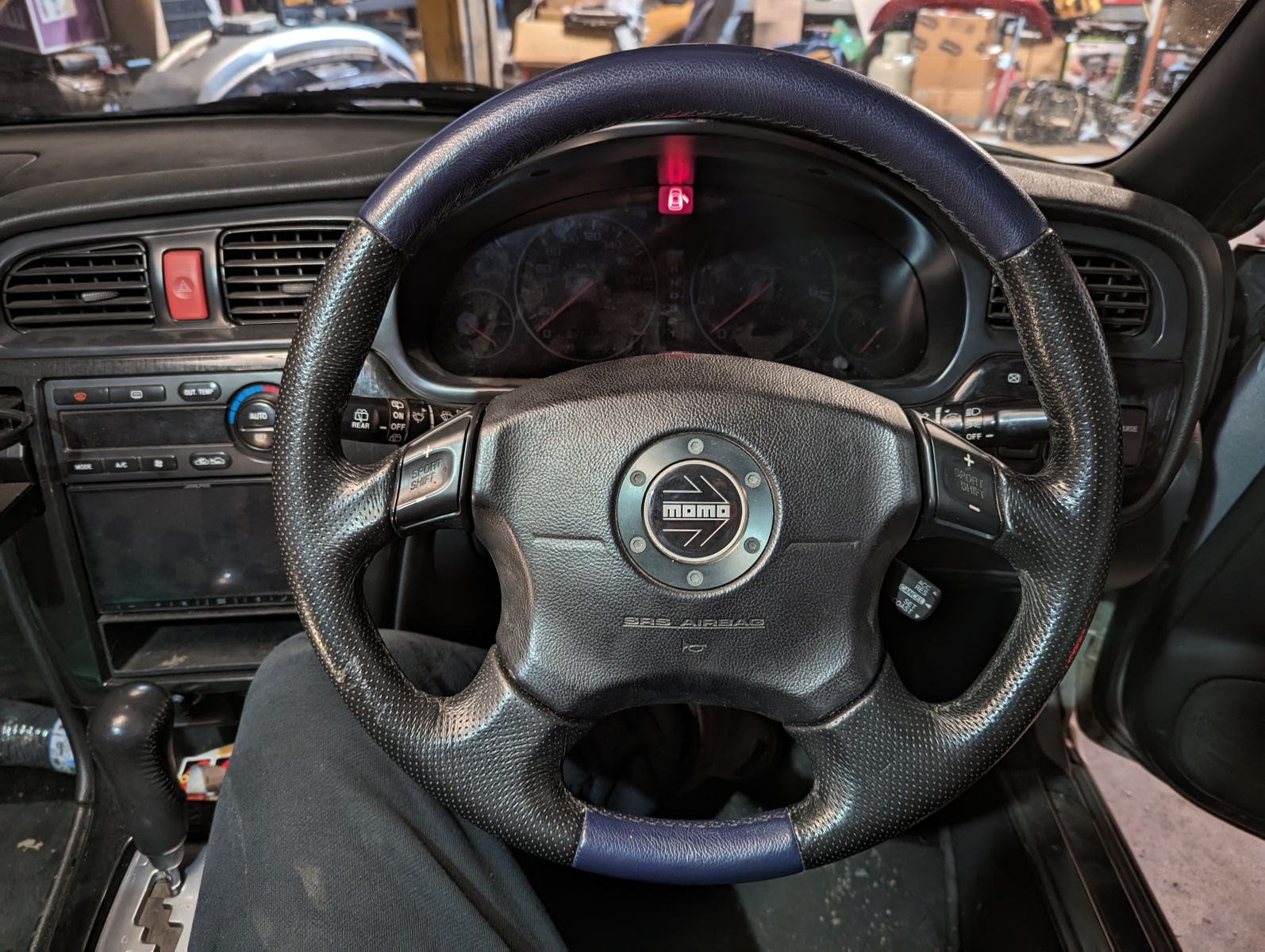

Fitted the new steering wheel last night. No connections for the buttons as yet, as I would prefer to have cruise at this point in time, but that's just a replacement clock spring away to get everything working, which is about 20 bucks through yahoo, so that'll be sorted soonish as well.
Found out today after a drive to work and back that I need to take the airbag off and roll the wheel one spline to the left. It doesn't sit right on the road at the moment. Thought I had it correct last night, but not to be. That'll be sorted out in the coming days, only cos it annoys the crap out of me...
