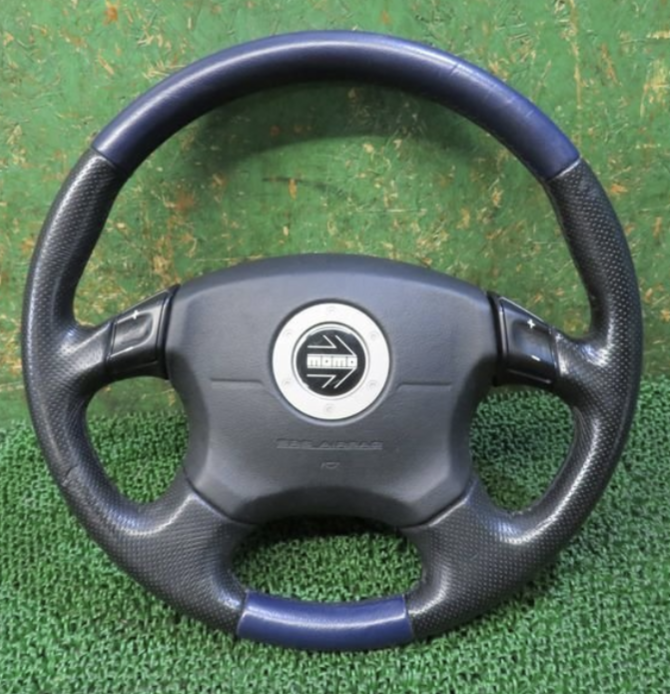

Going on for issues, went to do fat friday with the guys at work, and had a battery light and brake warning light up. Thankfully I have a massive battery in this thing, alternator was stuffed. Managed to pull down a couple of my spare H4 alternators and find the one with the best brushes and transplanted the front bearing spacer and pulley. Not a perfect fit, as the H4 alternator housings are slightly different to the H6 ones. But at least I have a working alternator again.
Also fitted up the legacy number plate surrounds. Looks awesome.
Happened across a blue/black auto steering wheel in reasonable condition on yahoo, much better than the sunlight damaged one I have, plus it has the auto shift buttons, which I'll repurpose for audio controls once I find another clock spring with more cores. It's not perfect, but at least the blue leather isn't faded in any spots.
Photos once I get around to uploading some.
