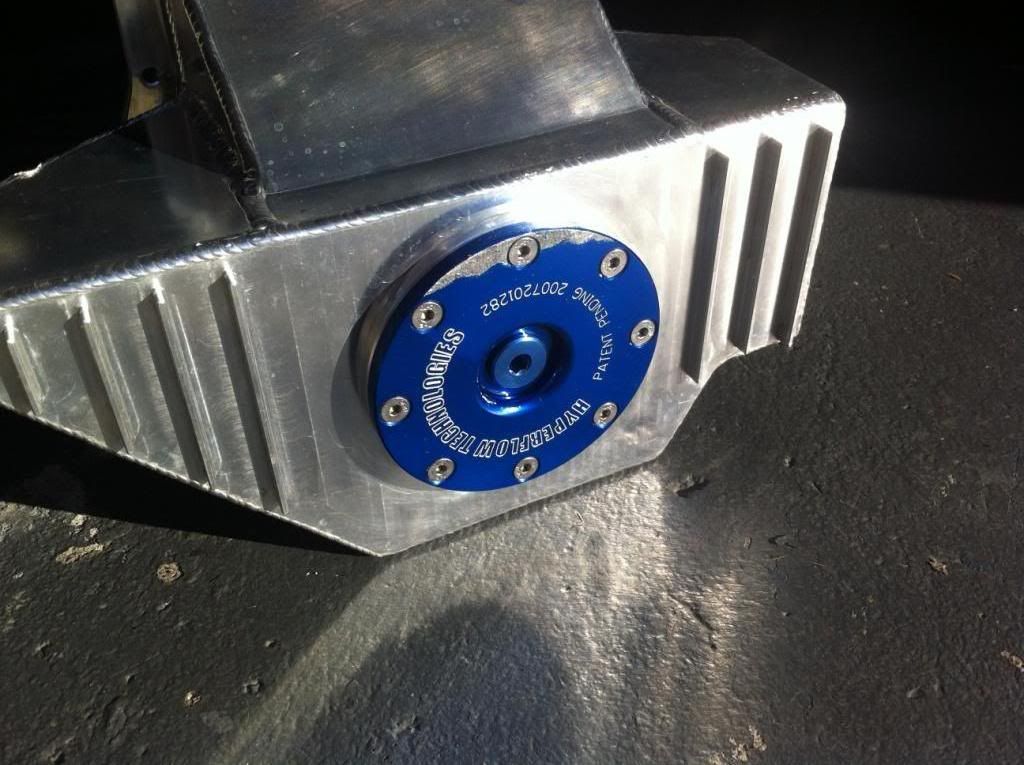

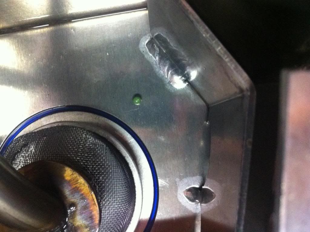

Look what I found im my sump.
Ceramic ball bearing from a Mr Turbo shit core rebuild probably.
As Tony Montana would say:
#168 RX25SE
Posted 07 May 2012 - 10:00 PM
Oooops.
Just the one?
Whats the go with the O ring around the pickup mesh?

Oooops.
Just the one?
Hey Jase, yes just the one.
I will never recommend Mr Turbo to anyone ever. I just don't believe his ceramic bearing packs are up to the job.
It isn't an o-ring, its the anodised base plate.
#170 RX25SE
Posted 07 May 2012 - 11:14 PM
OOOooooh, thats sexy Frank.

#171 CRUISN
Posted 08 May 2012 - 12:07 AM
Looks like a pea.
:P
Yea except that the cars so low its scratched the bottom of the sump getting up on the trailer. It used to look really nice. :mad:
Looks like a pea.
Hahahaha you are so right.
Thats probably what he put in the bearing pack. Peas.
Now they are just mashed peas. I might go and get a pie for lunch now that you have mentioned that. :D
