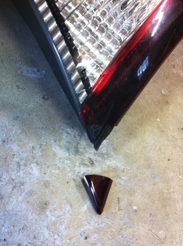

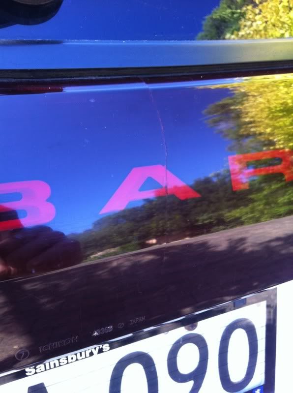

Garnish got a crack in it

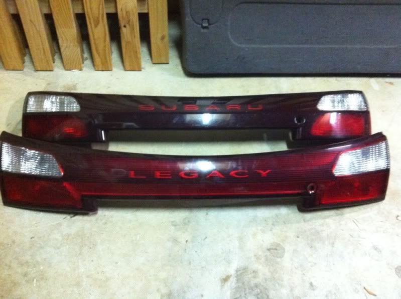

Bought a Legacy one
Chipped it... bugger

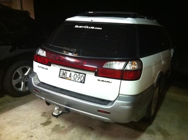

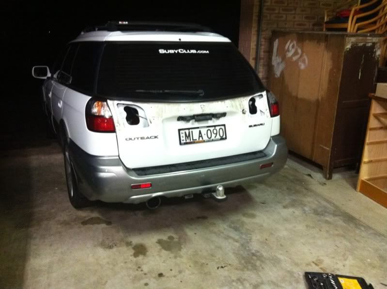

Naked
Swapsies
Fixed

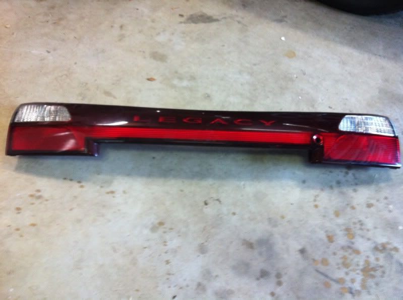

Extra tail lights don't light up though...any clue how?

AUDM dont have extra lights so the plugs have misisng components.
The globes in the Legacy one are dual filament too...

Just going to put it out there.
Why the Legacy garnish?
I could understand if you were driving a Liberty wagon/sedan. But an Outback...
Looks good anyway, but it's now a car with an identity crisis. I'd expect low self esteem and some erratic behaviour for a few weeks, until it decides what it is, Legacy or Outback.
You need to tap into the lighting wiring in the LH QTR panel (where the towbar harness plugs in - take out the jack etc, undo all the clips and screws to take off the trim).
Get a test light (or mutli-metre if your a fancy pants French man) and find the stop and tail light wires.
Solder one wire on each of them (mark them or use different colours so you don't forget) and run them up the QTR panel and thru the rubber tube/boot jigger into the tailgate.
Run it down the tail gate and across to where the globe is on the LH side of the garnish and join the wires upto the O.E JDM harness (which should already be earthed from factory), piggyback it across to the RH side.
Just jerry rig it and press the brakes, or turn on the parkers to see if they work.
Can't remember what colours etc etc.
EDIT - this might explain (he used the RH side thou, and not very detailed) - http://www.ausubaru....ead.php?t=14967
