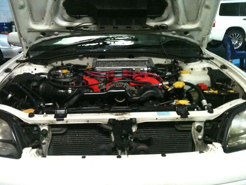

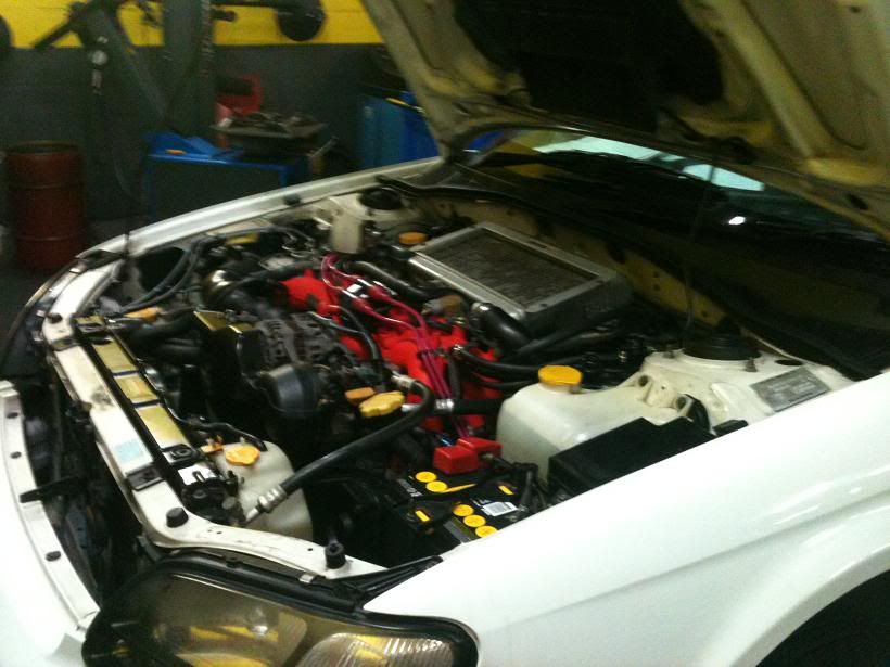

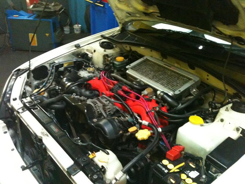

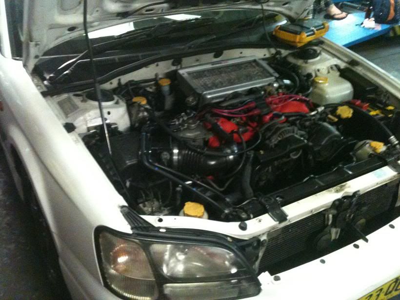

Gents,
Left to do
- Get exhaust sorted out
- Registration (Ran out 5 days ago)
- Suss out Check Engine Light and ABS light
- Speed Sensor for gearbox
- Paint woeful interior woodgrain matte black
- Put Nardi Steering wheel on (Not sure if i'll do this yet, because it doesn't have an airbag)
So some pictures are in order...
Completed product (Almost)
Shazza

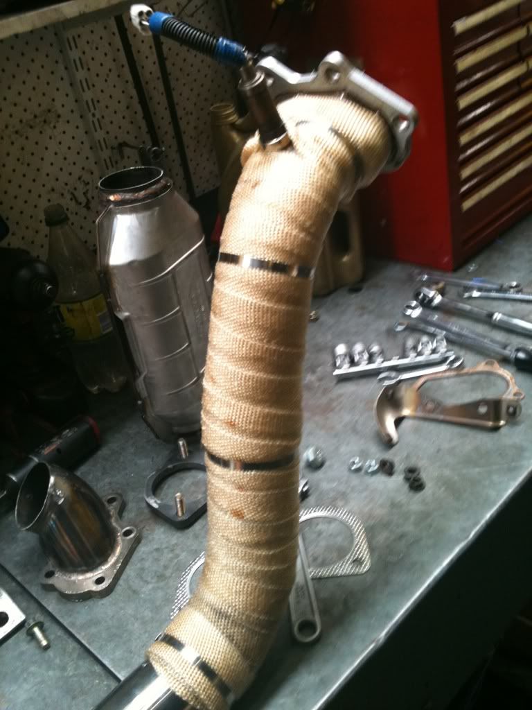

Got the dump pipe to fit too.
Shazza
#299 Adam
Posted 27 March 2011 - 06:43 PM
Shazza! That heat wrap looks tops! Reminds me I need to do mine!!!
#300 Shaz
Posted 27 March 2011 - 06:46 PM
Cheers man,
Yeah, not a huge fan of a melted brake booster/clutch cylinder.
