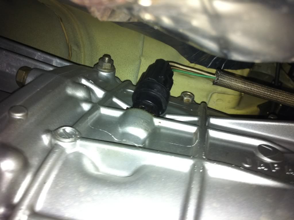

Speed sensor plz.
MY99-00 WRX 5 speed box.
Shazza

Speed sensor plz.
Shazza
cant you just use your old speed sensor? Al would have wired it to suit you old sensor
#256 Shaz
Posted 24 March 2011 - 05:02 PM
Nah, the gearbox has a cable speedo, which doesn't mate to the harness. And I can't use the one off the auto box I don't think.
We've been speaking to Al, and he's said to get an electronic sensor, that screws into the side of the box?
In other news, all the power windows, sunroof and bits and pieces work. Fuel pump is still not working,
When we plug the Subaru scanner into the car, it doesn't communicate with the body, or the engine. In the passenger side kick panel, there is a brownish relay that isn't clicking, which is apparently a major power relay. Were going to pull the dash back out again tomorrow night and re check all the plugs and ****, and see what has power and what doesn't.
Big props to Al from AMAuto for helping us over the phone. You've been a great help mate.
Hopefully have it all up and running this weekend. Fingers crossed. Anyone on here an auto electrician?
Shazza

#259 Shaz
Posted 24 March 2011 - 06:04 PM
This is what I need.
#260 Start
Start
  • 536 posts
Posted 24 March 2011 - 06:28 PM
Hey mate, there is also 2 & 3 wire speed sensors. (might wanna double check before you buy)
2 wire signal goes to the speedo cluster in waveform and is converted to digital for the ecu.
3 Wire is a digital signal direct from the sender and is shared by the ecu and speedo.
Also be super careful putting them in, there made of plastic for some reason and tend to SNAP! when u put a spanner to them.. biggest headache to get out once that happens trust me :dash2: .
