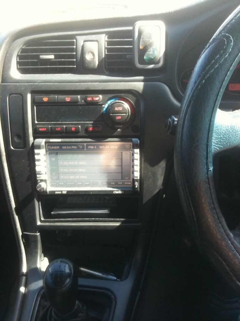

Thanks guys I had a bit more of a look and found what all the wires do...
I read somewhere that I may need to put a switch in for the light green handbrake wire, and that it may not just work when connected to a ground wire...
That'd be great if you could put the install manual up chris. Thanks :)

Here u go...
I wired the grass green(hand brake) with the black (ground) and it worked for me

Yeah I tried that but the writing still came up.

Apparently I have to put a switch in between the green wire and the ground...
Also. Would the brown wire be the reverse wire?
I have no idea then dude, worked for me...
U dont need to wire up the reverse wire unless ur gonna put a reversing cam in...

I read that the earlier models you could just hook it to a ground, but newer ones you have to put a switch in and click the switch on and off or off then on to work. I'll have a look and see if this works.
And the bloke I bought it off just rang me and also told me this.. Haha thanks for your help and cheers for the wiring diagram chris. Cheers

I got the DVD player to work with a switch, so you can watch DVD at anytime.
