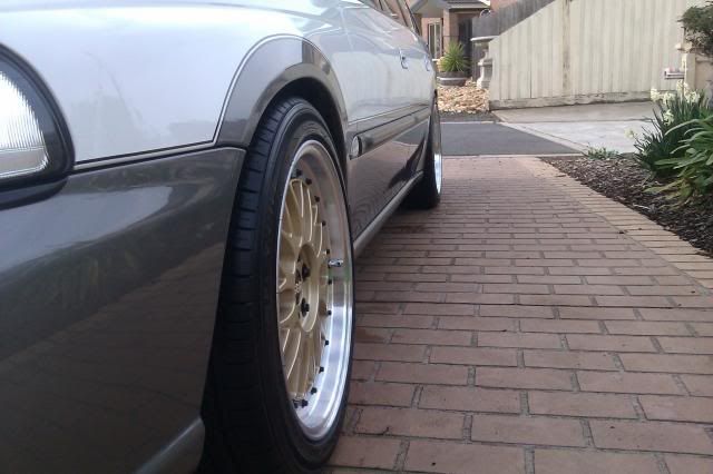

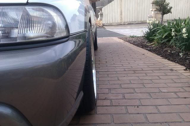

Another set of temporary rims. Didnt clear the 4 pots so had to put a set of GTB brakes on the front..... and didnt clear the rear 2 pots either! Needed 1.5mm clearance so put a 3mm spacer in there til the LM's arrive.

BBS LM's on. Reversed centres put the specs at 7.5 +32. Fills the arches very nicely at current height with zero rubbing. Will drop a little lower.
Custom brakes completed. Nissan R34 GTS-T front alloy calipers with adapters running Subaru 316mm rotors and STi  Brembo rears. All to be fitted this weekend. :D

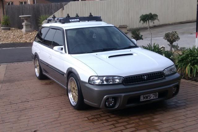

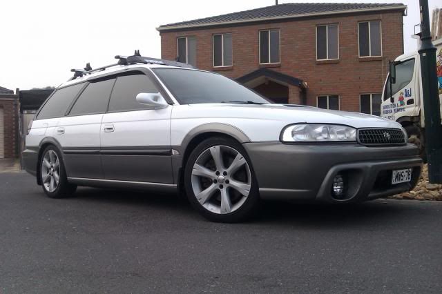

#733 CRUISN
Posted 25 July 2013 - 03:19 PM
A few pics...
#734 Adam
Posted 25 July 2013 - 03:39 PM
Words.
#735 Samwise
Posted 25 July 2013 - 03:43 PM
Hnnnnggggg...
#736 Harry88
Posted 25 July 2013 - 04:13 PM
Looks pretty hot.
#737 Morgan
Posted 25 July 2013 - 04:41 PM
Looks alright, aye.
#738 Liberty
Posted 25 July 2013 - 05:05 PM
Now that is hot. Good work Mark!
