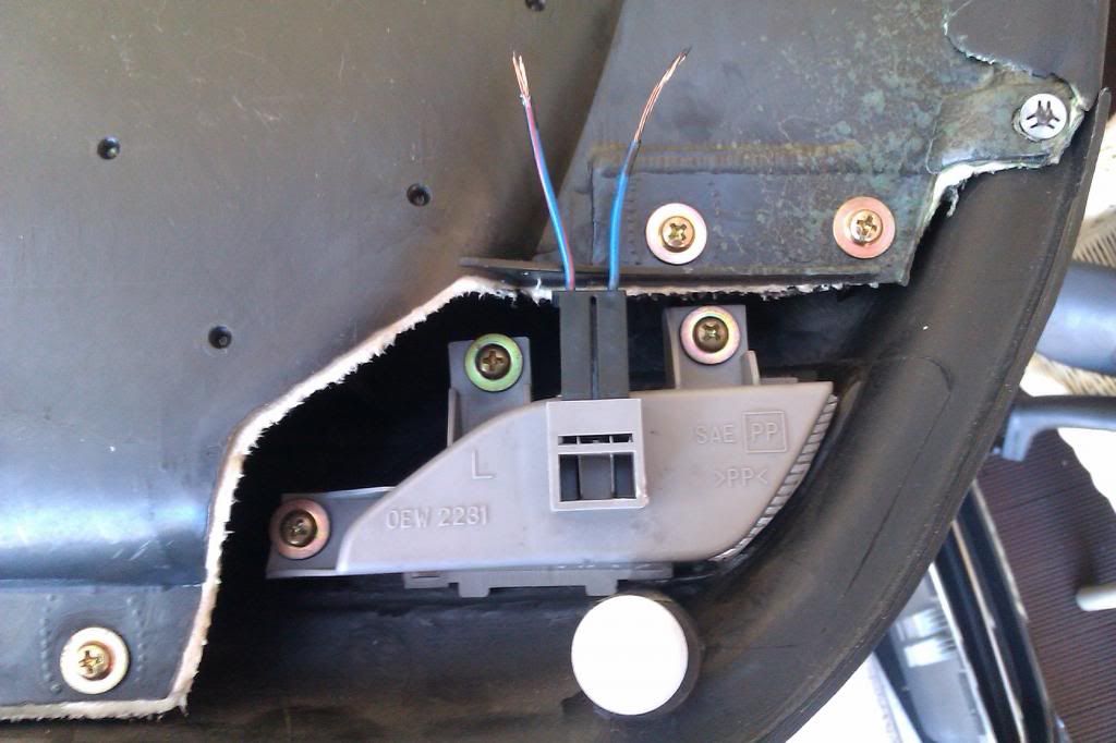

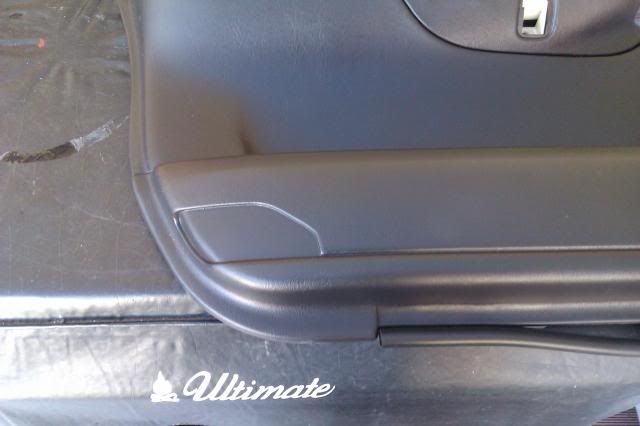

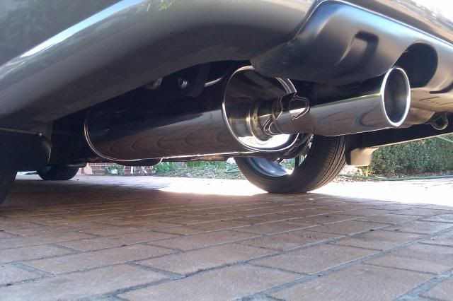

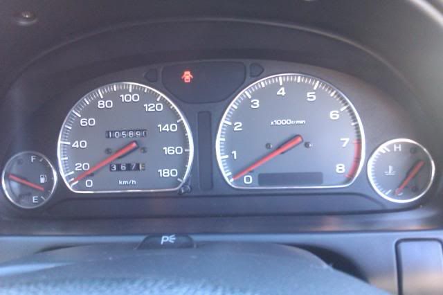

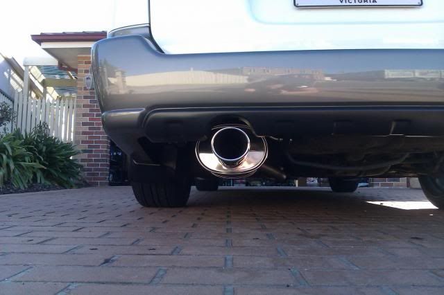

A few more little additions making it more JDM spec...
Fujitsubo NA muffler. Smaller and quieter than the Ganador turbo muffler.
JDM speedo and tacho. 180km/7000rpm redline vs AUDM 220km/6500rpm redline. Just little things. I couldnt fit the whole cluster as theres a few wiring differences with the symbols around the cluster.
Retrofit JDM puddle lamps into my door trims.
Before...
After...

Where did you splice them in to? Ive been thinking about getting the JDM B4 front door cards that have the puddle lamps.
#714 CRUISN
Posted 22 June 2013 - 03:51 PM
Havent got that far yet, thats next weeks job. :D
It'll be easy to wire in though. Just need a constant +12V and take the ground from the switched side of the door switch.

That is one shiny muffler!

Looking good Mark as usual! Especially the shiny new muffler.

Shiny muffler is quiet...... too quiet after I had gotten used to the turbo muffler. Going to get my mate to redo the centre section from scratch this week. Mandrel bent with a slightly larger centre muffler and refit the Ganador. The larger centre muffler should take the edge of the sound.
Sell Fujitsubo.
