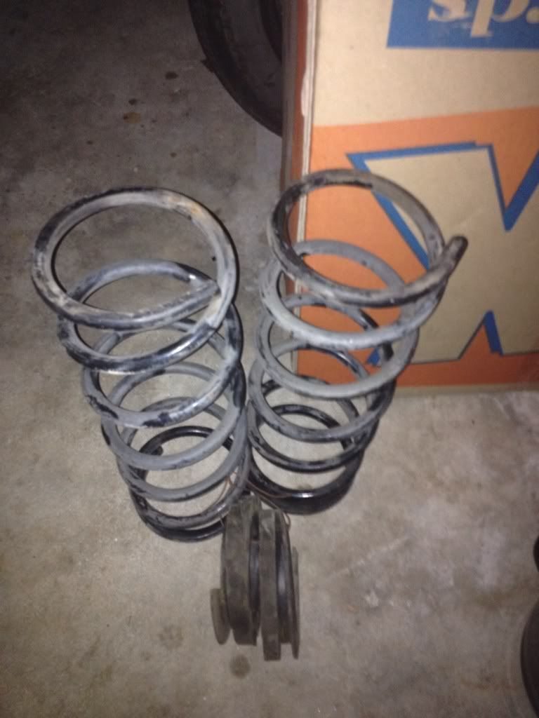

Posted 21 March 2012 - 07:28 PM
Also, forgot to add, got my rear AU springs today.
