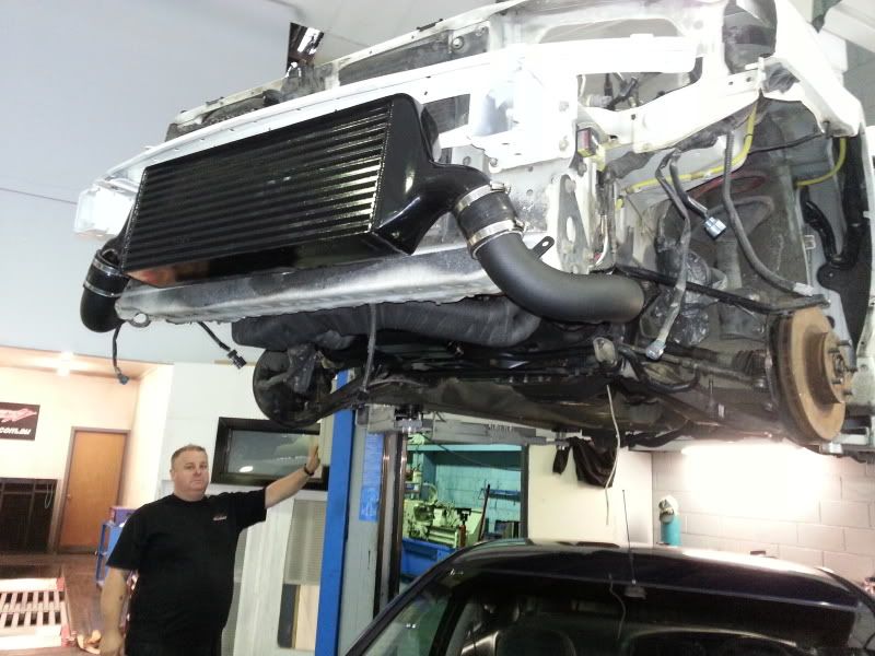

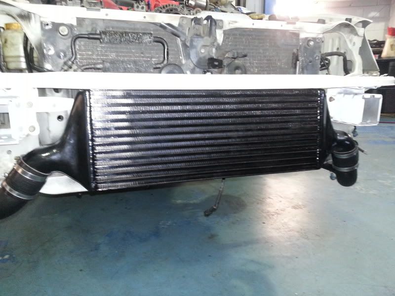

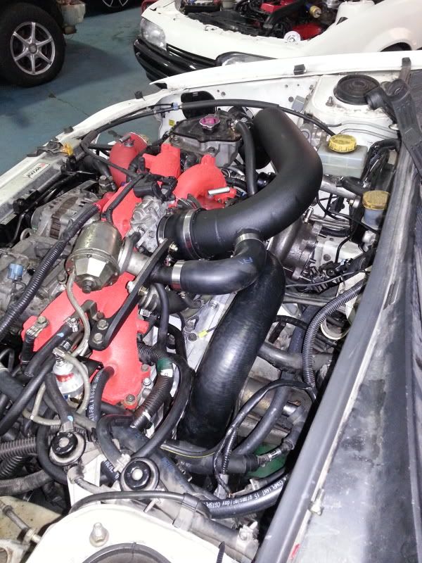

nice mate. i'm seeing a lot more cars running their FMIC piping in "reverse" direction with hot side on the passenger side instead or rotating the exhaust housing. are you going in guard filter? i wonder if there's any intake temp difference running the cooler pipes that way

Posted Image'ing stoked !!
I hadnt even noticed which way the pipes where running Aek.. But yup looks correct from what your saying..
I think they are going to run a filter in the engine bay..

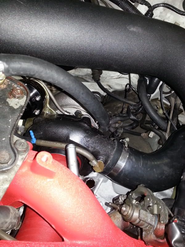

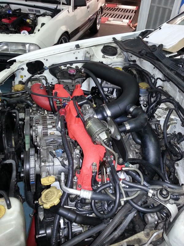

Can i ask why you are using a atmospheric bov?

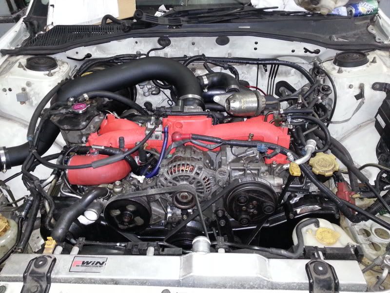

WHY THE HELL ARE YOU NOT TWIST MOUNTING IT AND GETTING RID OF THE UNDER MANIFOLD INTAKE?!?!?!?!?! So much restriction!!!!!!!!!!!!

Cam I had the bov lieing around from the cut, should I replace it ?
.. jrod.. that question is a little over my head. . Are you talking about the pipes being routed in reverse as mentioned above ?

JRod is saying instead of having the turbo north-south like the engine, you twist it on the pipework to have it pointed out sideways, enabling a larger and straighter intake pipe, rather than the intake that goes underneath the intake manifold.
#679 Tim.
Tim.
  • 2,024 posts
Posted 27 March 2013 - 09:23 AM
i.e. that red silicone pipe which supplies air to the turbo.

Oh ok.. Do you have to change any of the piping thats there ? Except the intake pipe ?
