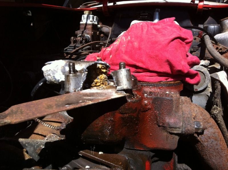

Oh and we've also ordered parts to start work this weekend. It's all been cleaned of all the dust, rat poop, grime and slime that it's been accumulating for the last 27 years.
Aftermarket airhorns have been removed
Radiator has been tested and has no leaks
Thermostat has disintegrated and the housing crumbled into my hand!

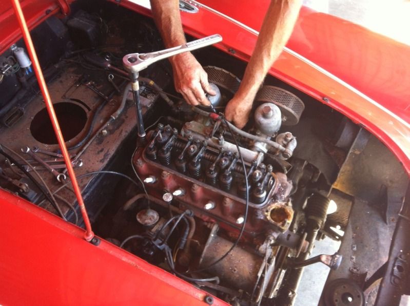

Will pull the radiator out on Thursday to manually crank the engine to check for bent pistons, sticky lifters, etc.

If engine has sat for 27 years, I would pull it down & check it out first.
Fair chance of rust in the bores or gummed up rings/broken rings.
If you have broken rings, lots of damage will be done !!
Have ya done a comp test yet ???

I would pull the plugs, Squirt some wd40 into the bore, Let it sit over night and carefully turn the engine with a large breaker bar.
I would do this before even thinking about starting it!

Yeah we're manually turning the engine before starting for sure!

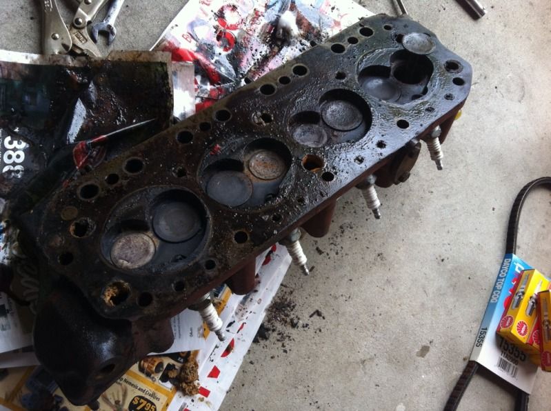

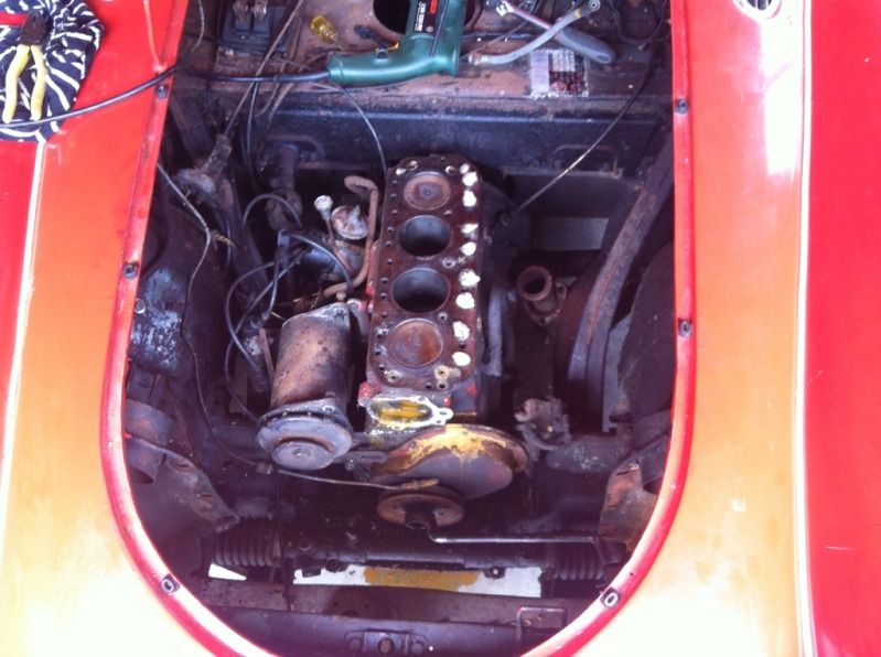

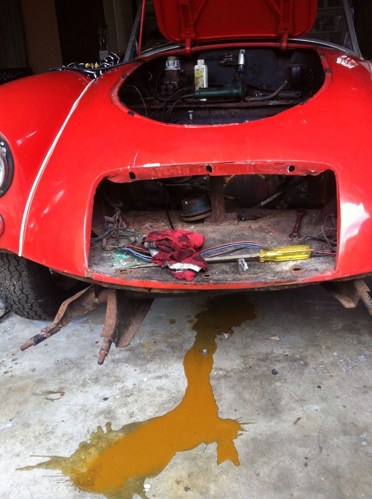

My father in law came around today and helped us do a fair bit of work today. He's restored/built numerous Austin Healey Sprites and Mini's etc so it was all second nature to him!
Took the rocker cover off to examine the innards. After 27 years, only one valve was stuck open! Not bad :P We tried to manually crank it but nothing would budge so there was no option apart from pulling the head off.
There was heaps of corrosion and rust in the bores so no wonder it wouldn't move! After some sanding back, it was looking fresh and the pistons were in motion. The valve is still stuck open though on the head so that will be stripped down and rebuilt by a pro in the next few weeks.

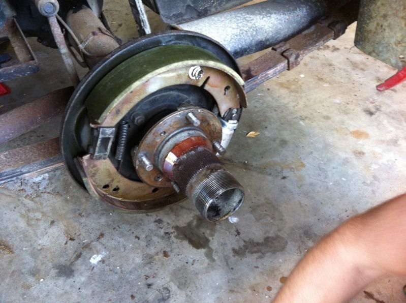

We also pulled apart the rear drum brakes and replaced the cylinders. The old ones didn't look too bad but when it comes to braking, you don't want to wig out! Along with that, we installed new brake and clutch master cylinder kits/seals/springs/fluids. The clutch seems to be working now but having troubles with the brakes... There's no spring back on the pedal and nothing came out when we bled the system. There may be some sort of blockage somewhere but we ran out of time for today.
Thermostat housing and thermostat were taken off. My goodness that thing was fused on! The aluminum had corroded so bad that the housing just crumbled in our hands! So much gunk in the system too - will flush that out real good when the head goes back on.

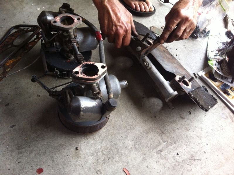

One carby seems to be ok and the other gets a little stuck. Hopefully with a little adjustments it'll be apples. Need new filters though.
Other things to note. Water pump spins freely, radiator holds fluid and rad hoses are in top nick. The fan belt was able to be removed but stayed in the same shape :P Got a new one of them! Also bought a new head gasket, manifold gasket and carby gaskets. After today though, the shopping list has grown even more!

Munted thermo housing!
Starting to take of the head
The head
Headless

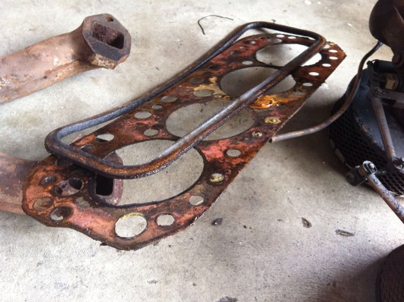

Old head gasket and rockers cover gasket
MG diarrhea
Carbys
Rear drums. Never seen one of these before!

If you havent already might be a good idea to strip the carbys and clean them :) old fuel sits in them and fucks shit up :(
#59 Morgan
Posted 09 February 2013 - 10:42 PM
They're off the car and it's on the agenda ;)
