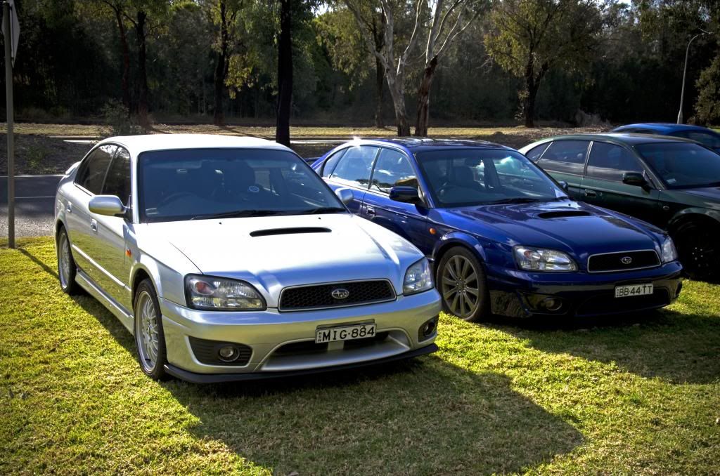

Posted 19 August 2013 - 04:32 PM
Hey boss.. nice to meet you last weekend.. :P
Just did some quick photoshopping...man that sunlight in the west sucked...
#227 Beckers
Beckers
    OMAR Cubt
  • 3,061 posts
Posted 21 August 2013 - 12:03 AM
That silver B4 looks sweet as.
Such a shame about that blue thing next to it, Ha ha.

I haz one liek that. It runs again too. I think yours sits about the same height as mine does on STi pinks. You need tints aesthetically more than anything I reckon.

Thanks for the awesome pics MiGoreng... makes my car look so much better than it does in reality... LOL!
Yeah dude, the silver car is nice... that blue thing is just in its shadow... ;)
Thanks TSG, yeah I think mine sit on Kings, I like the ride height... down have to go too slow over speedbumps, never have to do that sideways thing, so I'm happy with it... and yeah, tints are on the list of things I need to do... would make it so much better... and thanks for the boost gauge advice... 3m tape hey? I'll try that... mine is a mechanical gauge, so thats going to be fun when I try to install it. I think the pod for it has a bit of weight to it, but we'll see how I go... thanks again :)
