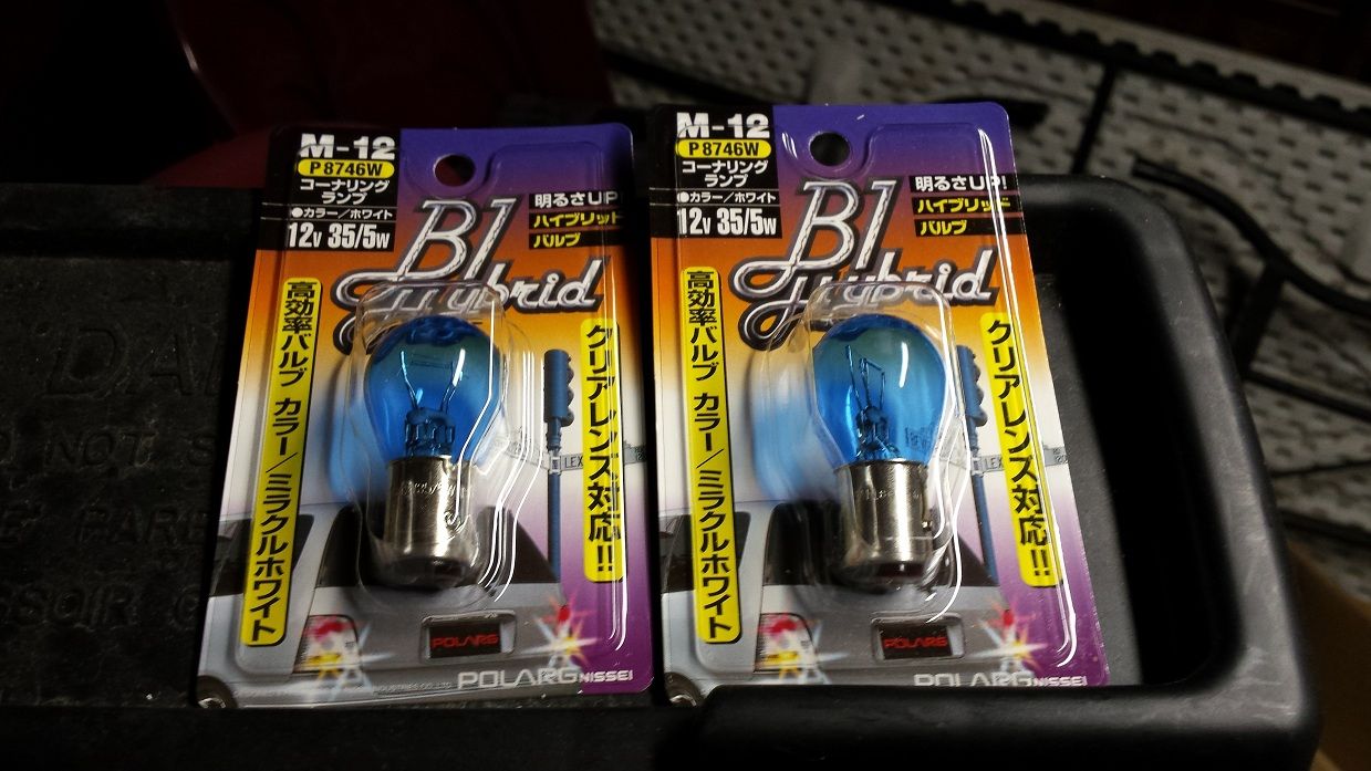

Finally, these (expensive) suckers showed up!
As discussed earlier, the JDM unit uses a 5/35w dual filament globe in place of a traditional T10 wedge globe. At 5w it acts as a parker light in normal operation. When the indicator is used, the respective globe will light up the 35w filament and spread the light into the corner your driving into.
Now, these globes aren't available in Australia (some ADR jibber jabber most likely) and the closest you can get is a 5/25w brake globe which is all brown and ugly.
After trawling the internet for a suitable replacement for the 5/35w globe, I came across a couple of brands an eBay seller in the USA had (Raybrig-Stanley and Polarg) .Some money was exchanged and parcels sent.
Here are the results!

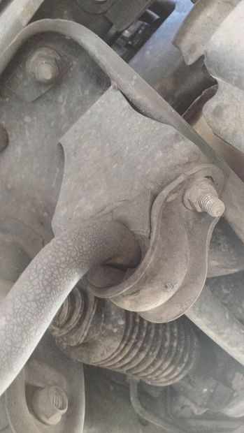

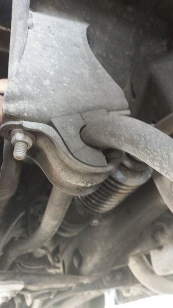

While giving the engine some fresh Penrite juice, had a peek under and checked out where all the groaning and moaning was coming from....
Best place an order for some Febest goodies ....
#300 Guest_KONG_*
Posted 29 September 2015 - 01:35 PM
Mashed AF!
